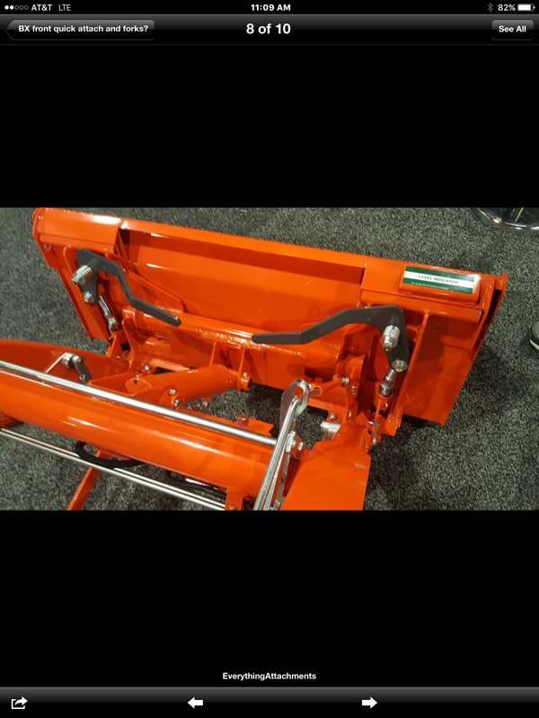

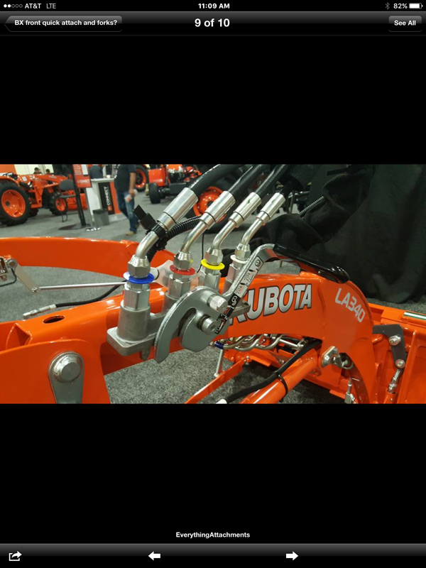

The loader has changed from an LA243 to an LA340 or LA344. If this is the usual KG capacity, that is a major loader lift upgrade. See photo below.
Bruce
Kubota has recently changed the way they rate Loaders. The good more realistic old way was either lift at bucket center or 500mm forward of Pins.
The way Kubota rates loaders now is to rate at the pins like most everyone else does. (Does not make it right.)
