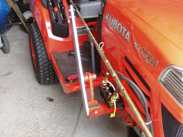

With that in mind one last markup (I'm sure the engineers at kubota monitor our forums :D)
Huck,
For those who don't want to spend the money for the hydraulic rotation system, you could buy some steel, do a little welding, and sell them yourself! I think a couple of TBN'ers have found a need, created a solution and built a business around their product. I am in agreement with everyone else that Kubota should have come up with something better than what they did for you. I'm anxious to see the hydraulic project reports in a couple of weeks. I got out of the car this afternoon and it was spitting snow, so we are getting closer all the time. Dyer, retired

I'm waiting on parts from Northern Tool and Surplus Supply to start implementation of your setup. But you got me thinking about a better setup for the manual chute system. I stopped at Lowe's and picked up some 3/4" pvc pipe and connectors. See attached photo. This works as good as the Kubota setup -- actually better in that it puts no strain on the hydraulic control lever. The long piece of PVC flexes so I have to use 2 hands to rotate -- but if I replaced that section with a 3/4" piece of hardwood I'm guessing it would completely solve the issue. Cost? 6 bucks (and not a hole drilled in my new tractor.)
If it were done in steel with a couple of pins for disconnecting it would be a quality solution. I'm surprised Kubota settled for something so poorly designed as their existing setup.
I designed a similar device back when I got the bx1850 only mine was all steel.
