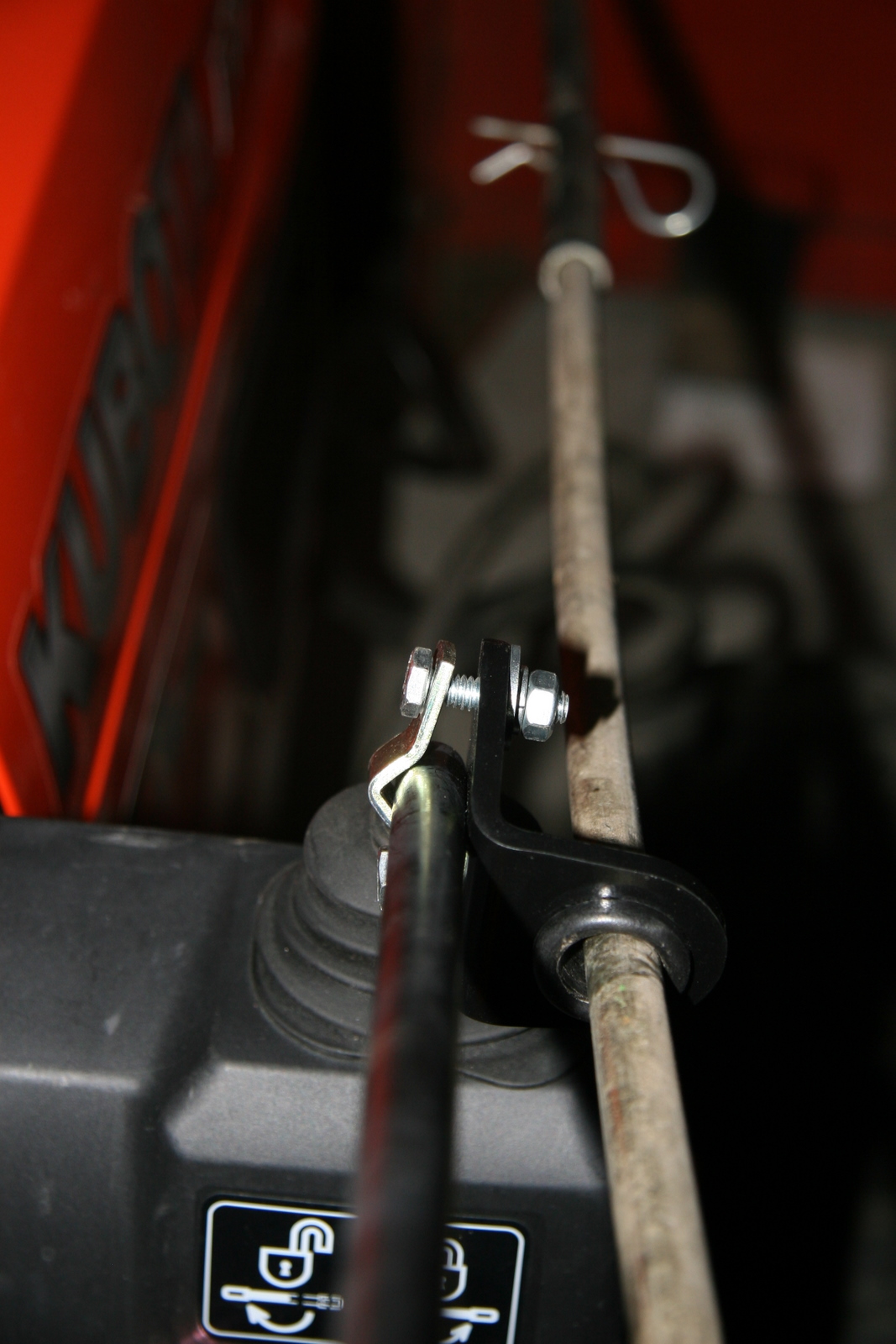

I recently traded in my 2000 BX2200 for a BX2660. The dealer said I'd be able to use the blower (a BX2750) and quick hitch with the new tractor after a few modifications.
I'm not satisfied with the modification that was done to accomodate the manual chute rotation. A bracket was clamped to the hydraulic control lever to hold the chute rotator rod. (See photo) I've tried using it and as I turn the rod I ram the hydraulic control lever left and right. And the blower sits further in front of the tractor now, so the two piece rod for the chute rotation is extended further and it flexes as you attempt to rotate it. The flex combined with the lever moving back and forth means you cannot completely turn it unless you stabilize the rod with your left hand and turn the handle with your right.
I'm told that is now the standard hookup now for the BX2660. I'd love to hear from anyone else using this setup. I was quoted $350 to go electric rotation and $750 for hydraulic rotation. I'd appreciate any feedback on these options as well.

I would be unhappy too with the handle modification they did as shown in your picture. I can see why it's not performing the way it should for you and suspect that when the ice builds up at the chute and there is some resistance to turning, it will really become a problem for you. I wouldn't be very pleased with the dealer that came up with that design and can't imagine that Kubota would be recommending that as a solution?

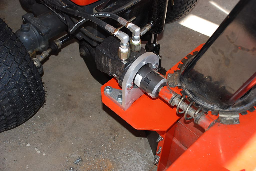

The bracket on my tractor for the manual chute rod bolted to the control lever housing and was solid as a rock. I hope you can see the bracket in the picture and where it bolts up? I still have that bracket and will be happy to send that to you if it looks like you can use it. Is your control arm housing plastic or steel? That pivot point does need to be solidly attached, for the reasons you're seeing from the movable mount you currently have.
I recommend the hydraulic chute rotation and you can do it yourself for closer to $250.00 total. I bought a new hydraulic motor from Northern Tool, but there are plenty of hydraulic motors for sale on e-bay for much cheaper. The motor was the most expensive part of my build and the only other piece of the build that I couldn't do without help was welding up the support platform and brace. I designed it and a friend helped me with the welding. I came up with the mounting method, but there are a few threads that offer up different methods to do the same thing. I used the existing worm gear on the chute and used two half couplings to connect the motor to the worm gear. My dealer wanted $650.00 for a hydraulic system, so I saved a pile of money. Turning by hand wasn't bad, just slower than I wanted for when the big snows hit and the wind is pounding through...I think the hydraulic rotation will be a better experience. Dyer, retired
That's how the mount was on my BX2200. I used it for 8 years without a problem. But there is no structure to attach that bracket to on the BX2660.
The dealer says that how mine is set is standard now for how they mount the snowblower chute rotation rods on the later BX's (since the design with the hydraulic control levers that stay with the tractor when you disconnect the FEL.)
I agree with you that snow and ice buildup is going to make it a bear to turn (it's a bear to turn without any snow and ice). Also, I'm afraid I'll be damaging the hydraulics from ramming the hydraulic control lever all over while trying to turn the chute.

I do have it tied into the control lever that raises and lowers the blower. I push the lever to the right and the chute turns right. I've read some posts about the stick being pushed to the right to get past the detent and then there is no control over the speed of the rotation, but mine doesn't hit the detent until it's nearly all the way to the right....so, I can turn the chute right or left as fast or slow as I want by just feathering the control lever. You'll like the function of the system and being able to do everything from one stick. Good luck. Dyer, retired

Nice looking work on your hydroulic Mod.
/ BX2750 snowblower #36
Dyer
Thanks! I had fun doing it and a friend gave me my first lesson in welding while doing it. It ended up, with new White motor, costing about $225.00, so it was substantially lower that what the dealer was asking. Dyer, retired

I've got a guy to help me do the hydraulic chute rotation. I just need to get the motor and mount. Any chance you've got part numbers on the ones you picked up at Northern Tool? I was trying to compare the pic of your stuff with the stuff on their website but wanted to make sure I got it right. Thanks.
/ BX2750 snowblower #40
Dyer,
Huck,
I deal a lot with Northern Tool and Surplus Center. As I looked through my stuff, I found that I mis-spoke....the motor actually came from Surplus Center. I picked up a 3.2 cu in White Hydraulic Motor - Part #9-7563. That was $119.00 new, but you can find all sorts of motors on e-bay for much cheaper. I didn't realize until I had ordered it that the threads were BSPP, so I had to get some adapters and that's what caused the hoses to feed a little high off the motor, as you can see in the picture. It doesn't hurt anything, I would have just preferred it to be a little more streamlined. The 2 bolt pump mount I used came from Surplus Center also and is part #933. That cost $34.00 dollars and shipping for the motor and mount came to about $25.00.
After I unhooked the handcrank shaft from the universal joint near the chute, I was left with the 3/4 inch shaft and worm gear. I ordered the heavy duty half coupling from Northern Tool for the shaft - Part #3014, the half coupling for the motor - Part #3017, and the heavy duty half coupling insert that goes between the two - Part #3022. Total cost with shipping was $67.53. I also got the hydraulic hoses from Northern Tool, but found that I could have had the hoses made up locally at a Brake Supply for less money and no shipping....I'd recommend that.
I had some steel plate to work with and some other fittings that I didn't include in my cost, nor can you ever count your labor. All that considered, you will still save a pile of money doing it yourself over what the dealer cost would be. Have fun and post pictures as you go. John
