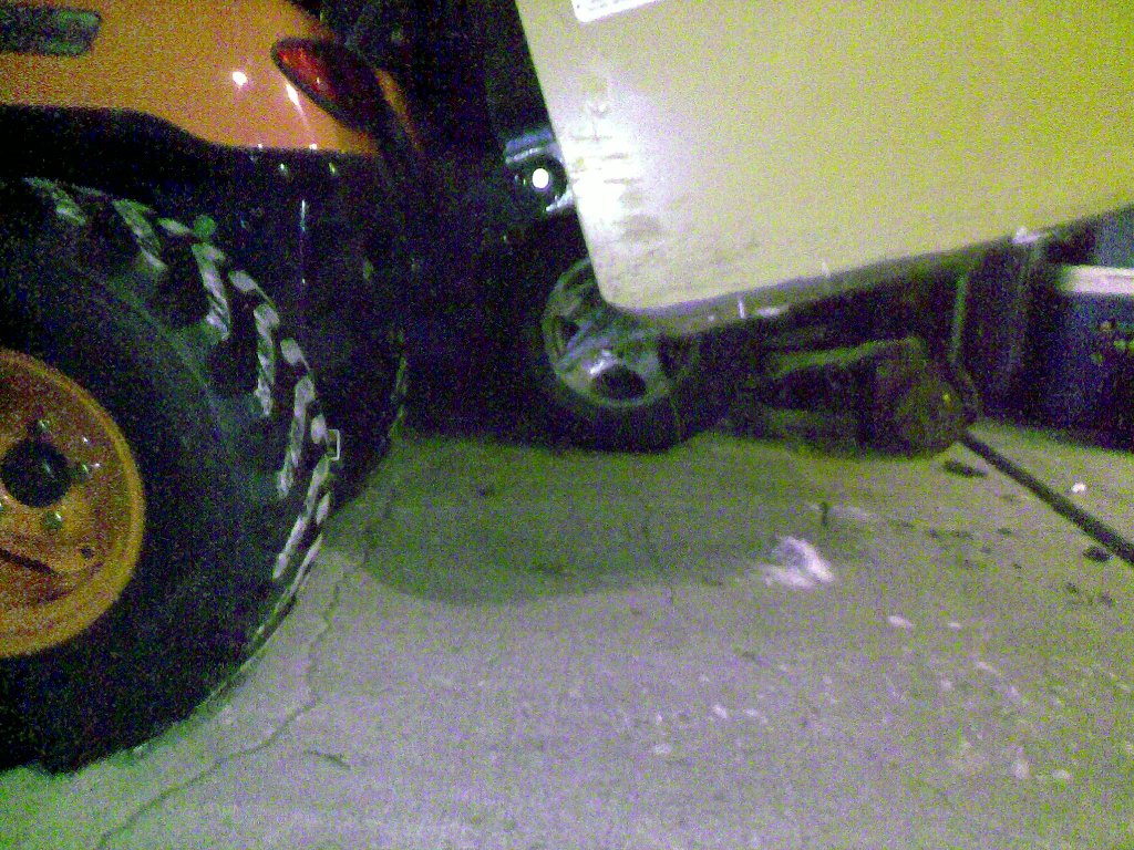

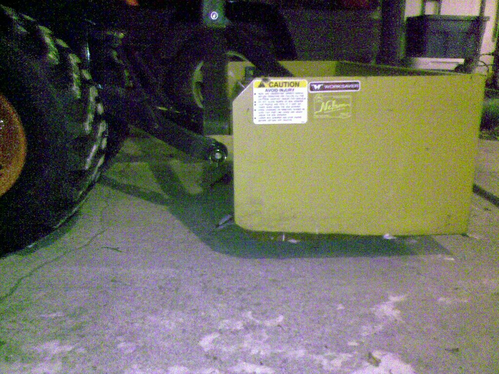

I just bought a BX2660 on Tuesday and decided to hook up my 48" box blade today (Worksaver SBX-4)... It was a pain to get on, mostly because I had to lift the box blade up to get it into the holes. I figured the 3-point would lower more once I got the box blade attached, but it didn't - even with me standing on it in addition to the weight of the BB. In the lowest position, the eyes are 10" off the ground and my box blade is still 4" off the ground. In the highest position the eyes are 26" off the ground, which seems excessive. Is there something wrong with my 3-point?

It could be any number of things including 1) MMM height dial not set at zero 2) Are there 2 setting holes in the lower arms? You could be in the set that doesn't allow it to drop as far 3) top link needs adjustment or 4) I believe there is a mechanical adjustment to control how far they can be lowered. Somebody else might have a better answer for you if none of this helps.

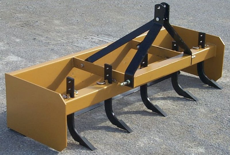

Hmm, I wonder if there isn't something wrong with my box blade...
Note that the difference between the SBX-4 (3-shank) vs the SBX-5 (5-shank) - I wonder if I can have the dealer will let me trade my box blade in for a proper fitting one...

I would try to trade it - the other blade looks much better. I agree with the other post - usually the problem with the BX is the implement might not go high enough. When I first bought my rear blade I had the top link too long and the thing was only a few inches off the ground.

I just posted the same thing on my BX1850, I suspect that even though the BB are rated as Cat 1 they are made with the mounting pins to high. Mine the eyelets are around 10 - 10 1/2" high fully lowered also.

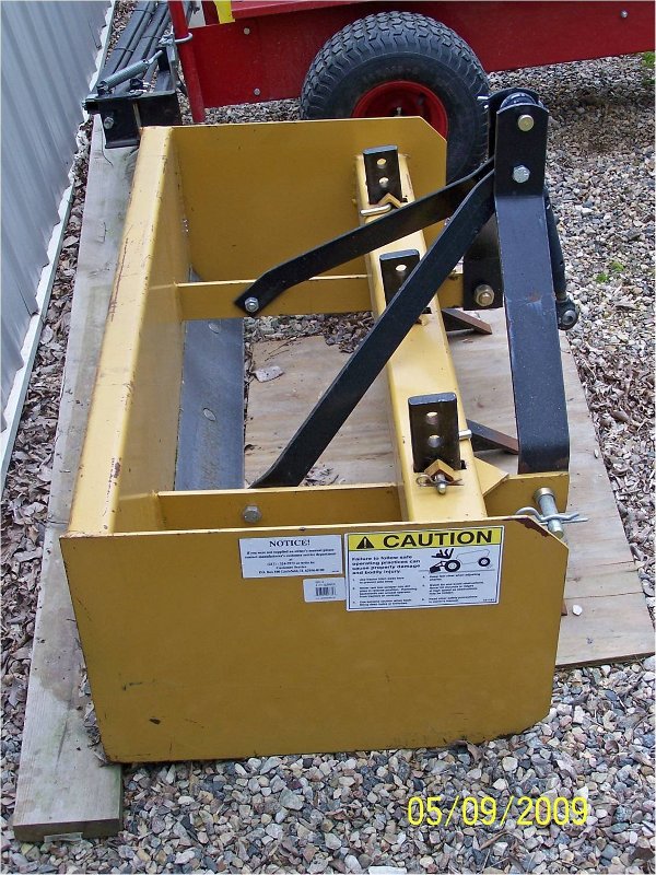

Although it is painted Red, it is a four foot Worksaver.
The flat bar is attached to the top of the HSS cross tube.
I'm using it on a GC 2610 TLB and it seems to work fine
as far as height adjustment. I wonder if yours might be a CAT
0 mount location?

I've measured before, and if I remember correctly, about 10 inches above the ground is as low as the hitch goes on a BX. Also, if my recollection is correct, that meets the dimensional requirement for standard Cat 1 hitches.
