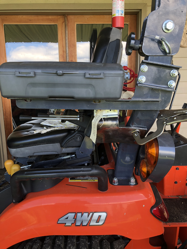

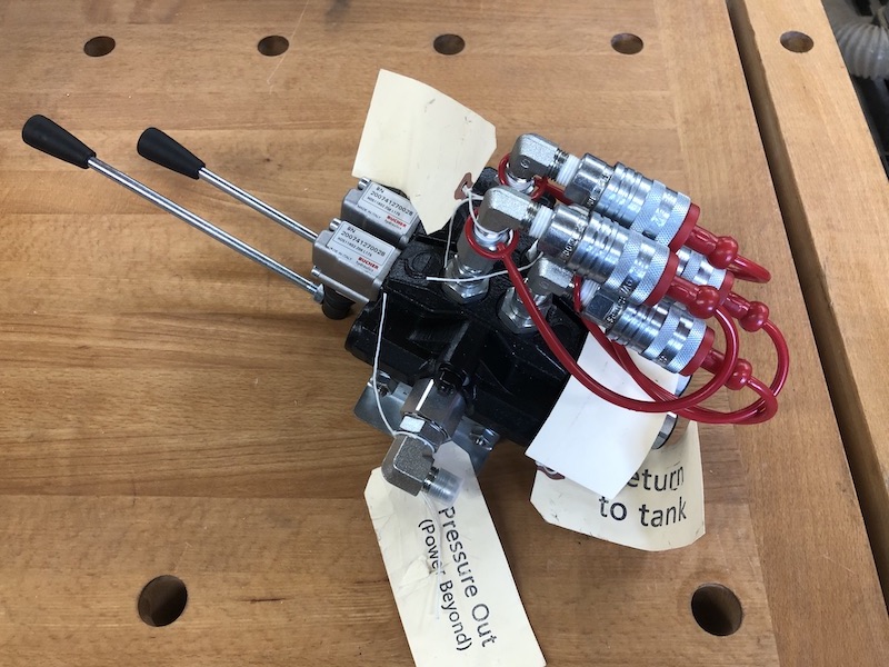

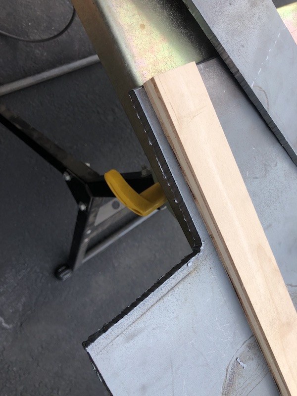

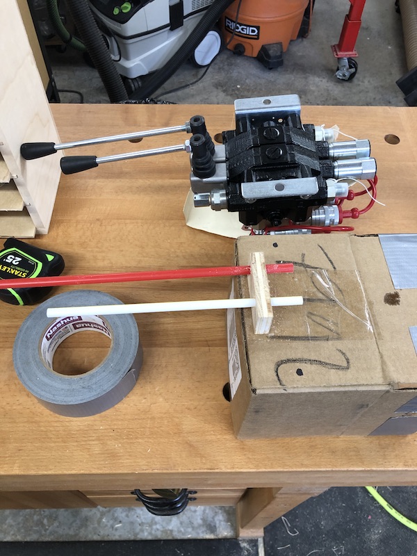

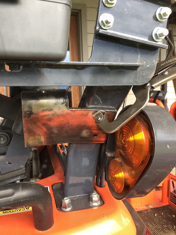

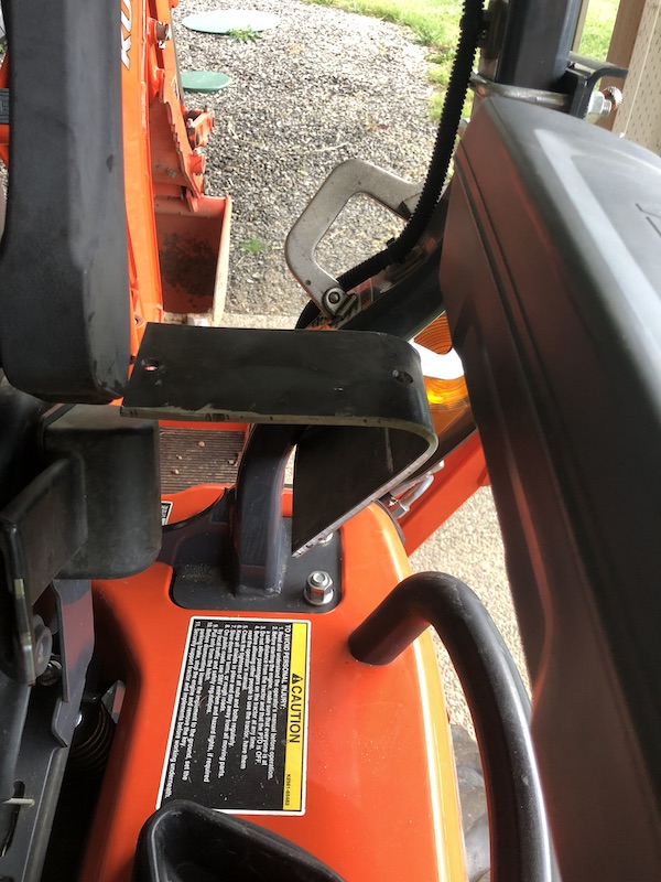

Okay the long awaited update to install my Top n Tilt and rear remotes! I ran out of excuses especially being grounded due to COVID so here goes.
One of my excuses was the difficulty in finding a suitable location for a mount not to mention the lack of real estate on a BX. Another of my excuses was the rear remotes are extremely heavy to hold in place while trying to figure out a bracket attachment scheme. Today I had an epiphany... build a cardboard model representing the remotes and get busy with this aging project!

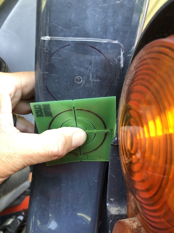

This helped me with getting the ergonomics and mount/dismount and cup holder access right as well as figure out what the bracket needs to look like. Once the box was put in place I cut and folded a cardboard bracket that would fit into the tight space and help me define the interfaces.

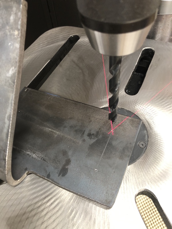

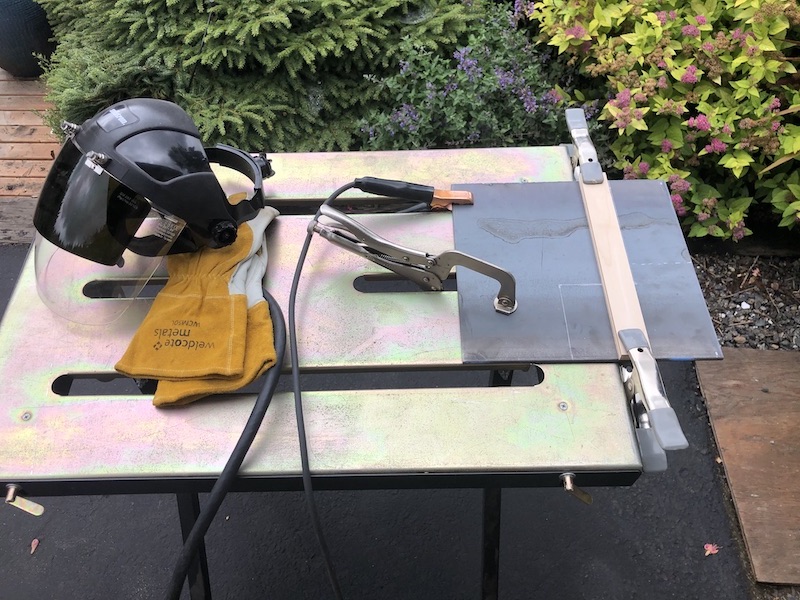

Decided to mount this to the ROPS. Once I got a decent idea of what the bracket looked like it was time to take a piece of 1/4in steel plate and plasma cut the outline. Basically an 'L' shaped piece that would require two bends and 4 drilled holes. Two holes to mount the remotes to the bracket and two holes to mount the bracket to the ROPS.
Realized I didn't get enough descriptive pictures so I will capture some more as soon as I get back on this project. The bracket has two bends... one is about 135degs (don't quote me) for the leg supporting the remotes, and a second slight bend to line up the remote with the seat.

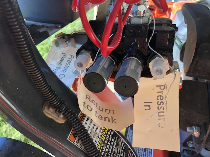

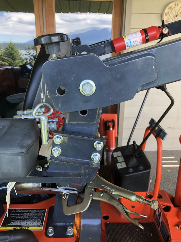

Got this far and realized the aux tool box is going to have to be moved up slightly so I can move the bracket up and outboard a bit to clear the seat. Not a lot of play here as I don't want to interfere with the ability to fold the ROPS. Cutting it close.
This means I will also have to bend the bracket a bit more to keep the remote mount level because of the shape of the ROPS where I am mounting the bracket. Further, I need to make sure I can still swivel the seat for backhoe ops. Did I say I was working in tight quarters? Stay tuned....
/ BX25D rear remotes?
#36

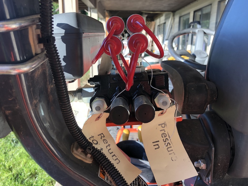

Okay, tweaked the bracket and repositioned the little tool box upward and the remotes fit! Made sure the ROPS still folded, and more importantly, I can still swing the seat around for BH operation. I think I can still use my cup holder as well!

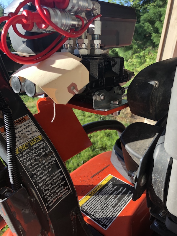

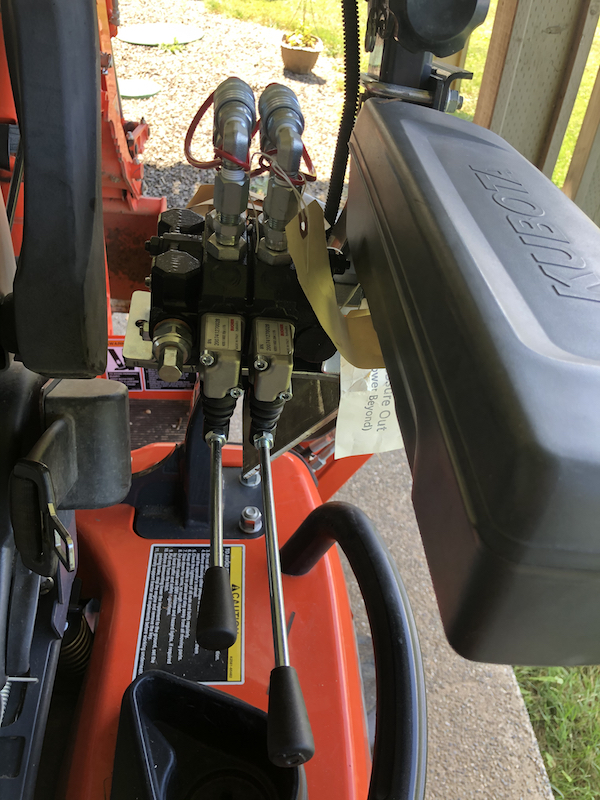

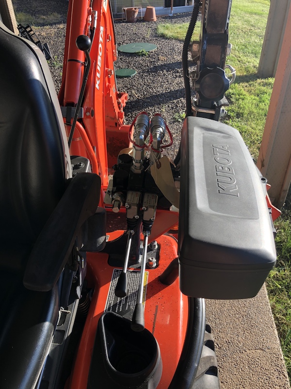

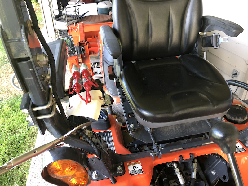

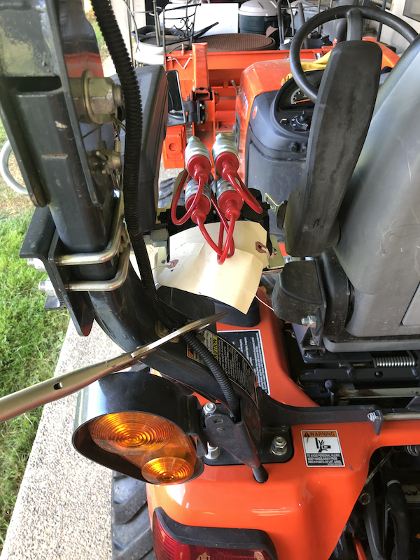

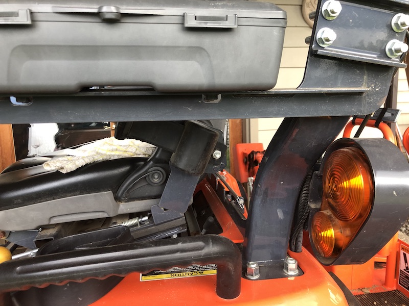

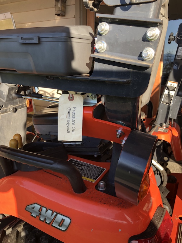

Got the bracket and remotes installed... mounted the bracket without welding or drilling into the ROPS.

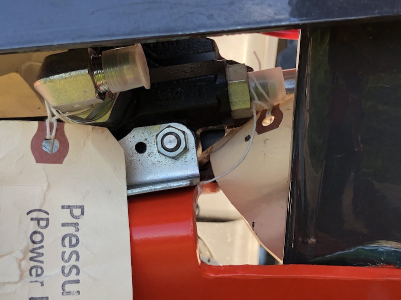

Now my concern is the Power Beyond connection. It is located about 2in in front of the ROPS and pointed directly at it. might need a right angle fitting?
Extremely happy though that this is fitting snugly and integrating like it is supposed to be there!
I might shape the bracket and make it more streamlined but didn't want to lop of the excess on the bracket just yet in case I think of a possible dual use for that real estate such as a magnetic holder for something. :confused3:
Time to study the hose routing. Luckily Brian at FitRight is still with me on this project with respect to the hose fabrication/connections! :thumbsup:

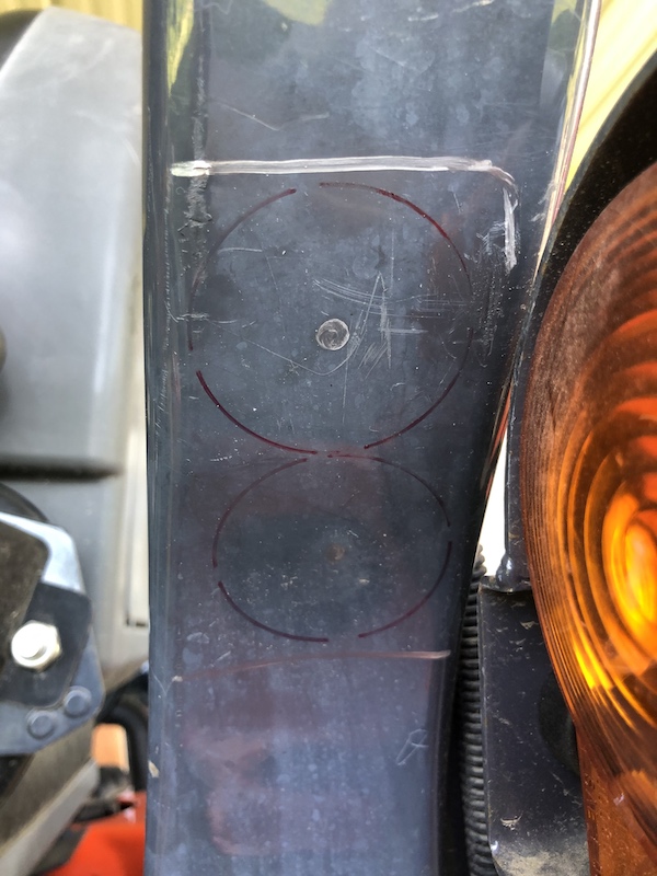

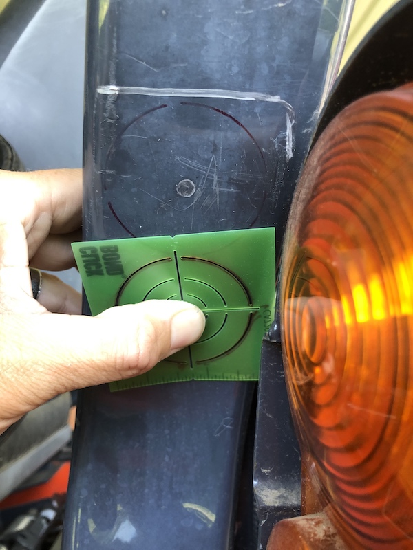

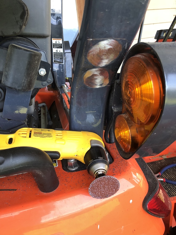

/ BX25D rear remotes? #39

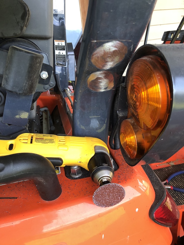

Nice work fitting and working around obstacles while still being ergonomically friendly.
Didn’t understand how the ROPS bolts to the bracket ? The sanded surface circles?
