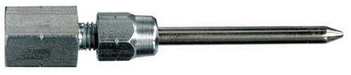

I broke two off of mine that way and now use the tip in the attached picture. No issues now.
Deano

How does that work? Does it fit into the little whole in the center of the zerk? I think we might have one in a kit we got.

Just push in the tip on the tiny ball and hold pressure against zerk while pumpimg grease.

Same question as you CTF for Deano - just what is that thing and how's it used? Haven't had to grease my backhoe yet since I haven't used it. It's sleeping in my shed until Spring arrives. At least after reading this thread, I'll be on guard for belligerent grease zerks.
/ BX25 Stuck Grease Fitting #20
CHD, We use them when we need roller bearings pre-greased, they work great for shooting grease to the back of the bearing, just stick the pin thru the rollers, and pump away! Usually leave the zerk tip on the gun hand loose, so it can be changed to the needle tip as needed. Our Fastenal stores supply our area paper mills with this item FYI. take care Joel
