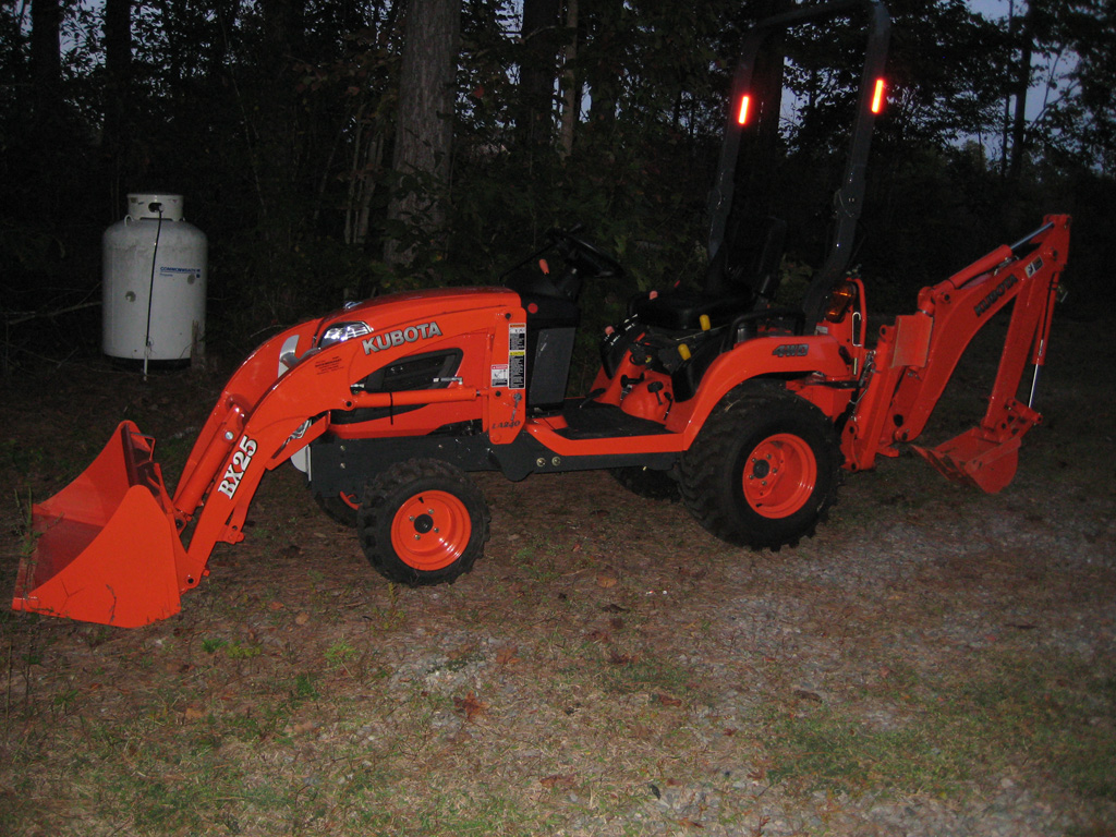

Hi there.
I purchased my first tractor a few weeks back after reading as much as I can on these boards. I picked up a new BX25 from the dealer for a good price. Anyway, I have about nine hours on it now. I live in VA, and the weather has been getting a little cooler now with fall on is. What I notice is that when I start the tractor now, there is a puff of white/gray smoke comes out. Also, once the other day it occurred while I accelerated from my working spot.
Cause for alarm/concern? I realize I am probably just being too cautious. I also read where some folks put in a fuel additive, E-85 I think. I can't say if I remember the puff prior to a new fill up of fuel, so maybe it is related to the diesel fuel I put in.
Here are two pics I took of the tractor after the first day I got it, and spent a few hours trying it out.
