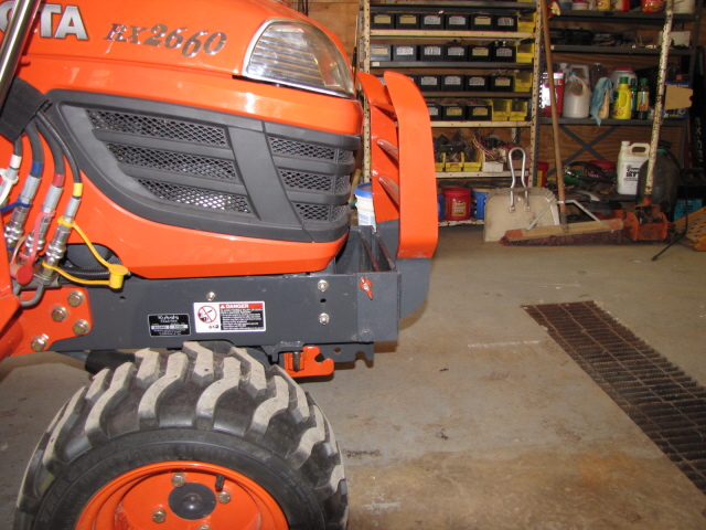

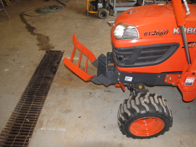

/ BX25 knocking noise #8
I tack welded the bolt heads on my tractors brush gaurd. No more allen wrench needed!! Oh yeah, way to go on helping with knock Tod!!:drink:
Thanks Dean. Welding isn't on my limited list of skills but that sounds like a great idea!
/ BX25 knocking noise #9
I did this and I don't have to remove.
