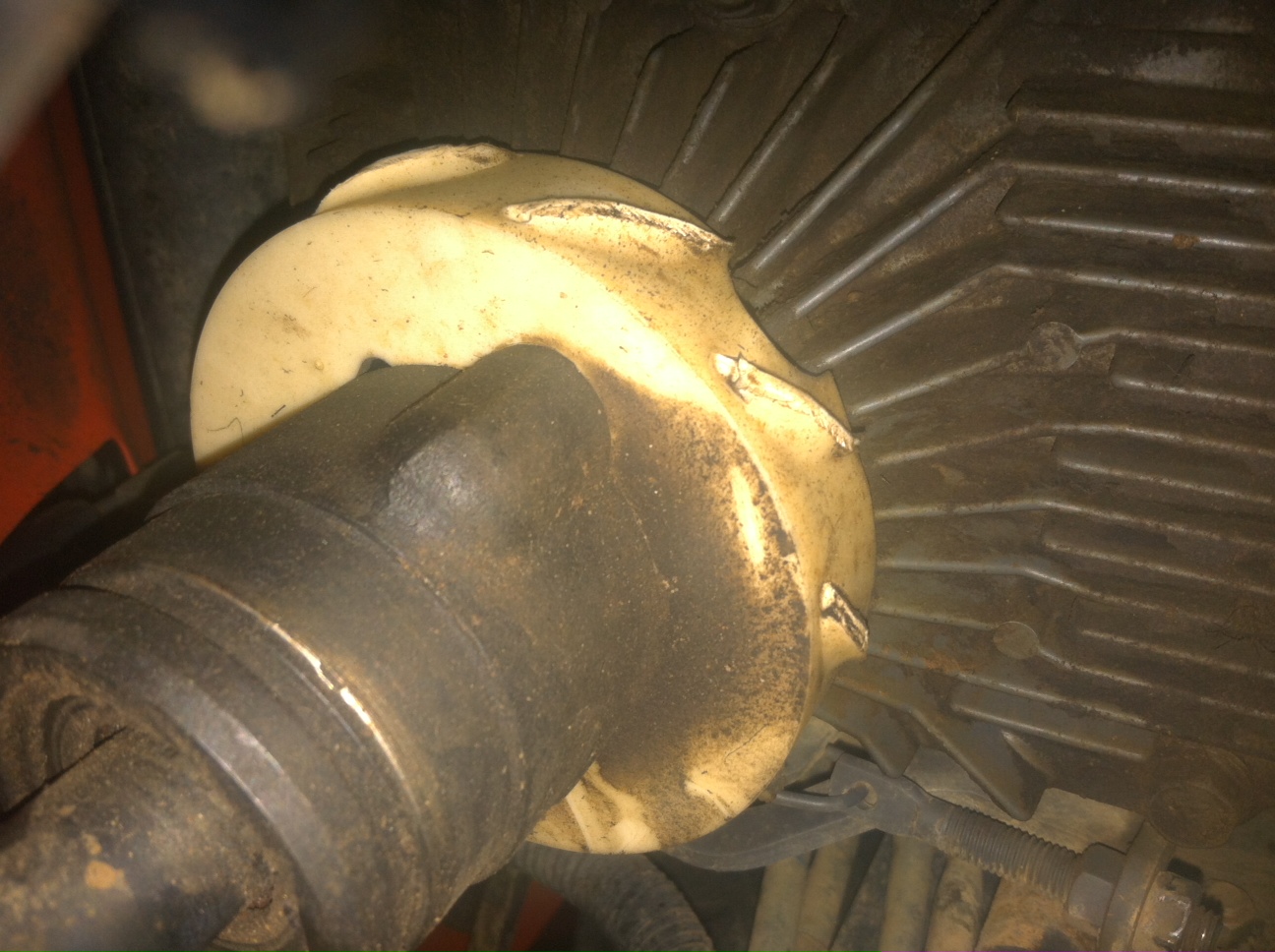

I just completed 400hr service on my BX25D and found this little surprise. Yea. I had a bro-tech skid plate on too...if there is a will there is a way! :mad:

Now you can join the BX club.

Ouch!
That's gotta hurt since you had the skid plate!
I keep reading these BX fan threads and remember several years ago a member had a machine shop fabricate a couple of stainless steel fans.
I wonder how it worked out for him,and if it might be the final answer for BX owners?
Good Luck!
/ BX25 - HST fan blade trashed

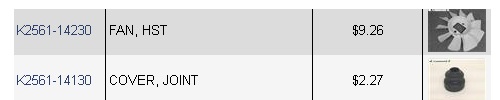

It would be great if someone made a metal replacement or a really flexible one. Working on hunting down part numbers now. Looks like the boot needs to be replaced too.

I submitted this in another thread so apologies if you've already read it. A couple of weeks ago I had the same thing happen - Brotek rear shield in place (but no front shield) and with the shaft plate also in place; but nonetheless in driving through the woods a thin tree managed to snake its way up and stripped all of the blades in a second.
Rather than go through the prescribed process to replace the fan, I fashioned (an idea from another post) replacement sheet metal blades (only 5 rather than the original 10) and screwed and glued them onto the plastic hub. It seems to be working although only time will tell. I also shielded the hydralic lines next to the fan in the event that a metal blade flies off or (more damagingly) comes partially off and hits the line while spinning.

After reading several posts on the subject I went and checked underneath mine and sure enough the same surprise on my 2011 BX25. Its a PFP (pretty f^&King pathetic) design IMO and not sure I will replace it. My quick solution was; I ordered the BXPanded Under Armor and a 3" Attwood electric bilge blower, cost was $18. The fan moves a good amount of volume, probably more then the factory fan mounted to the shaft in close quarters. I mounted the blower on the topside of the of the under armor to the left of the lift pump and had plenty of room. I then tapped into the lift pump power harness ahead of the connector for the pump so it turns on/off with the ignition. You definitely know the fan is on because it sound like a little turbine taking off until the sound of the diesel comes to life. The fan draw is only a few amps so I'm not concerned of overloading a circuit because the lift pump is a beefy one. I used a male/female connection in case I need to drop the under armor off the tractor for service. The hole install took about 45 minutes to complete and I feel pretty confident there is plenty of air volume cooling the hst now. The fan actually draws cooler air further from the hst and moves it out the rear, checked it with a smoke test. Hopefully this turns out to be a viable solution. Does anyone have an idea what temps the hst are running at? I will be monitoring my operating temps and may install a permanent gauge it more easily to check soon.
