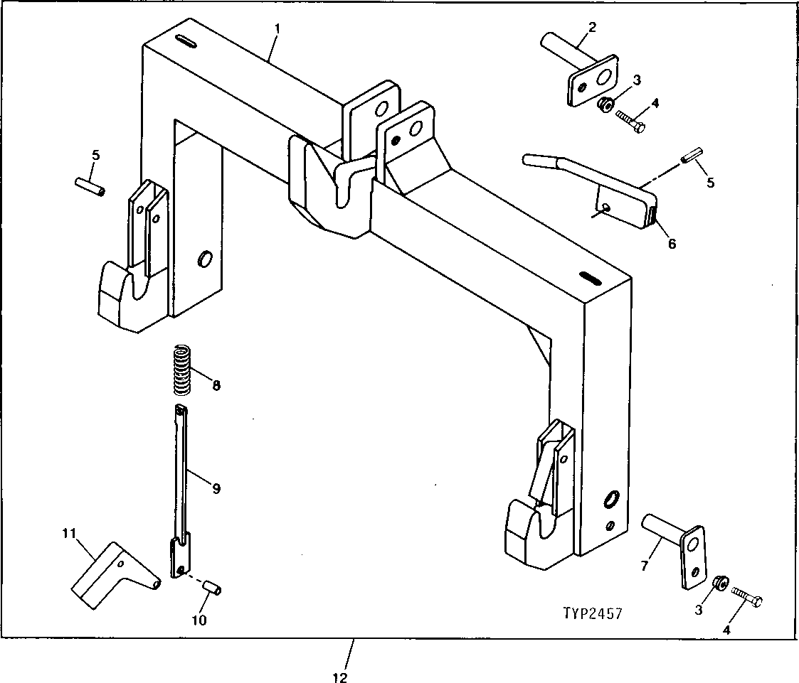

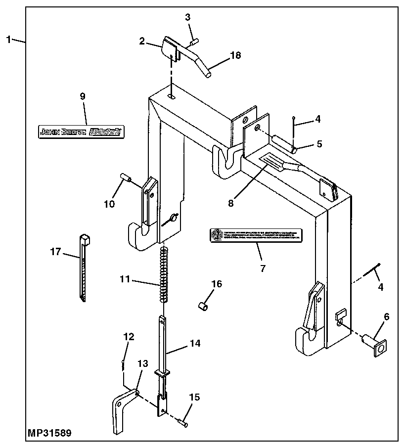

/ BX25 Harbor Freight Quick Hitch #35
Here's the picture of a JD QH
Item 6 in the picture is what I think you're talking about.
Part #: PM9206
Description: Lower Link Pin
You can get the part numbers here https://jdparts.deere.com/partsmkt/document/english/pmac/5998_fb_Hitches_Quick.htm
and do a search on https://jdparts.deere.com
Price comes up as $6.83
Actually I was expecting the pin to be like the ones on my JD CAT 2 QH. The "flags" on the ends are drilled for a retaining bolt.
