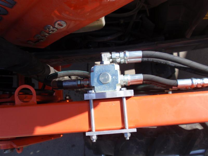

/ BX25 GrappleOmatic #167
Artisan,
I see you list your fasse diverter as a #302-666, but I do not see that valve listed in their webazine or any were else on the net. Is this a new valve they are offering? I find similar ones on their site but none with the four outputs on one side. I am just beginning my grapple build for my JD 2520 and was looking hard at the valve at the surplus center until you made some pretty good points to availability, serviceability, and possible re-engineering later on. I would like to see in my local JD dealer can get this diverter but want to make sure of the number as I have not seen it anywhere else. From what I see, most of Fasse's part numbers start in the 700's. Just curious as I don't want to confuse the dealer any more than they already are.
Thanks,
Ryan
#168
Ryan indeed it is not in their webazine and it is a good a number.
Here is the contact info;
Kurt F. Dannehl
President & CEO
FASSE VALVES
kdannehl@fasse.com
Tell him you saw it here, he will get you or your dealer set up...
