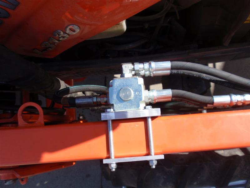

Mind you, I got a diverter which is one of several ways to skin this cat. Some run a separate system, some run off rear remotes, etc... Mine diverts the Curl/dump circuit to the grapple open/close circuit when the button is pressed.
I think the surplus center comment was about using general components from there, not Fasse.

I didn't look at all of ductapes links but what I had found that really sets the
Fasse apart from the others is all 4 outlet ports on the Fasse are all on
one face of the valve, not on 2 different faces as in most other valves
I saw. It really makes for a nice clean install...

I dunno. I think coming out the side works just fine. Here is the shot of mine from above. Inputs on left, outputs on right and top. It would get a bit crowded all on one side, methinks. It was hard enough to get wrenches in there as it was...
BTW the valve is just a Bosch valve. Fasse is doing nothing there other than acting as a dealer for Bosch there. What they added to mine was the wiring harness and switch, and getting that all assembled together and neatly bundled with the right connectors and such. No complaints, but I probably could have picked up the valve and switch components on my own had I known better at the time.
