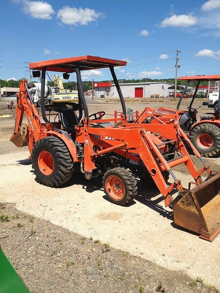

I have a factory "ROPS" on my BX25. Kubota Co. sells a canopy #1133 I
believe that attaches to said ROPS and I would bet that attaching said
does not void any warranties to the OE ROPS system. It is quite the
substancial system...if I remember correctly, FWIW.
Maybe I titled this post wrong, maybe not, but my intentions are to start
thinking about adding a pair of "A" pillars+ possibly joining w/ the 1133
canopy bracket. If I flush out a lurker, or other, w/ pics, who has done it
prior, so I might learn from their "been there done that" knowledge THAT
would be great, alas to date I see nothing built to the standards "I" seek.
I remember that 1133 bracket as being substancial, built just like the
rops it is "if I remember correctly". From there a pair of "A" pillars down
to the FEL rear supports and afix w/ bracketry, again, no welds, no
drilling, just attach to... I will probably make it w/ an "X" or "H" system,
maybe both. I am POSATIVE I can enhance the safety aspect of the
BX25, I hope not for a huge wad of cash as well. I need to fall upon the
right ROPS system, again the OE ROPS may be the ticket. So if anyone
is reading this and if you have a BX25 ROPS you took off I might be
a buyer...
It will need a few things for added support. I may "X" the A Pillars and
throw in a horizontal bar just above the dash, or maybe both...
To date I have not seen anything built for a BX25 that get's my approval.
Nada, Zilch Zip... I have seen a few men make there idea of
a cage, not to my standars is all, they did good, I want to do better...
The end all may be finding a stock BX25 ROPS and modifying it into an
"A" pillar stiuation, used in conjuction w/ the OE unmodified ROPS and
canopy bracket, I mean w/o so much a even painting the OE ROPS, let
alone welding to it.
I think it can be done w/ simple bolt on bracketry. No welding to frame or
voiding any warranties. I saw what can happen personally and trust me,
"something" will be Waaaaaaaaaaaaaaaaaaaaayyyyyy better then nothing
for ROP and FOP AND side swiping branches...
I wish I were made of money, I am not so I have to do mountains of
research on stuff before I implement said ideas, and eventually I will do
something, when all the stars are aligned, it will happen, it WILL work.
Right now I need to make sure the wife has anough cash and the model
number for the canopy I seek seeings how my BD is coming up :thumbsup:
PS & FWIW; I refuse to buy into the train of thought that I
should bow to the Harvard or Yale taught designer / engineer at large and
go w/o, simply because they do not make what I want and indeed is
needed, buy my readings, wanted by a lot more folks than just me.
OK WHO WANTS TO MAIL ME AN OE BX25 ROPS! I'll pay shipping! :D
