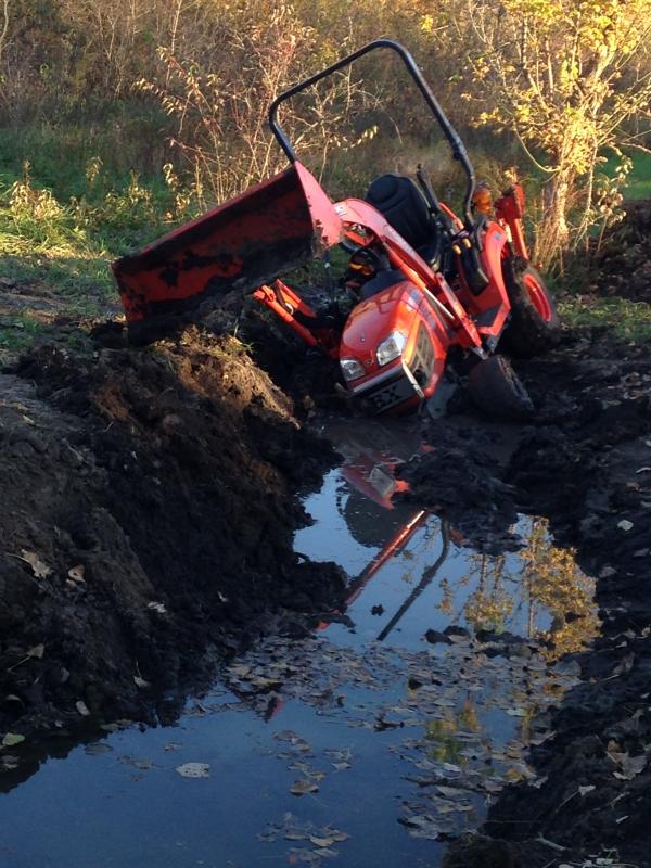

As some others said, you need to evaluate the spring first of all. Is it a true spring, high ground water, water trapped above ledge rock, or ??? That's what you need to know first.
Pics would help, but if the lay of the land is fairly flat, you could dig out a small frog pond about 20-30 feet away from the wet spot. Just pile the dirt up because you may be filling the hole back in eventually. Have an idea for where an overflow outlet could be and where that water would go. Then dig a small trench from the wet area to your hole.
If the spring continually supplies water to the small pond, enough that it overflows, and does that for most of an average year, then you have some water to work with and an idea of how much. It doesn't take a lot of water to keep a small pond full. Chances are you will get some ground water too.

I'd dig a hole at the spring first. Then you will know what you have in terms of water flow. If you can get a deep hole dug then you can pump it out and determine the flow, and then maybe lower the water table and have better digging. If you cant find a bigger digger it would be good to have some big heavy machine around to pull the BX out or at least to tie off to.
One thing about having the BX, you can dig a little every day. Other BX owners DREAM about having to dig a pond and one drops right in your lap. Dig away, what the heck else are you going to do?

I agree about just going for it... but I am not sure about starting at the water source. I think I would prefer to dig it all and then 'break the dam' to fill it. Otherwise, likely you will be working in slop and getting stuck. Just my ignorant thinking. I have a few springs on my hillside and am thinking of creating a pond at the lower end. I already had a natural swamp/pond about 25ft to 30ft in diameter but it got filled and 15ft high with clearing debris when I had a big excavator come in. It just happened to be the right spot. Eventually I want to clear that debris and dig it out a bit and see if I can't create something a little more aesthetically pleasing by routing water to it.

Working in slop and getting stuck....that does not happen :)
Don't forget half of this stuff is to be fun, too much real issues in life......just start digging and see what happens...what is the worst that can happen

Sorry if not clear. Suggestion is to dig a well at the spring source, so you can pump out of it (maybe electric) , or if a long grade, siphon out of it. If not too far, put a pipe in & drain it as low as you can. Then it will be better digging, less mud.
Sounds like fun to me, something to goof around with after work. Get a couple hundred hours of experience running your eqpt, then if you rent a bigger digger you will be more effective. Or sell the BX and buy a bigger tractor if it becomes necessary, you will now have a good reason. So what if it's too small and too slow, you'll know yourself when/if you hit that point.
