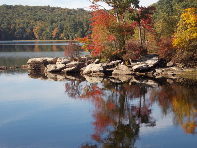

You might want a big excavator or dozer to do the bulk of the work. You can fine tune with your BX. Before I did any of this however, I would check with the county or local building officials. In my neck of the woods, if you have a wet land, the land becomes so regulated that you have to almost check and see if passing gas is allowed near it.

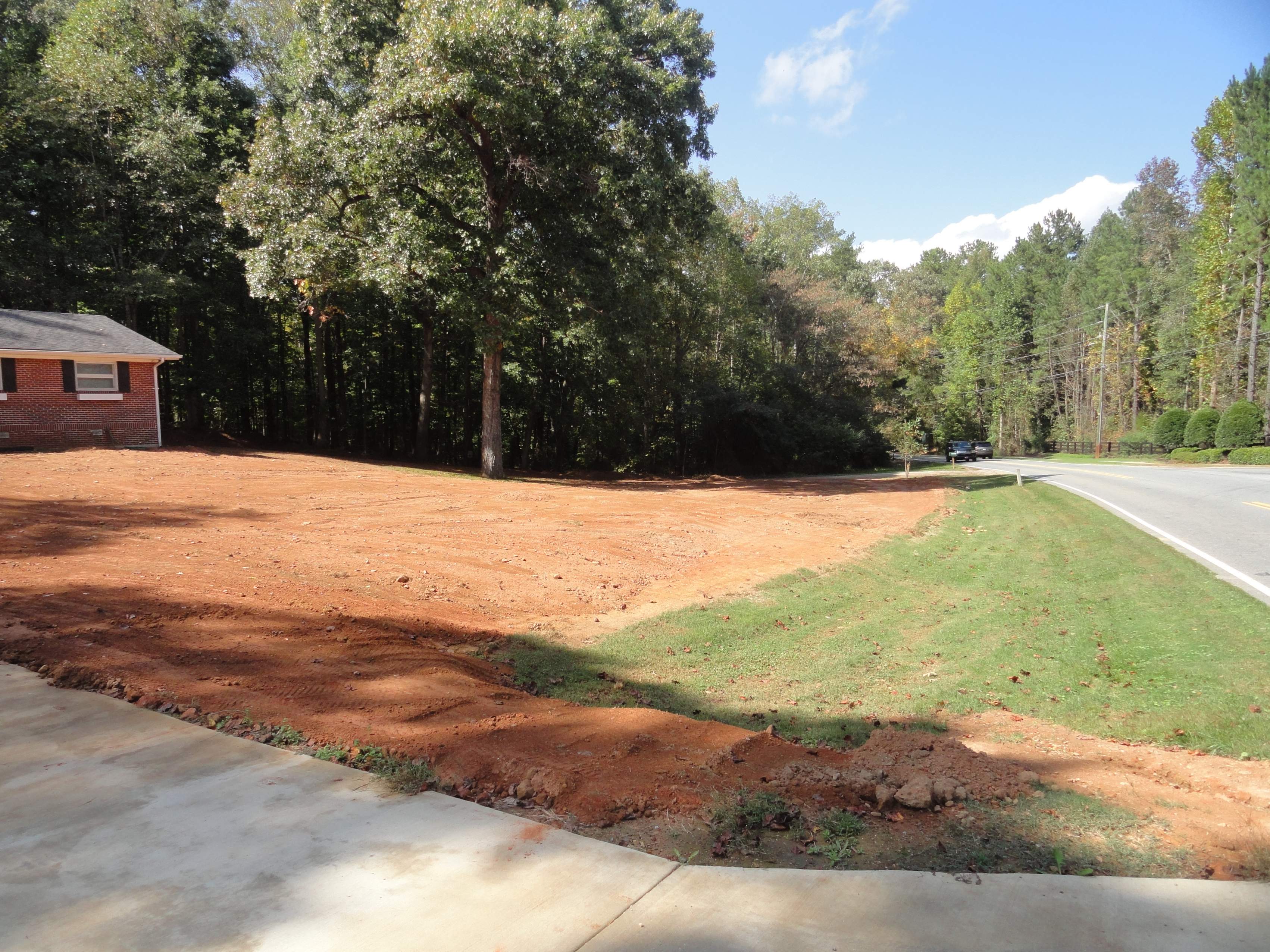

It took multiple days to move this berm...
I can't get this "flat" to SAVE MY LIFE!:confused2:
I've got a "pro" with a skid steer scheduled to arrive on Saturday. He'll flatten it out, then it'll get seed/straw.
I'm completely THRILLED with my BX's performance, but "large jobs" can take longer than you expect.
"Yes," it can take down mountains, and dig lakes.... do YOU have "that much time?"
:2cents:Beavz
