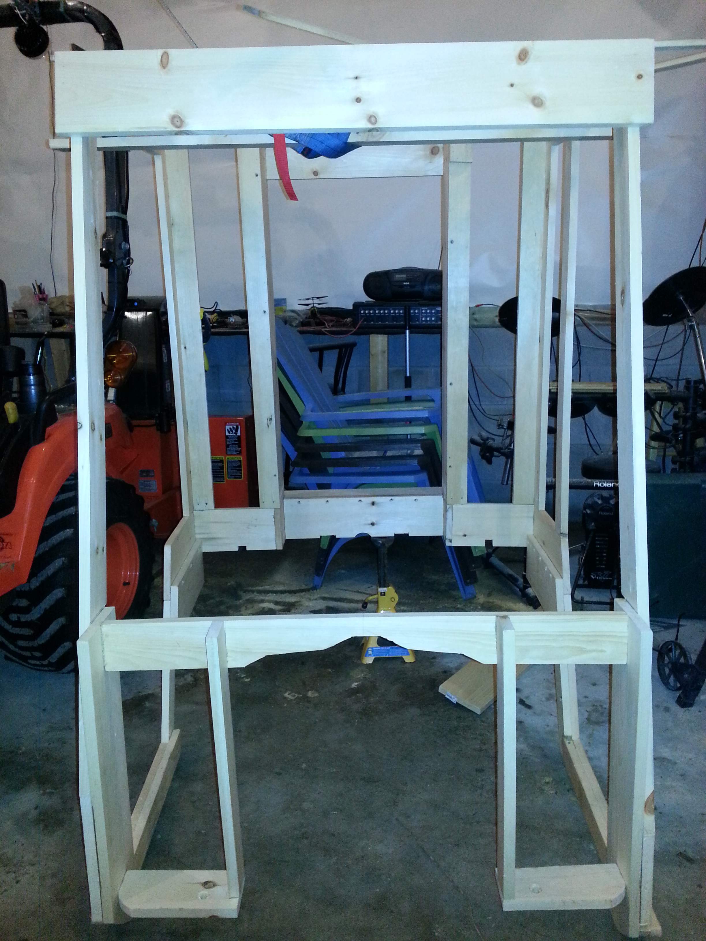

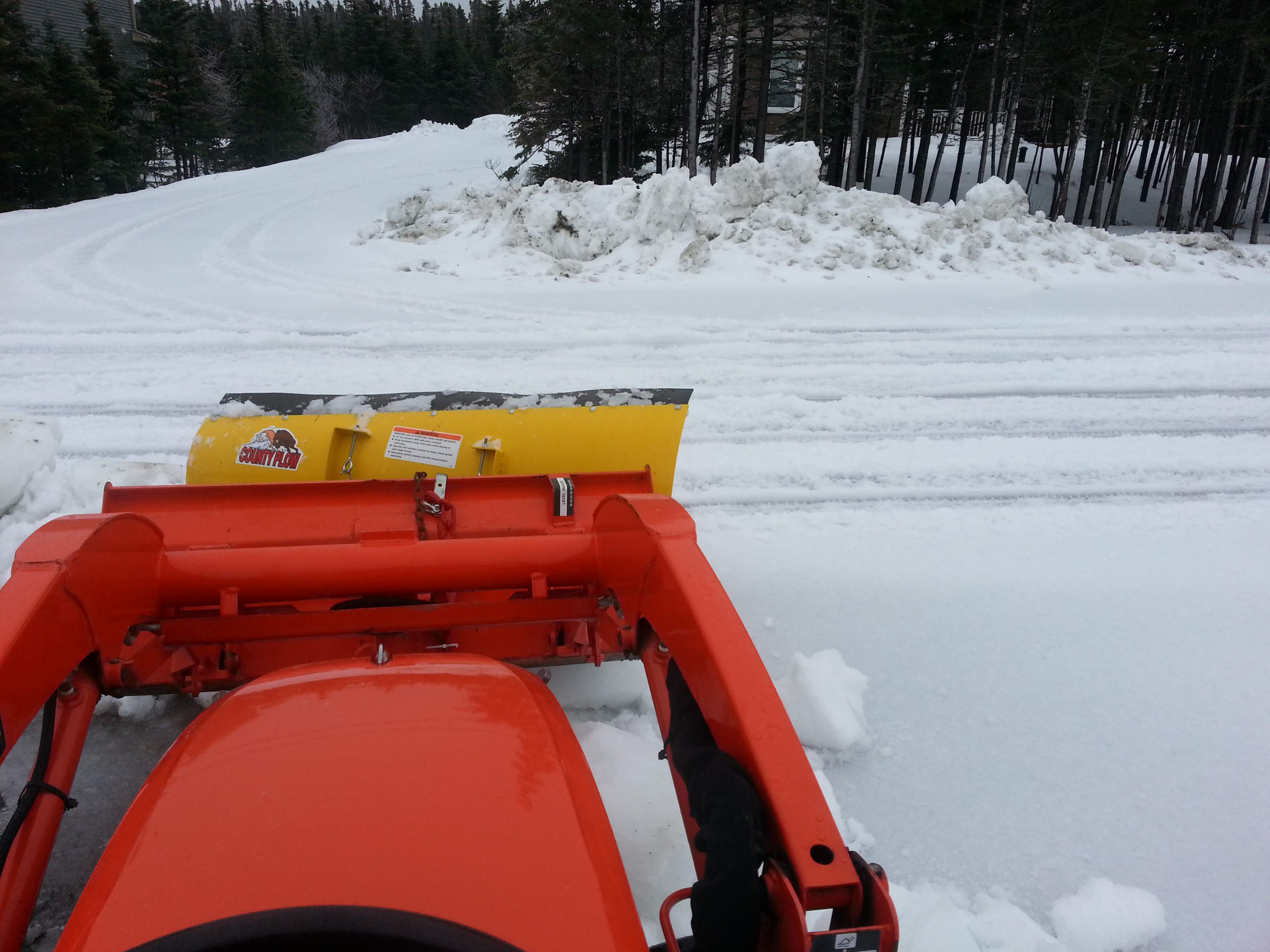

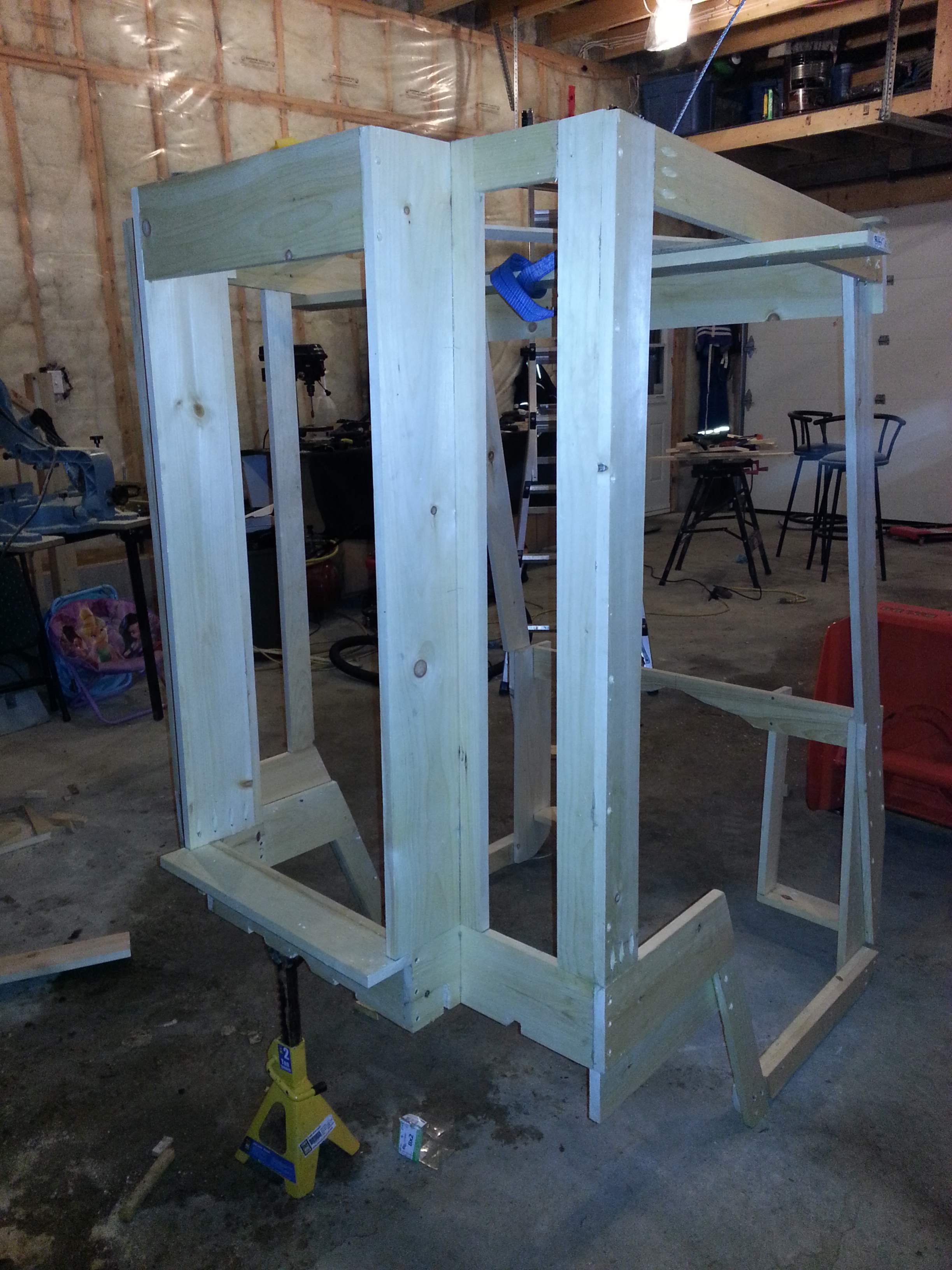

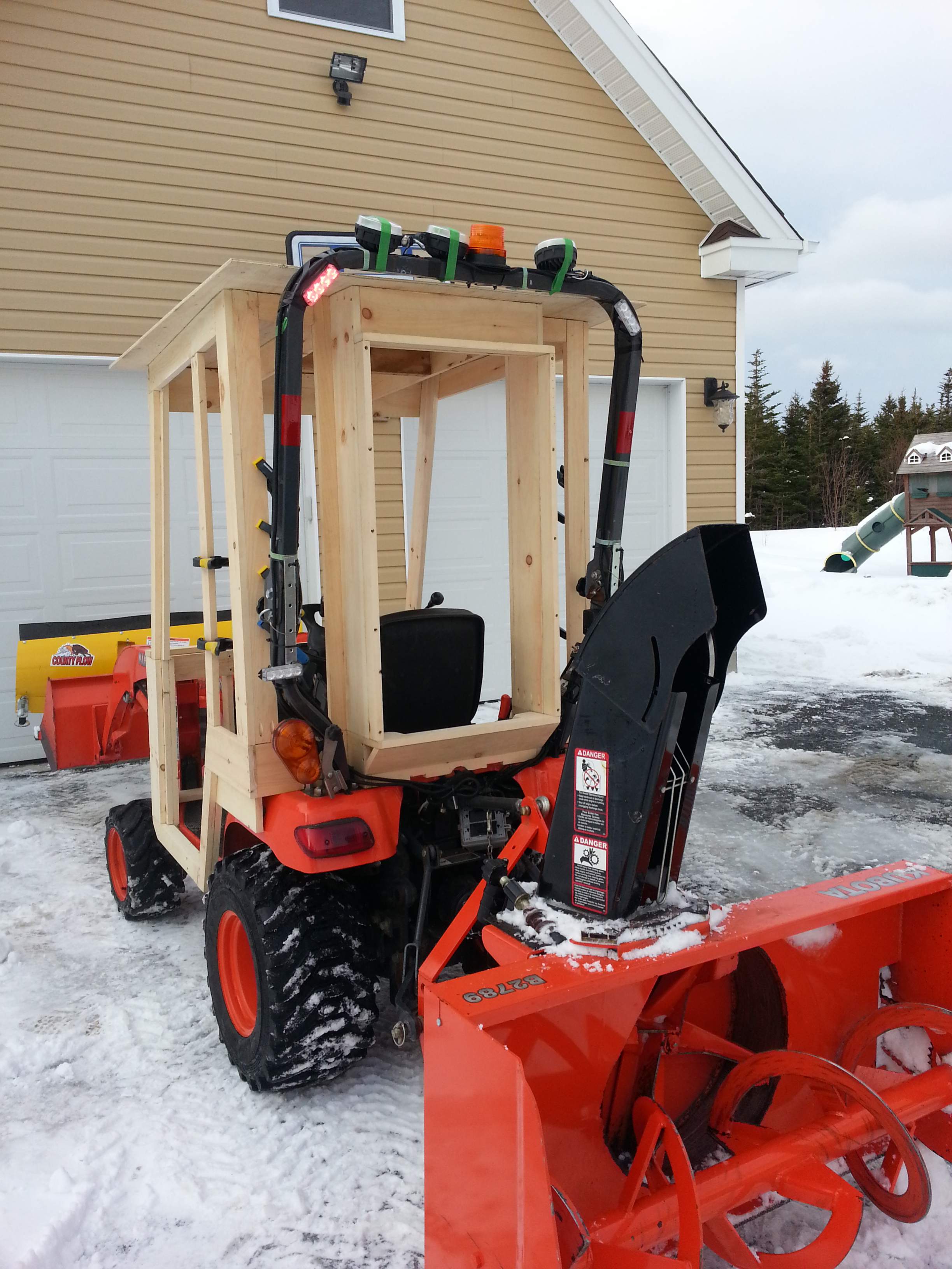

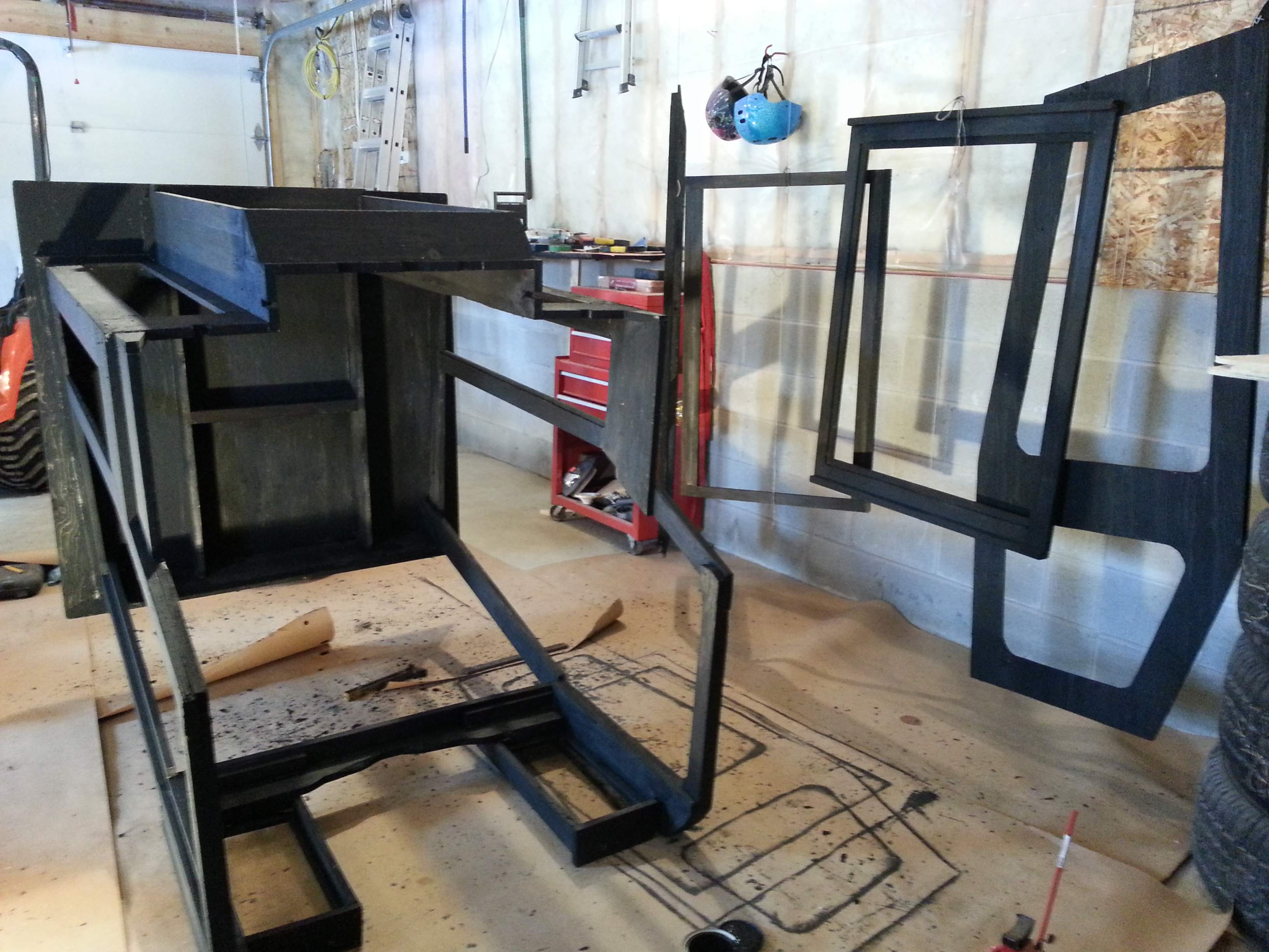

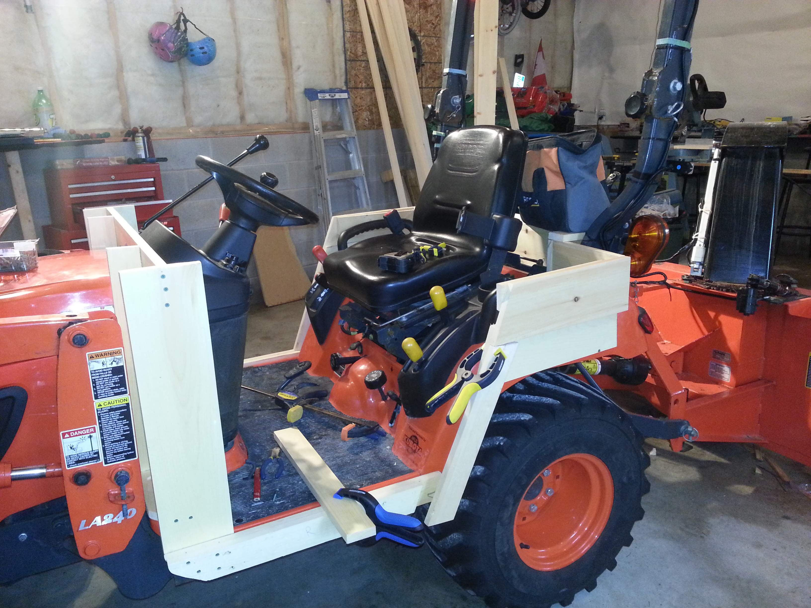

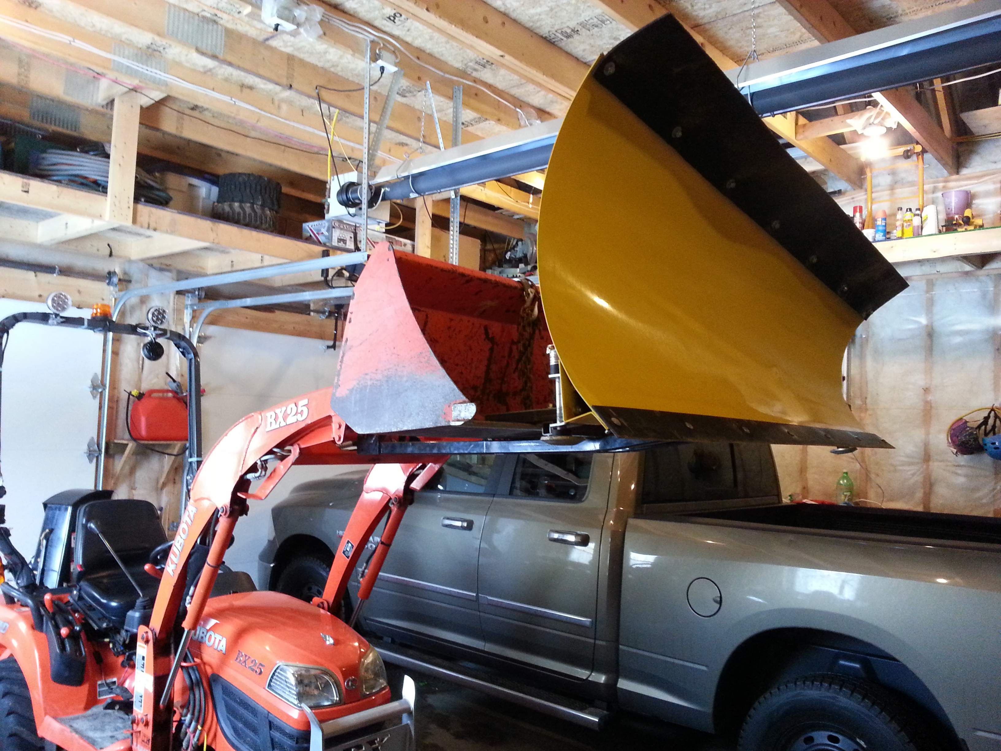

So with 400 hrs and several winters on my BX25 I figure it's time to do a DIY cab. I've been on here for some time reading and looking at what others have done and while I do like to work with metal I don't currently have a welder so decided to follow another member (RAECOREP and his $300 Cab) and do a wood build. I'm only one Saturday into the project yet but though I'd post some pics and let you see the progress along the way. I have several ideas in my head so hopefully they make it to the bench and on the cab. I have to say that already this is turning out to be an interesting project and I'm sure it's gonna pass the $300 mark, how far might just depend on my ideas. I'm hoping to keep this cab on all year long so I'm building it with the backhoe in mind. Thoughts and ideas welcome as I venture down this road! The pics of the plow (5' ATV) are from a parallel project to in some ways duplicate the BXpanded plow at a fraction of the cost. I live in Canada so shipping kills us, we have to do things ourselves!

For a minute there, I thought that was pictures of my cab project. Looks great!

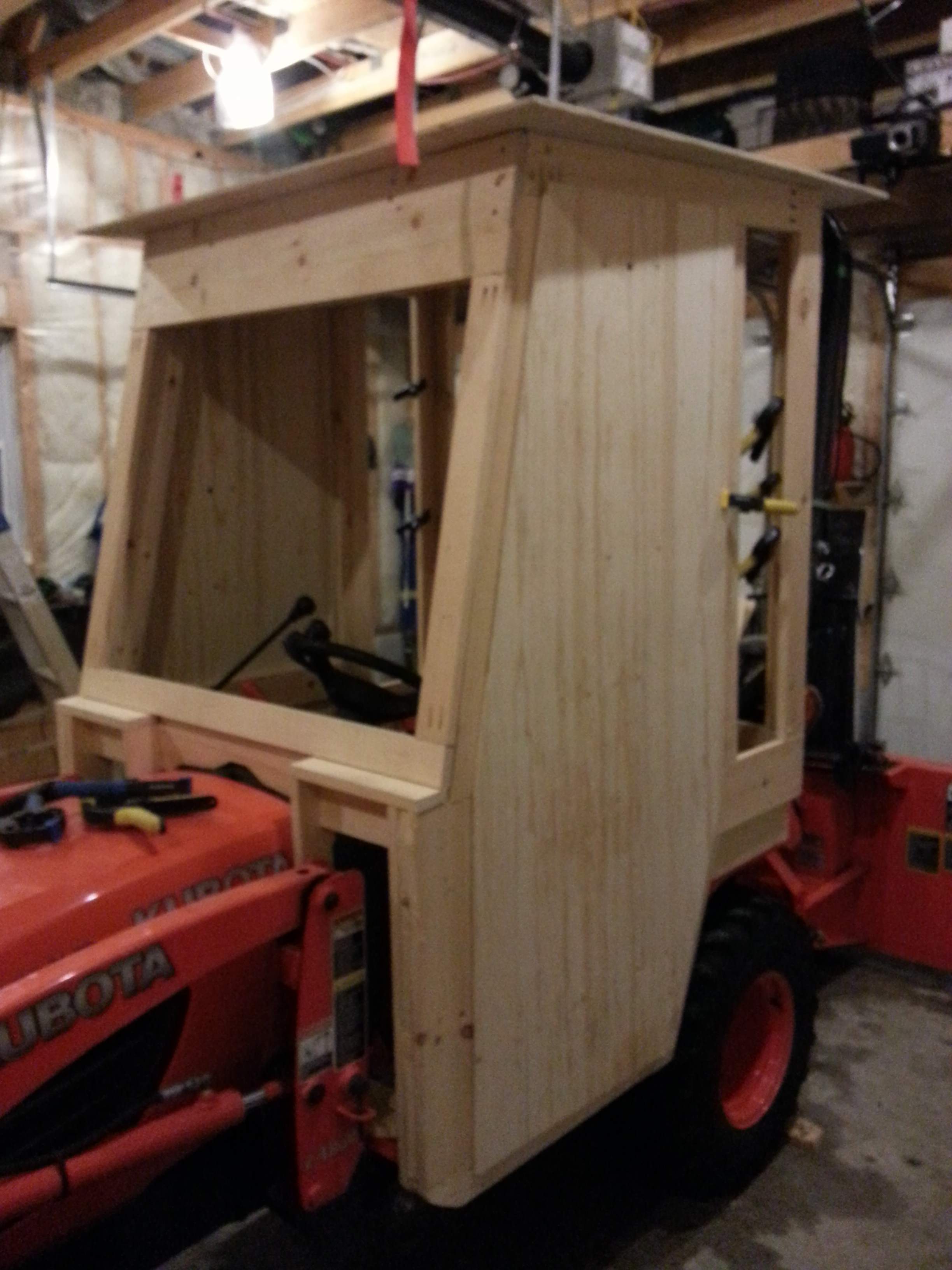

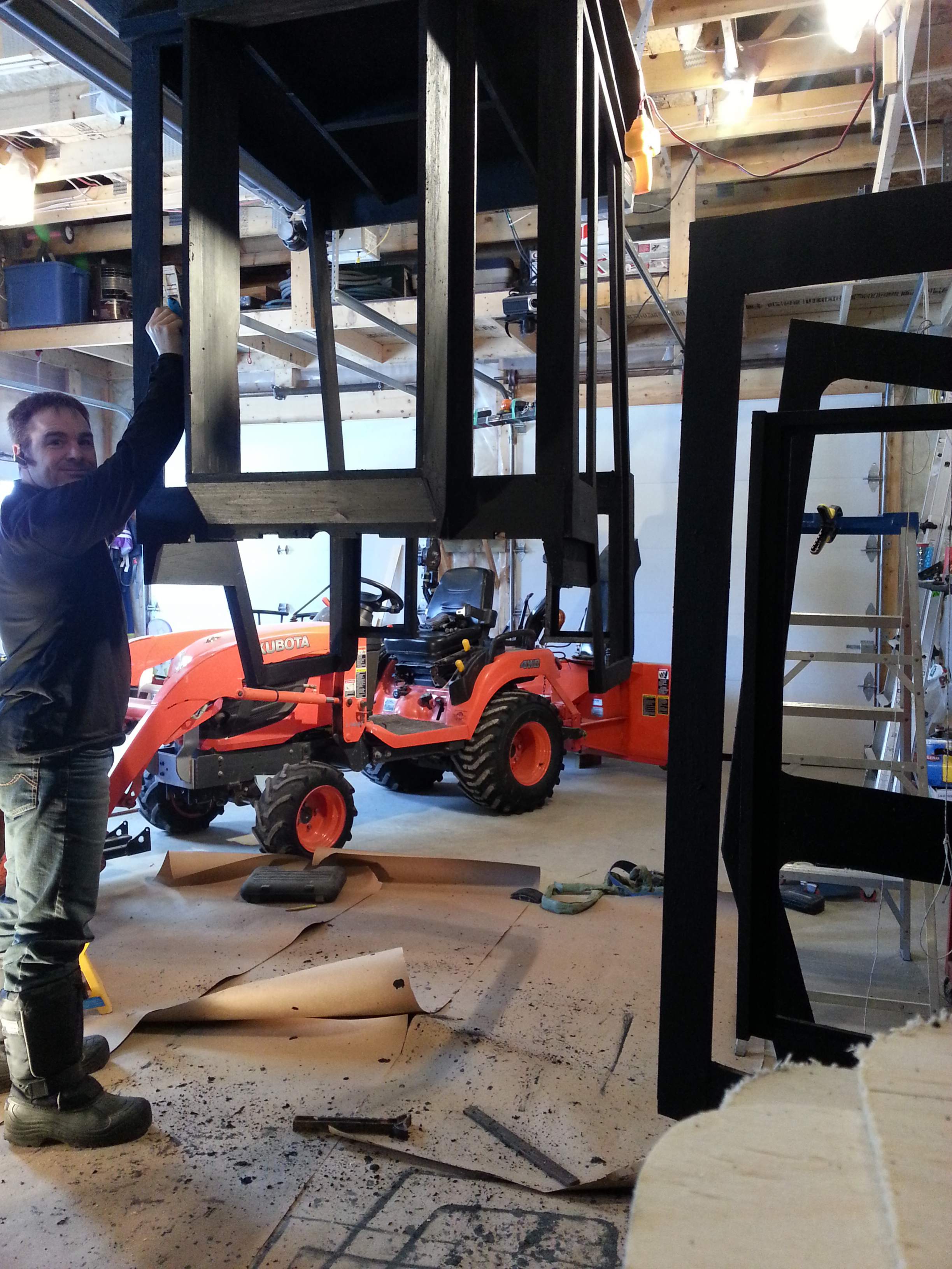

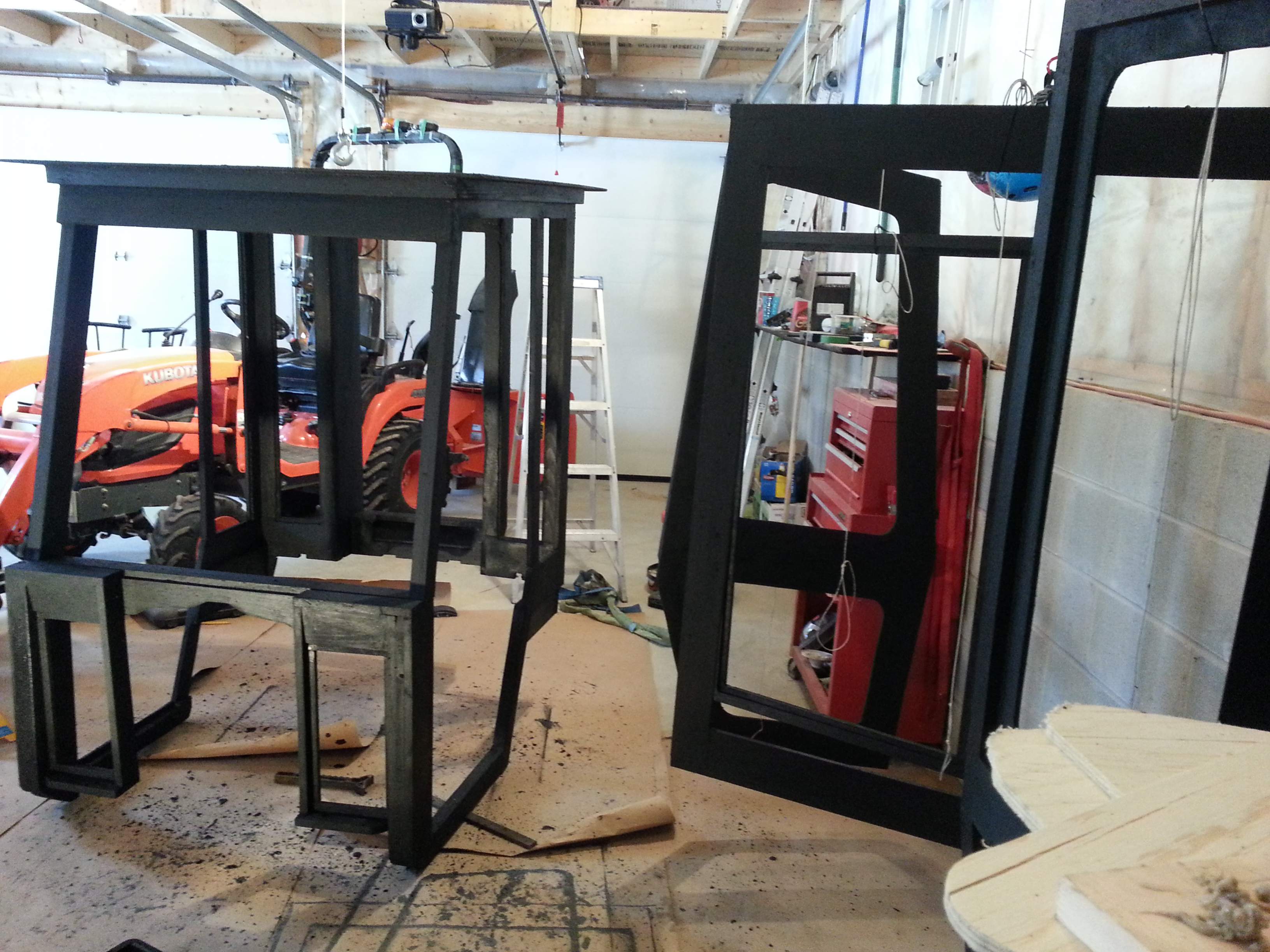

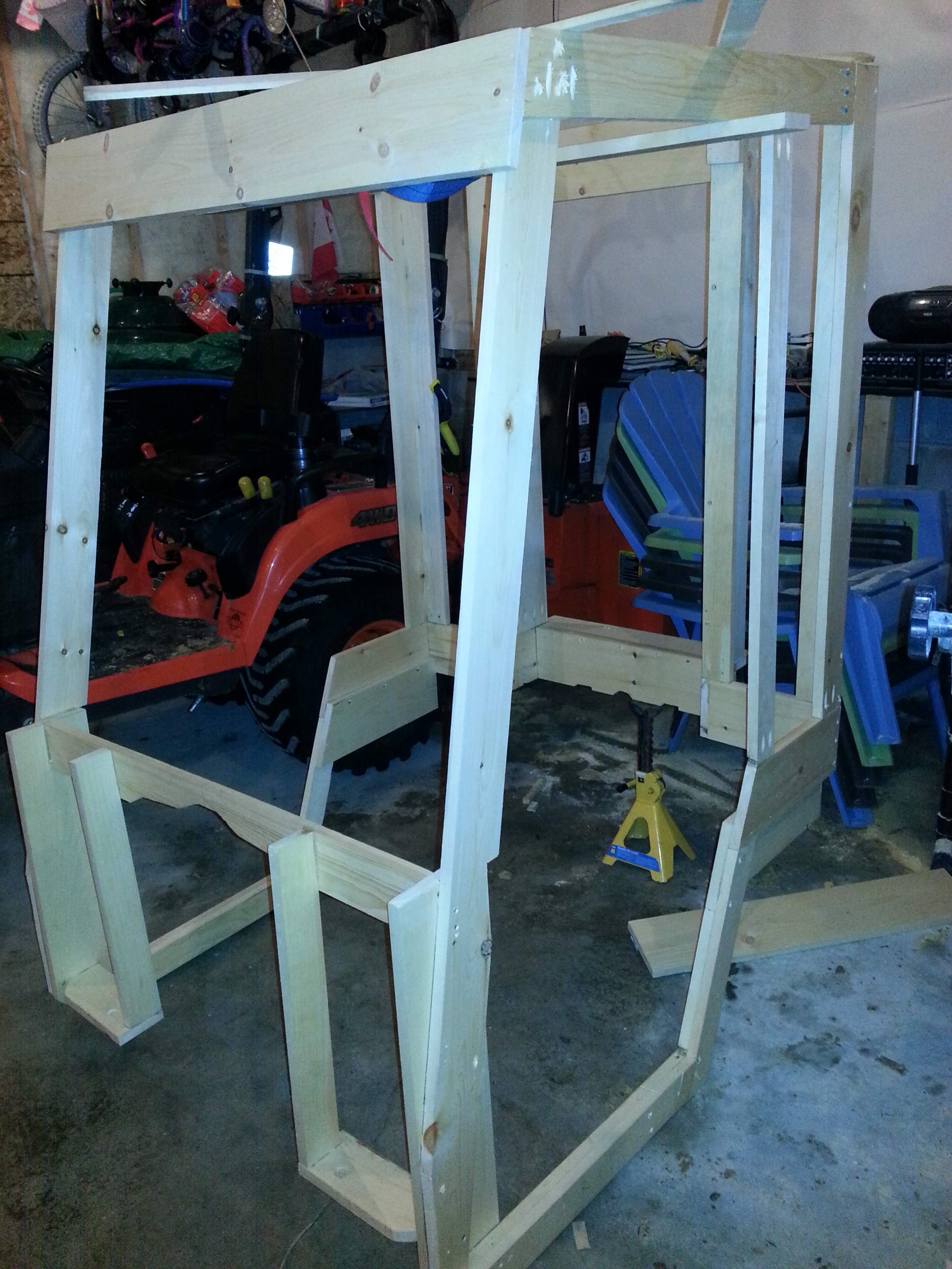

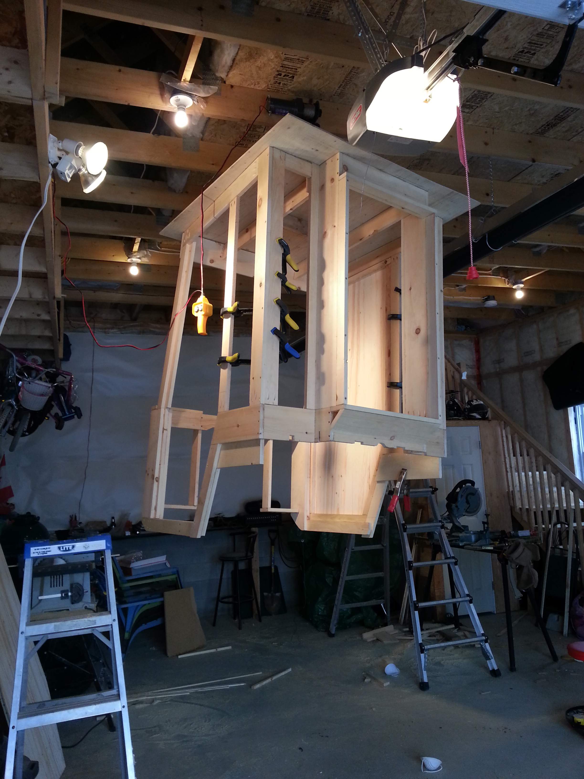

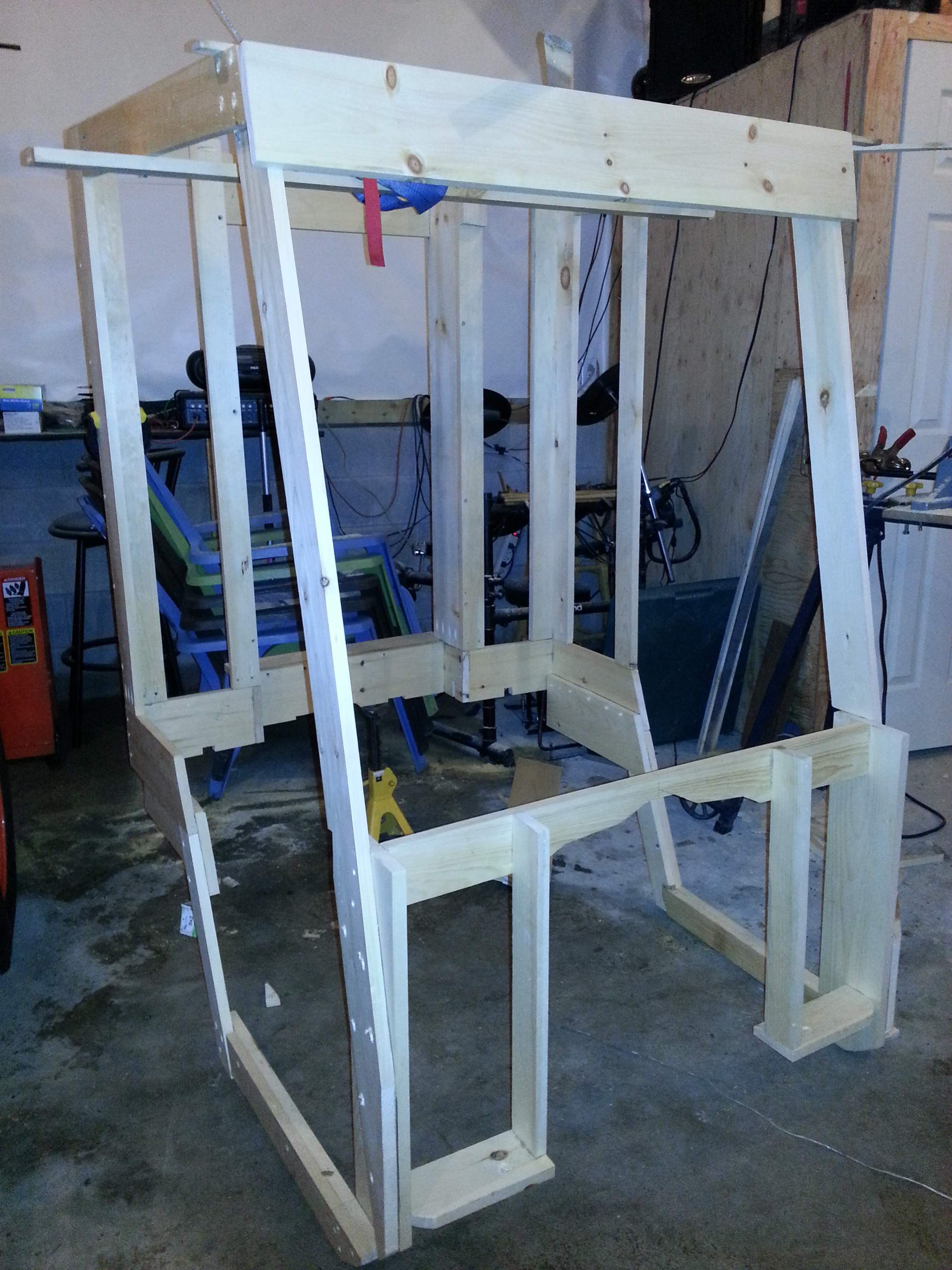

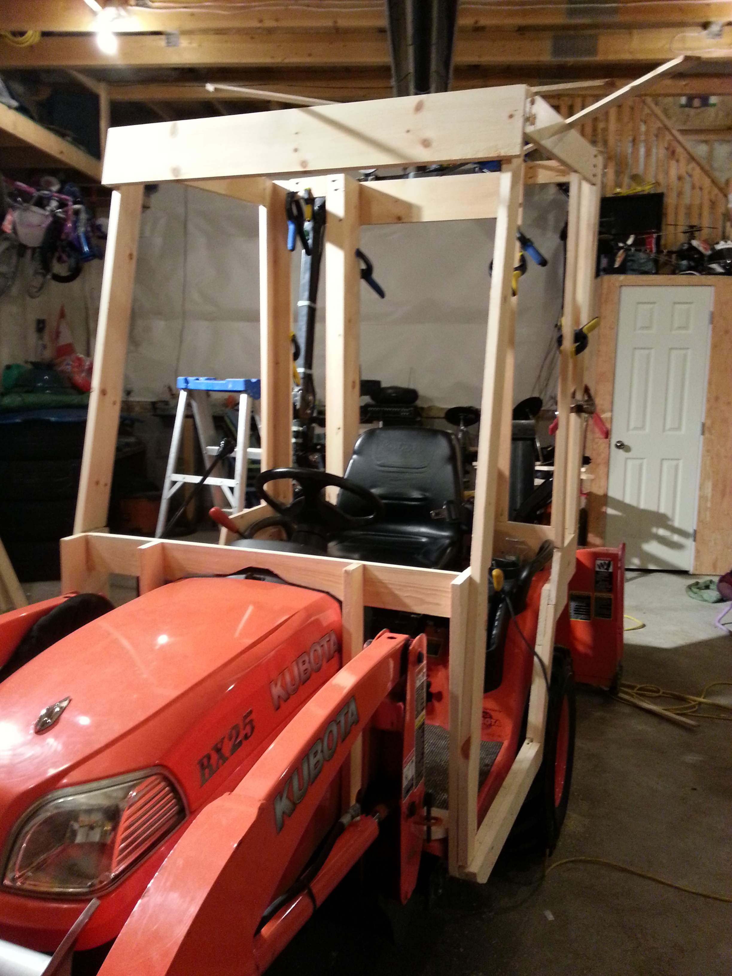

Kreg Jig is a tool used to make pocket hole's for joining wood ends together. Here are a few pics from this weekends progress. Have a few more pieces to fit, paint and then some glass. Had to order hinges online as I wanted lift off hinges and couldn't find them at any of my local small/big box stores. Hopefully they show up this week. Once I get the frames for front and rear windows complete I'll take them to my glass place to be fitted. In case anyone is wondering, every joint is glued with PL Premium construction adhesive and then screwed, I hope that does the trick. Stay tuned and thanks for the comments.

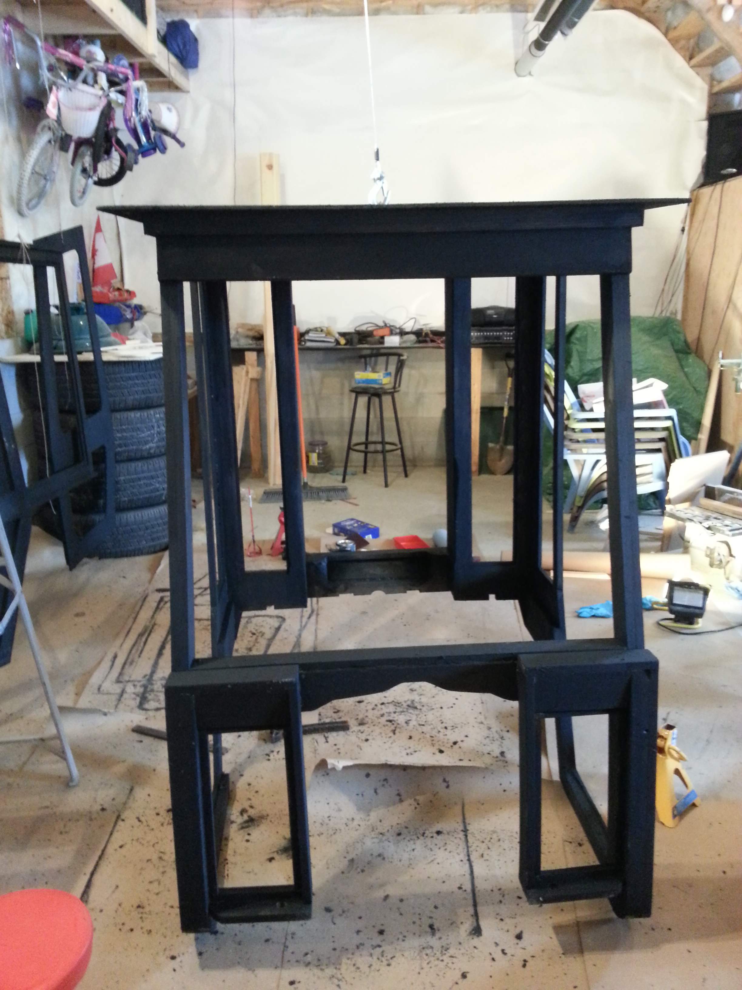

Very nice looking ..............just a headsup, I used wood (hardwood and mahogany) also for my diy cab, but you should be prepared that cab might flex . You may want to try it firmly mounted to your tractor and drive thru some holes and swales or ditch type situations that get different weights on different sides of tractor........BEFORE you put glass in it. I put plexiglass surface mounted on the wood (using screen clips) and at times they still pop loose.............see pics of mine in my Feb post

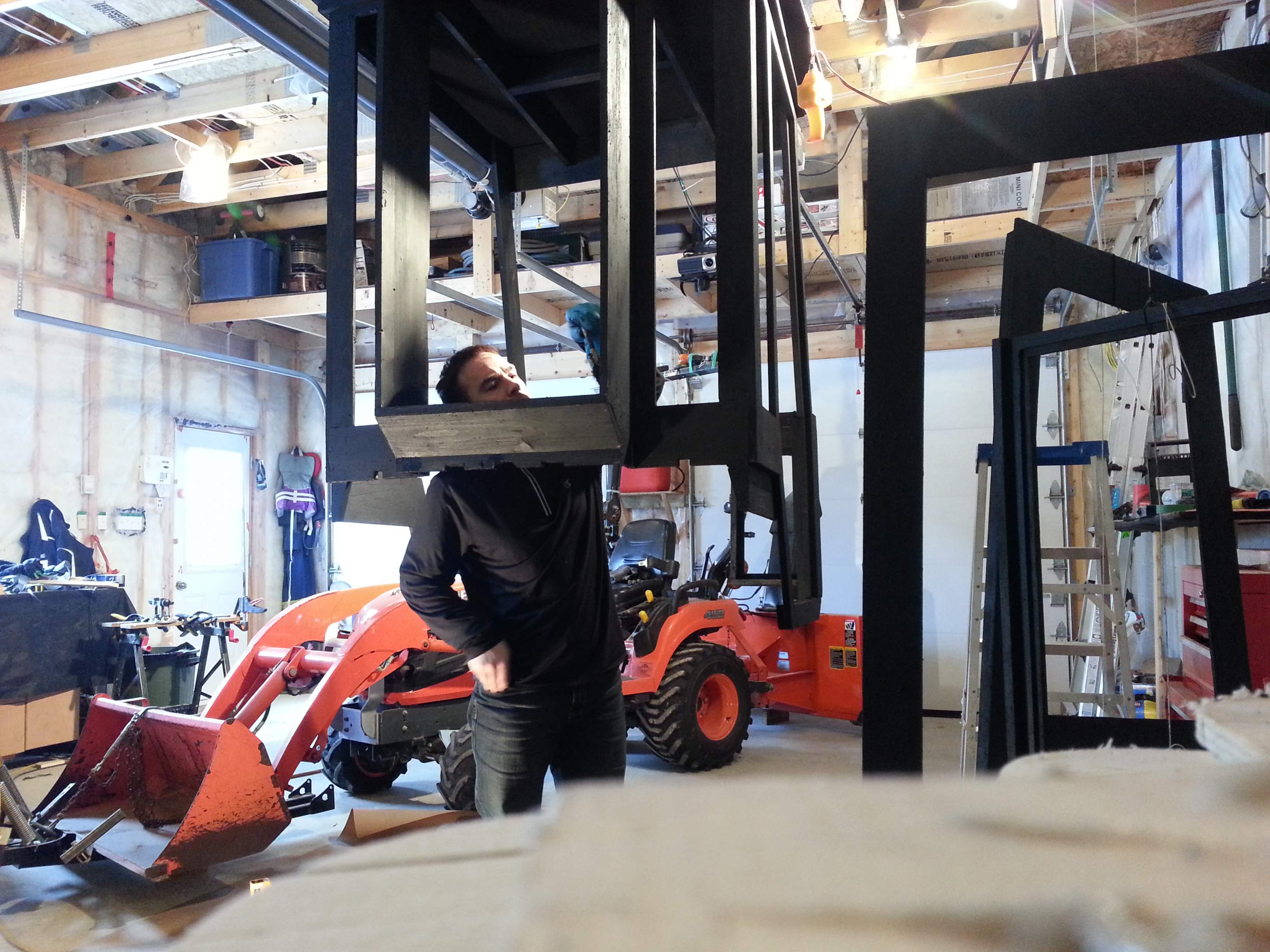

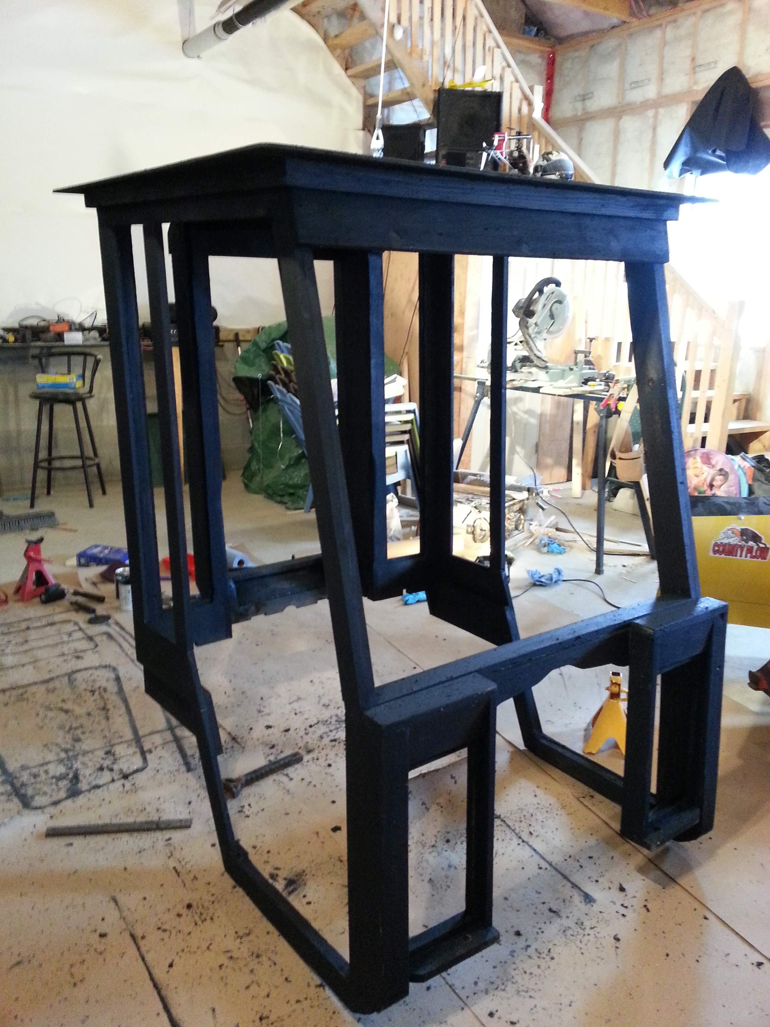

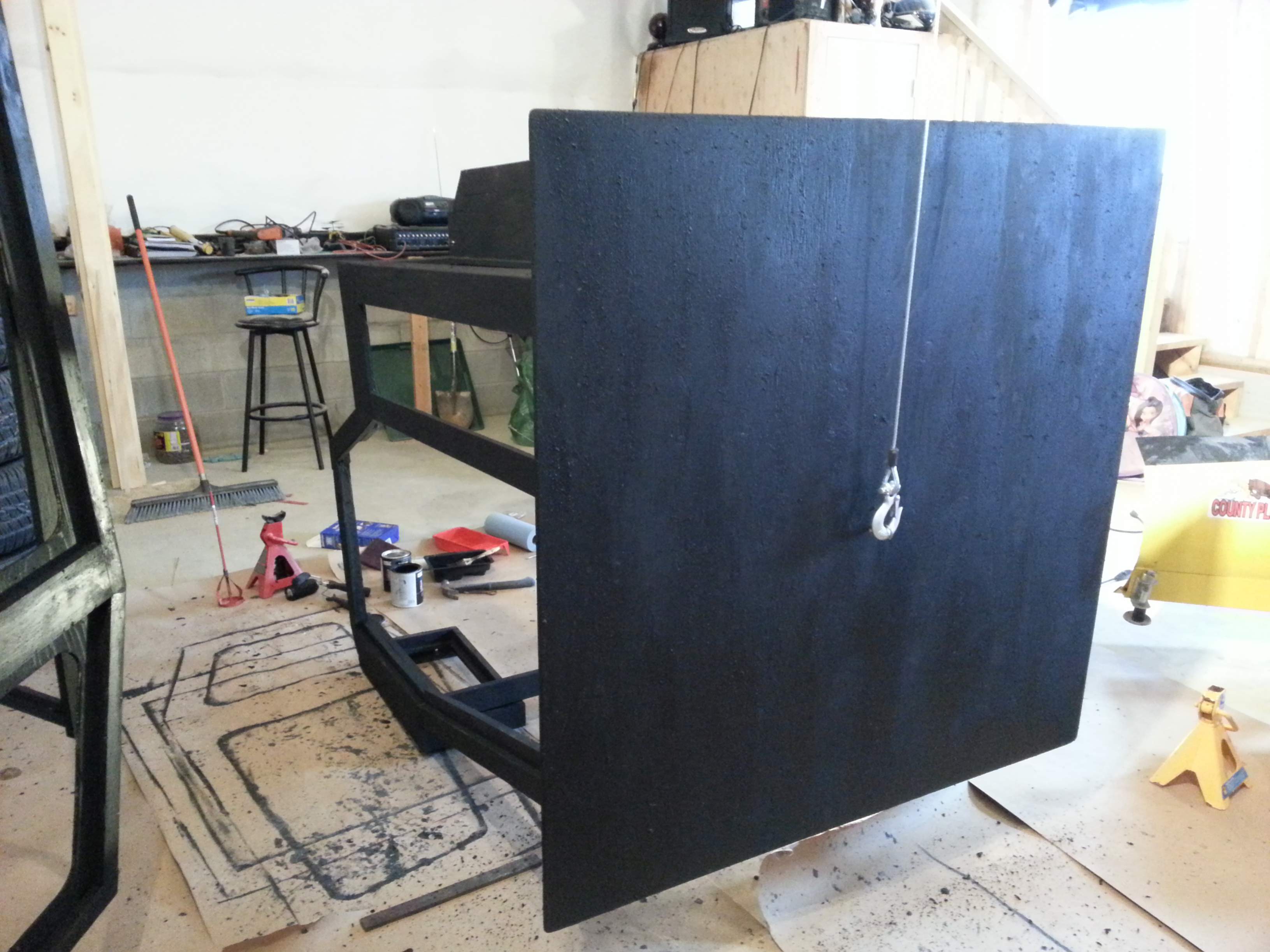

Thanks for the notes folks. I did take the cab out to do some snow clearing a few times before these pictures and while there was some creaking from the wood I think that's normal until I get it mounted really well with the weight of the glass. I'll be looking to get glass installed this week and maybe even a heater before the snow is all gone, ;o). I did two coats of Dupli-Color Bed Armor Truck Bed Liner from Crappy Tire ($40/qrt), that took 3 quarts. It seemed to cover well so I don't think I'll need to do a third coat, I'm still considering some kind of clear coat to add a little shine, thoughts?. The roof is a 4x4 sheet of 3/8 ply, I also picked up a few bits to do some electrical hook ups but haven't got to that just yet. I'm using a 2000lb winch to lift the cab, I think the weight is about 150lbs at this stage. Enjoy.
