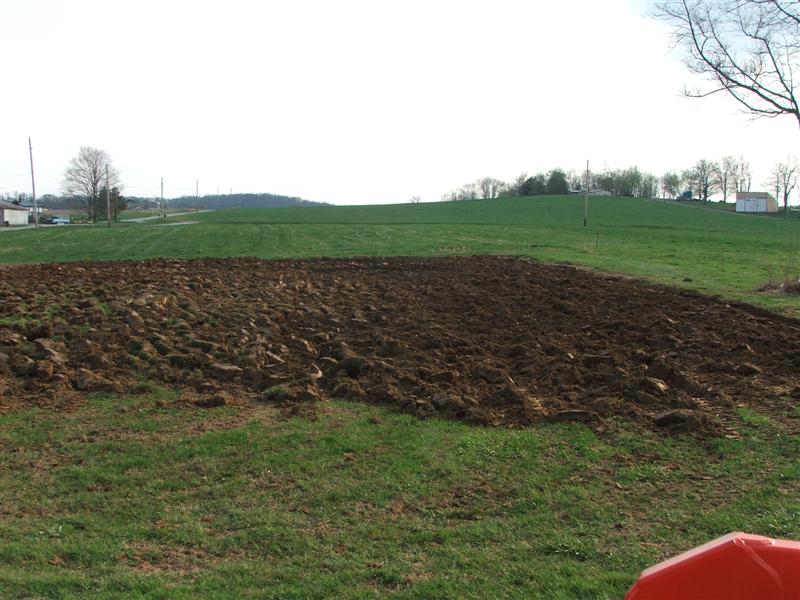

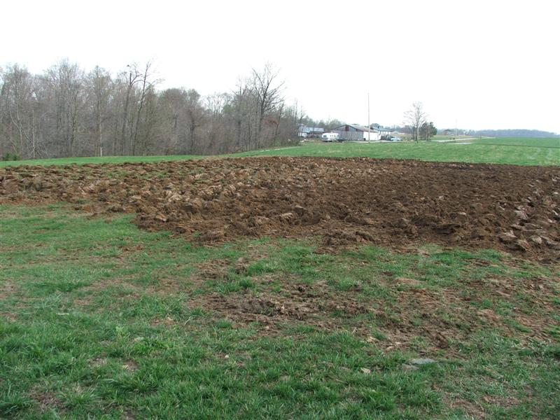

   / BX24 with a 2 bottom plow? #10
milkman how dep do you plow.? from the picture it loks like the couter is nearly as deep as the bottom of the plow. i thought you set that only a couple of in's. .just to cut the sod. and milkman had a viedo on you tube plowing if i remember right.
   / BX24 with a 2 bottom plow? #11
The coulter doesn't run as deep as it looks in the picture, there's a lot of slop in the pivot point on the coulter and it raise up some when in the ground. Picture of the garden last spring that I plowed too wet, probably 6-7 inches deep.
Edit: milkman how dep do you plow.? My son said that is a personal question!!!!:D:D:eek:
