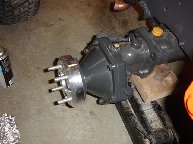

Just a word of warning. If you happen to do any damage to your rear axles there is no way it will be convered under warrenty. Thats a big spacer for that size tractor, and with the weight of the backhoe its got to be mutiplying the force on the castings and seals right where the axle goes into the transmission. I'd be very, very careful.

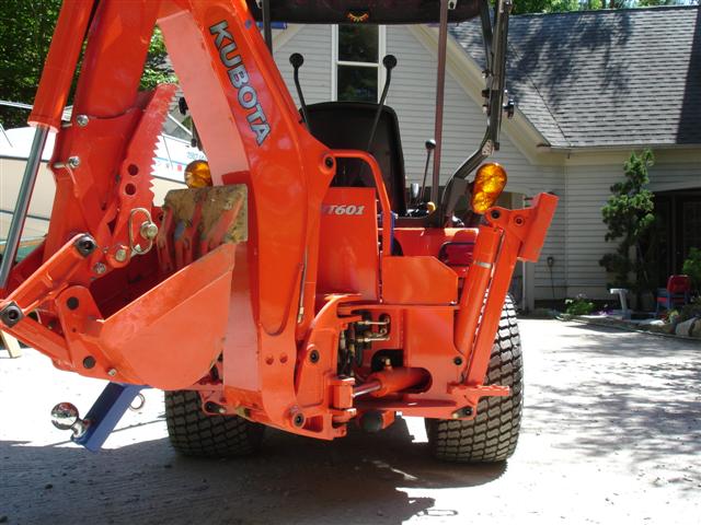

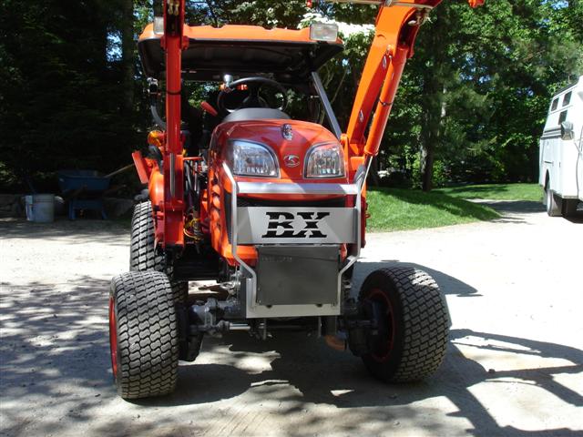

I ordered a rear set and had Richard fabricate a front set also, though not quite as wide. They are aluminum and nicely finished - a note of caution though - I found the studs were not pressed fully in & had to redrive all in with a punch prior to mounting them. Prior to install I would get the creeps at about 15 degrees - now the tractor feels more stable. The rear wheels still track inside the FEL. If you have grades to deal with it's good insurance. You can see the wider stance in the pictures.

Did you notice much difference with just the back spacers on ??

I notice a difference with the rear spacers. Seems much more stable, especially when turning around on a hill which scared the crap out of me before. If I have to replace seals or something it's cheaper than a funeral.

Increased wheel offset is a bearing/seal issue in the car/truck world, and I would think several factors make it more so for our BXes. Axle housing is aluminum, not steel or cast iron. Load is unsprung, and especially with BH mounted, force would be magnified by rough surfaces we operate on. I'd love to have the increased stability...not to mention the look...:cool: ...but I'm concerned about possible damage, especially if I forget to take it slow in the "rough"...
