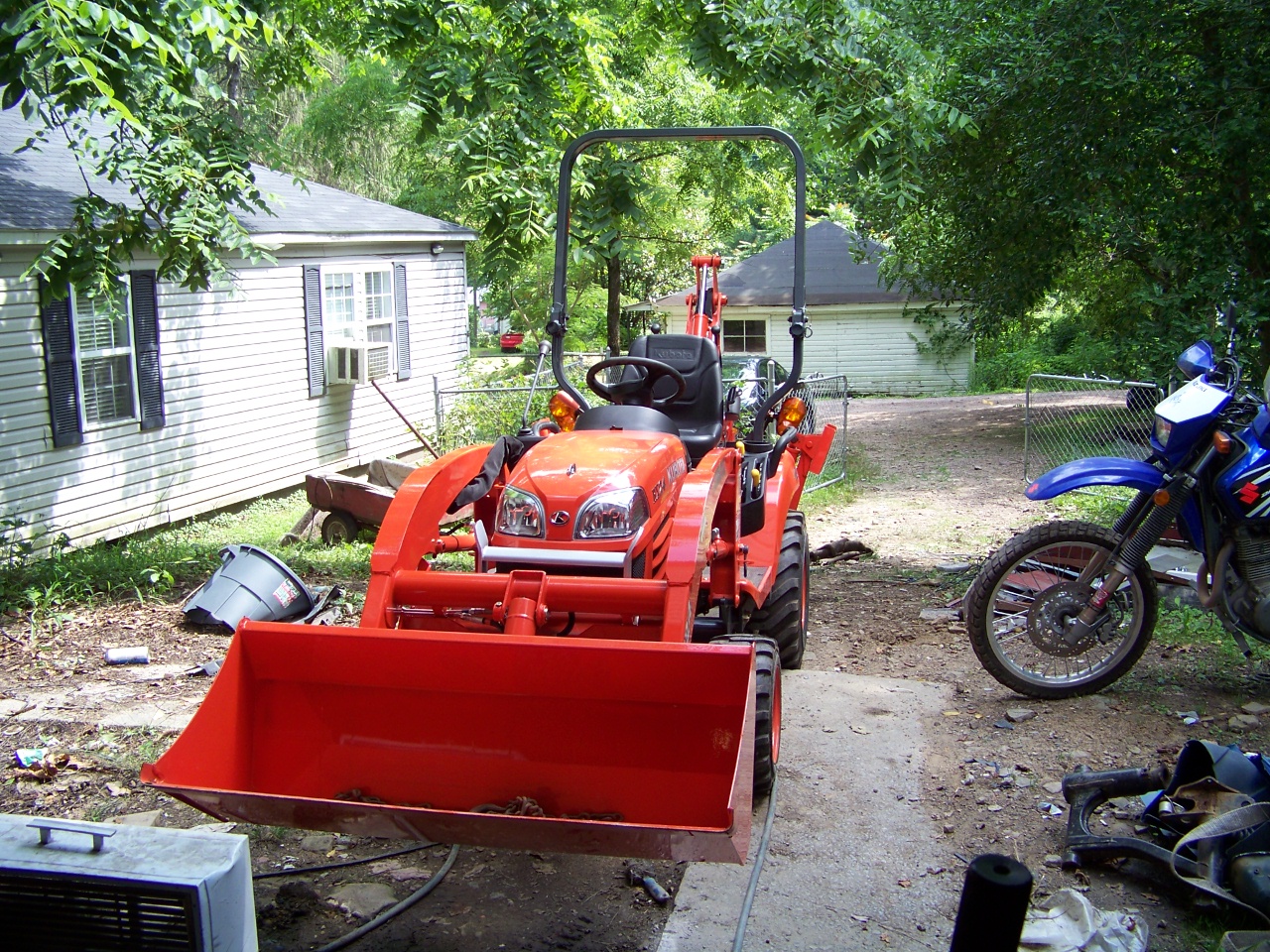

LBrown59: I guess I am going to pass on the mowing deck for the bx for this summer.
The sears mower is cutting grass fine and the bx is getting used for lots of random things now :) I might try and get the deck for it next summer though now that I know it can work without a lot of trouble and it would free up some space in the garage the sears mower is taking up. But for now there is a lot of stuff I didn't even think needed done that is coming up for the bx to do. I have leveled a driveway, pulled up 150ft of chain link, dug a gas line, lifted shingles up to a roof and probably a few more things I can't think of. Been a busy little tractor for just a couple of days of ownership. I haven't even started the stuff I was planning on doing with it before I got it.
