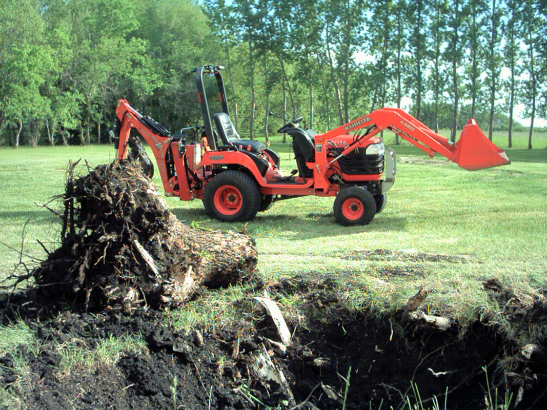

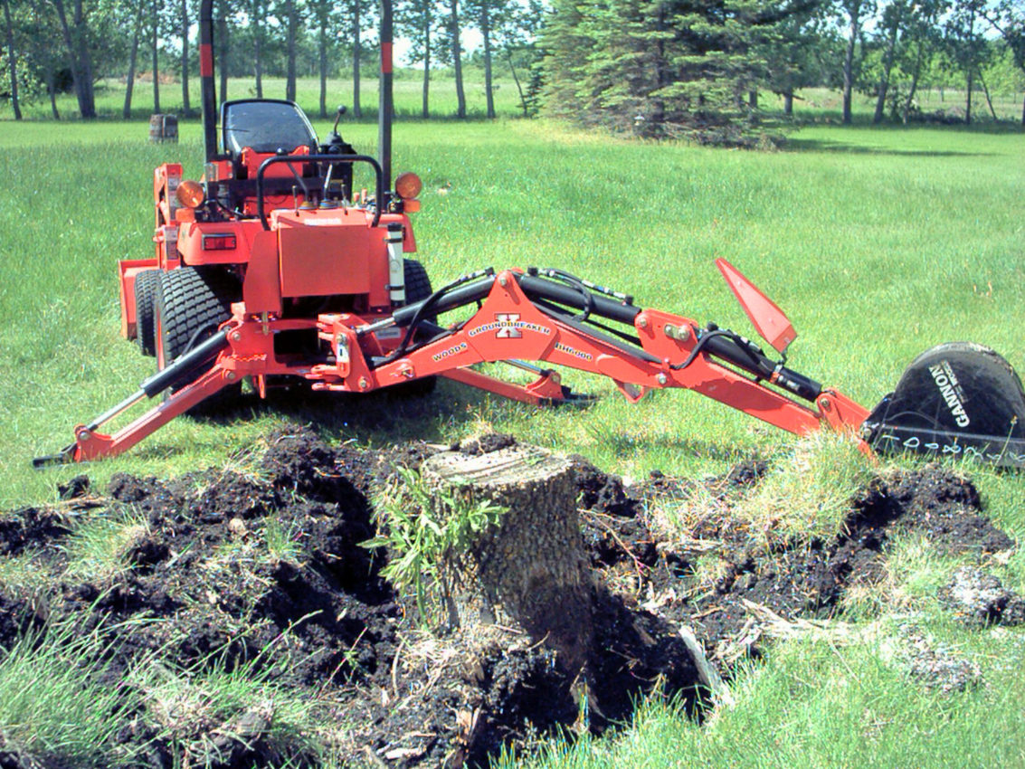

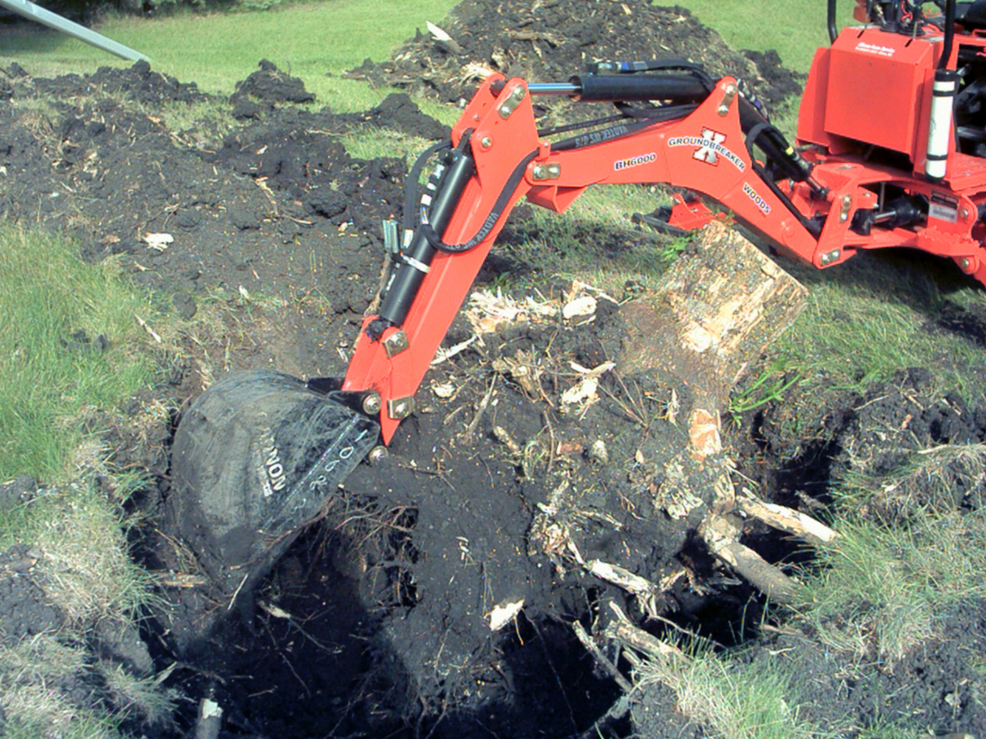

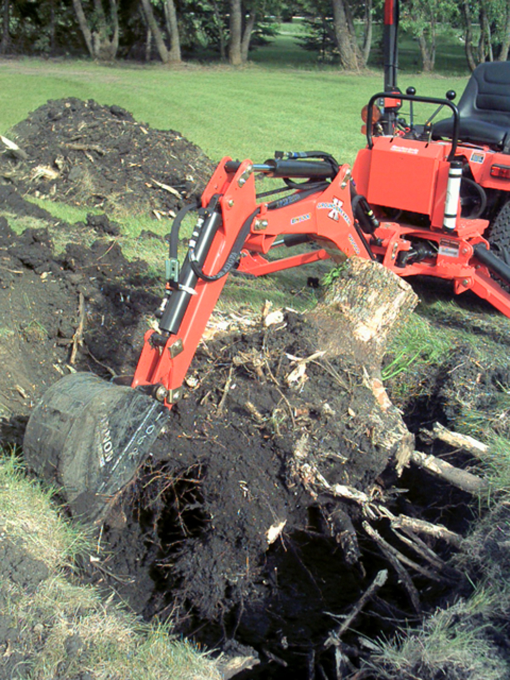

Been there, done that and what an education it was. Mine was about that size and I did quite well curling the bucket and toothing roots to break them. Finally resorted to an axe on the stubborn few that remained...and getting it out of the hole was masterful!:thumbsup:

BX2230 lockport- getting it out of hold is a challege for sure. I dug out a ramp to drive down in hole with to get mine out for one half. Other half I was able to lift with FEL over edge.
Fer sure. I kept curling the bucket under it and get it up a foot and it would fall over. after a dozen attempts I managed to lodge it against the dipper, put the boom in "float" and drive out! :cool2::cool2::cool2::cool2:
