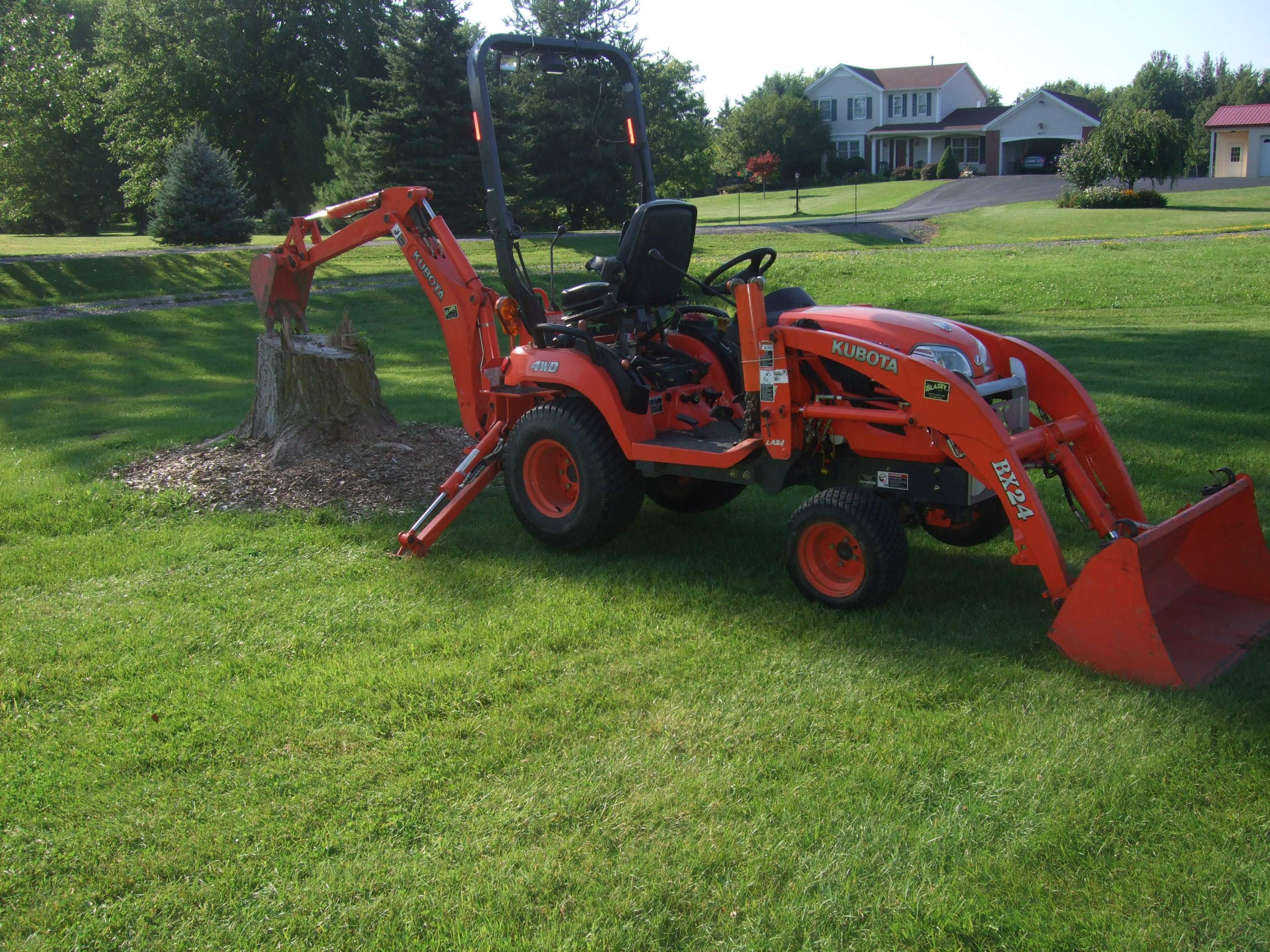

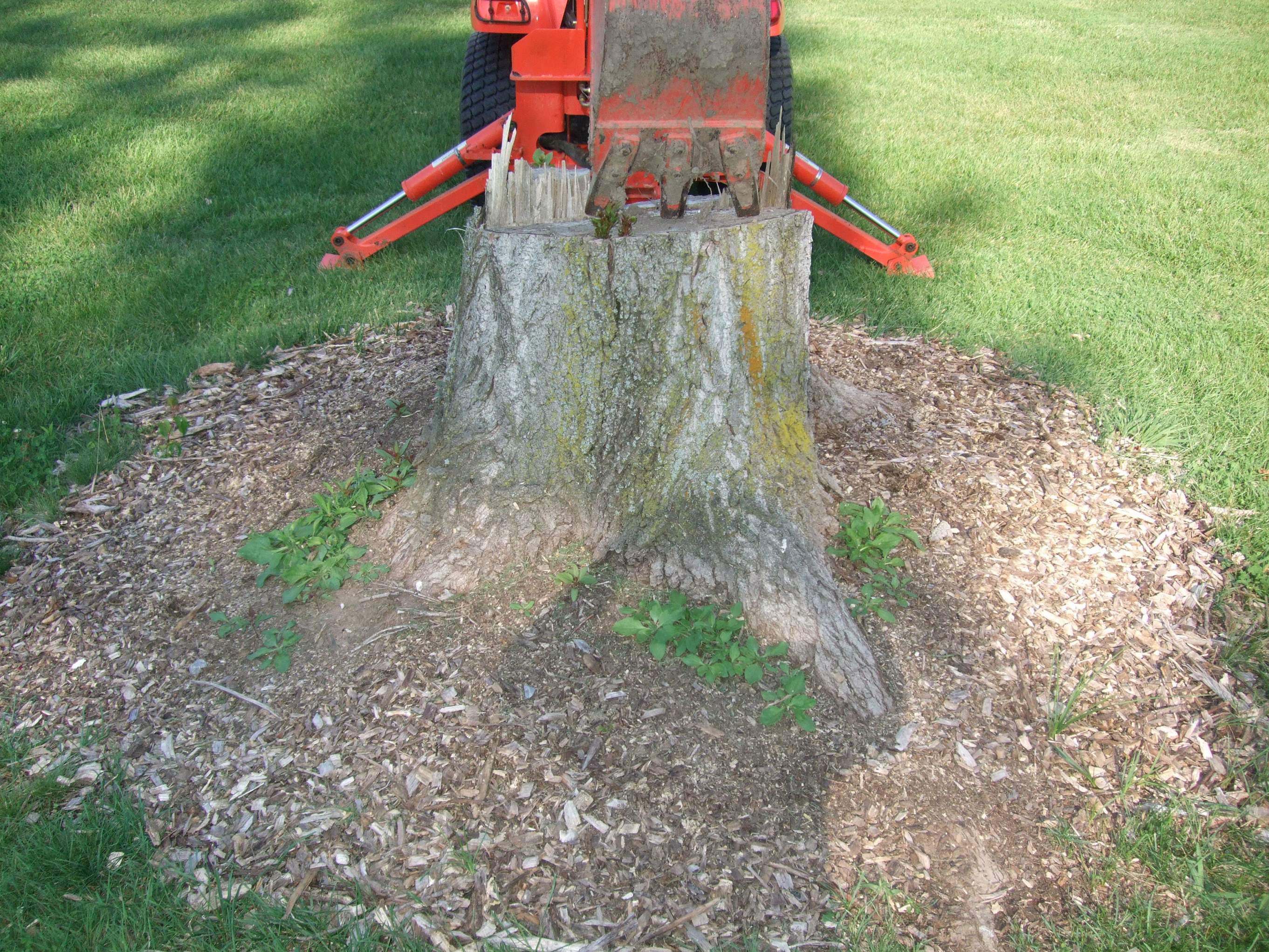

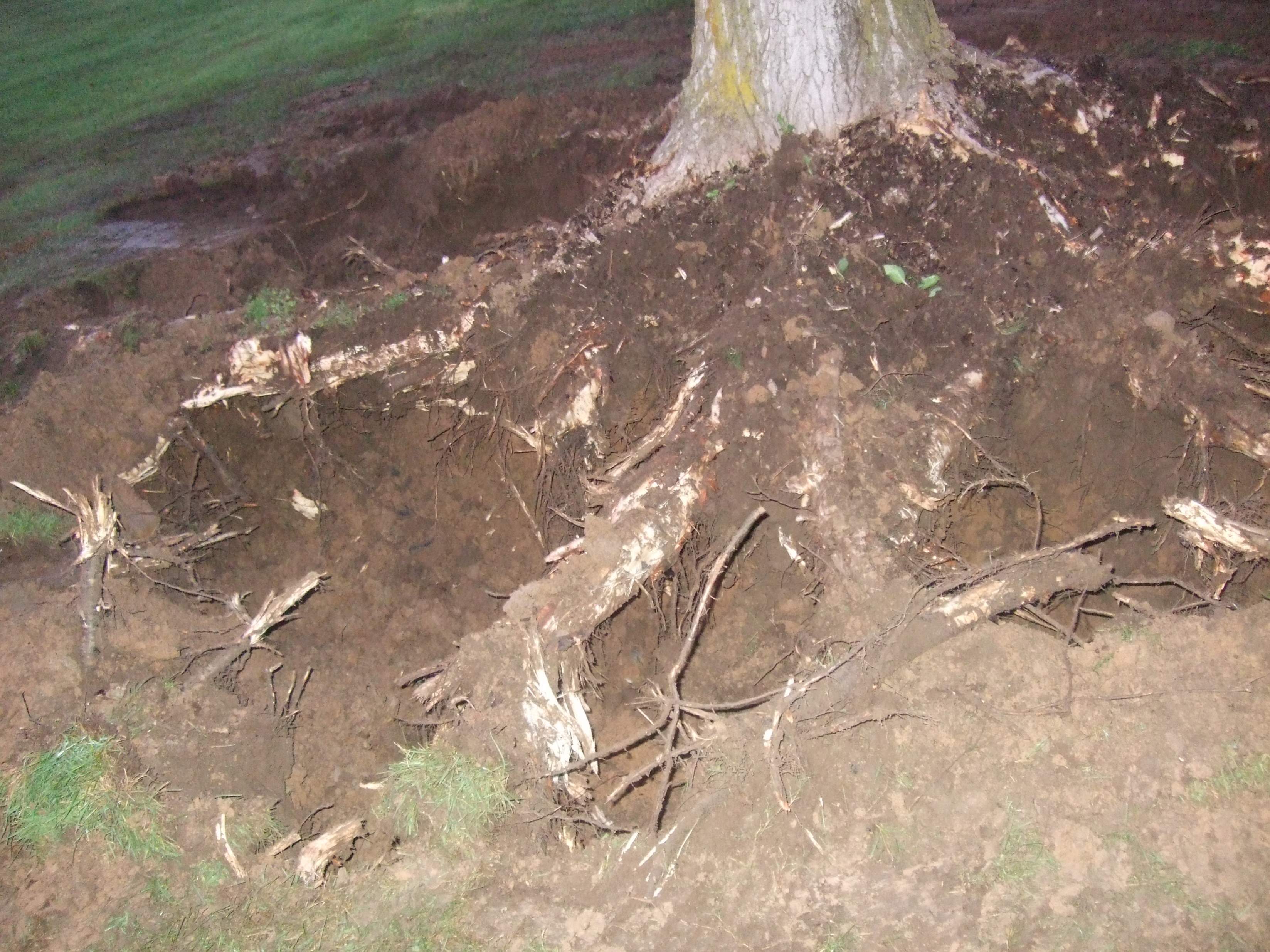

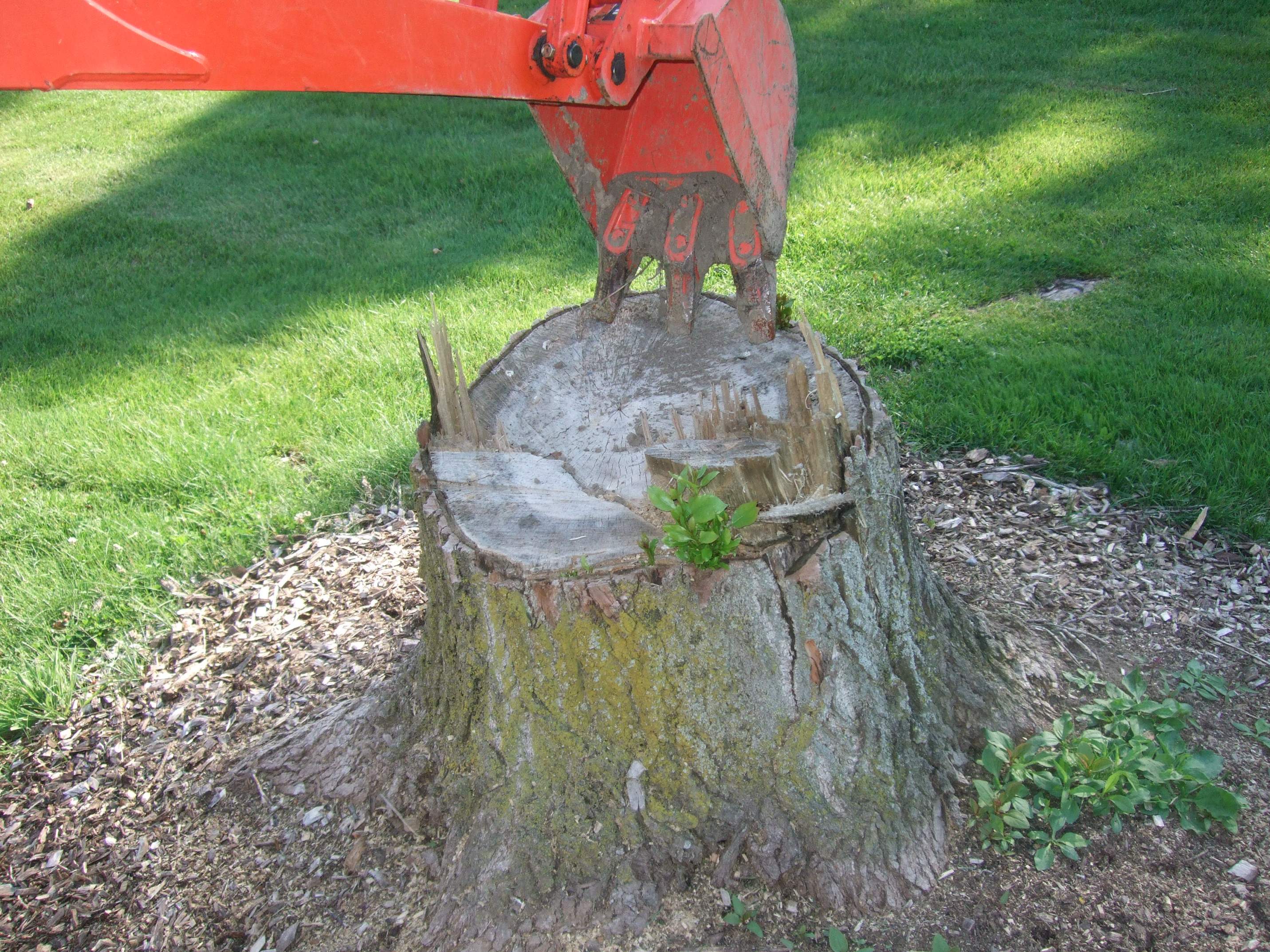

Yesterday afternoon I started digging out the poplar tree stump. Last month I cut down the tree since it was getting too big, and I hated the white cotton crap pluggin up the skimmer in my pool. I only spent maybe 3 hours just chipping away the dirt between the roots so I can cut them away later today. The stump is larger then 12 inches as you can see from the pictures. I put the BH bucket on the stump to get the general size of stump. Its supposed to be hot today, and I am hoping to get it out by noon. I'm gonna get started now after this post and get out there and refuel and grease joints.
I guess you can tell I am having fun. :D

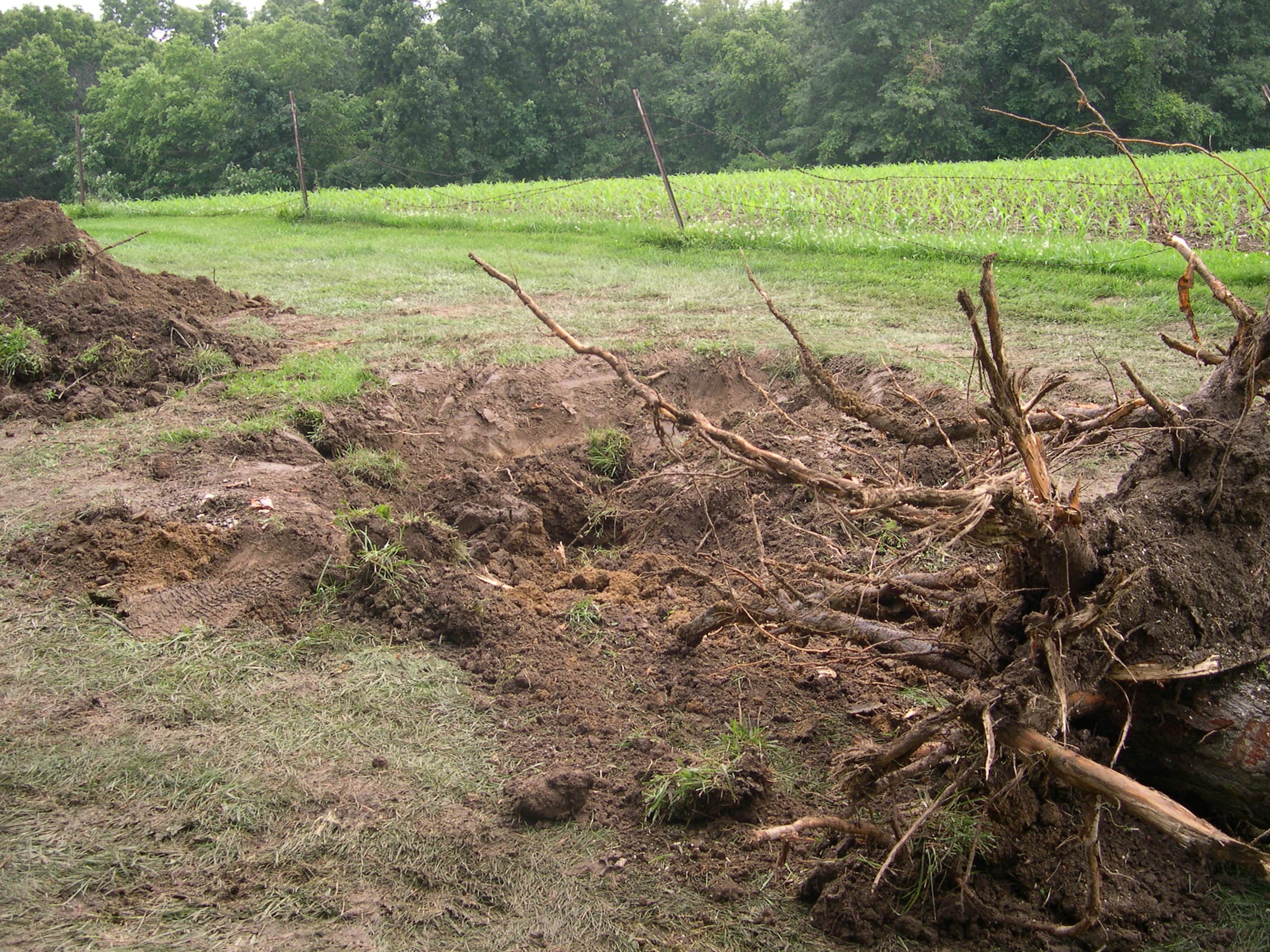

Here's my stump vs. man and tractor pix. I found this old white pine to be the limit of the little BX. It took about 8 hours of digging and hand sawing the vertical roots under the stump that the bucket teeth couldn't reach to remove it from the hole.

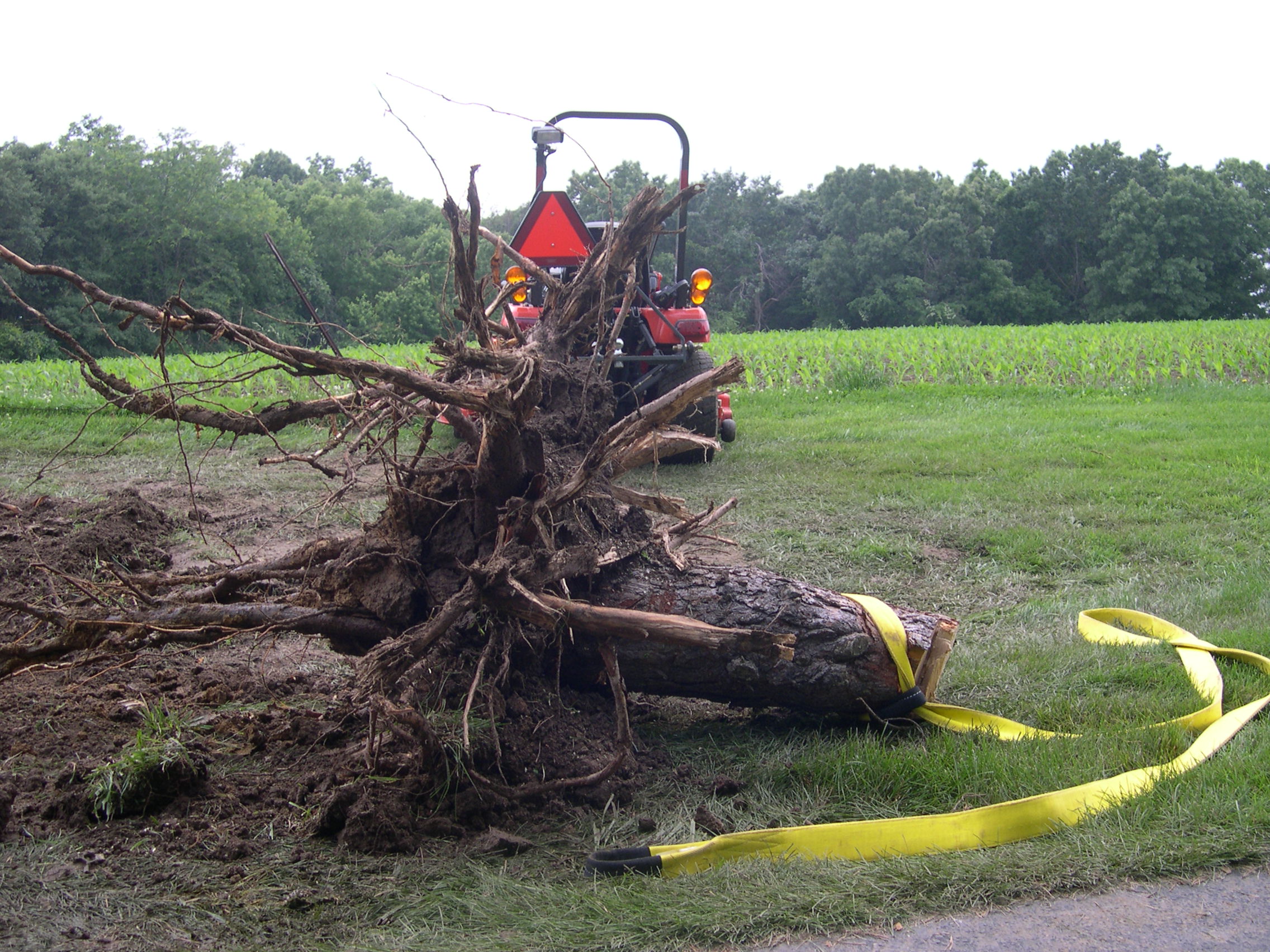

Here is a couple pictures of the stump I dug out with my BX2350. Its not nearly as big as the one picture makes it look, the BX is quit a bit in the distance and this makes it look larger. I'd guess it was about a 12 inch pine tree. I pulled it out with my 4 wheel drive truck. I'd say this took me about 2 to 3 hours to dig out.

Well - here is an update- score :stump 2 BX 0. I was able to clear roots all the way around, wil lnot even wiggle. Great ! gotta be tap roots. ok whats next? hmm as you can see from the picture, One of the cut off roots claimed my tire stem from the front tire. What an irony here! I was just talking about the leaking tire this morning in one of the posts. I was able to limp tractor back to garage with the bucket down as a sled to lift front tire off ground. with the FEL lifting front of tractor off ground, took tire off axle and used the backhoe bucket to pop the bead off rim. Luckily I had one stem left in my drawer for tires stuff and used that to get going again.
A couple hours later, I was diggin out a ramp to clean out the hole near the biggest roots and sure enough, I got a bit too close and the bucket went under the root. I have hooks on top the bucket and it snagged on the root. The seeping water at 2.5 ft down didnt make matters any better. Had to get my trusty homelite mini XL and start cutting the root out when it started to have a bad day too. ARggh! I quickly cleaned carb out with compressed air and got it running again, sharpen the cahin and finished cutting the root out. Ibed crab my way back out with the FEL and BH.
