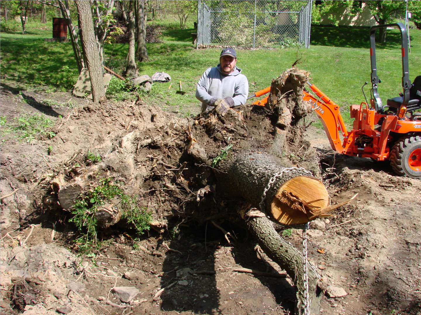

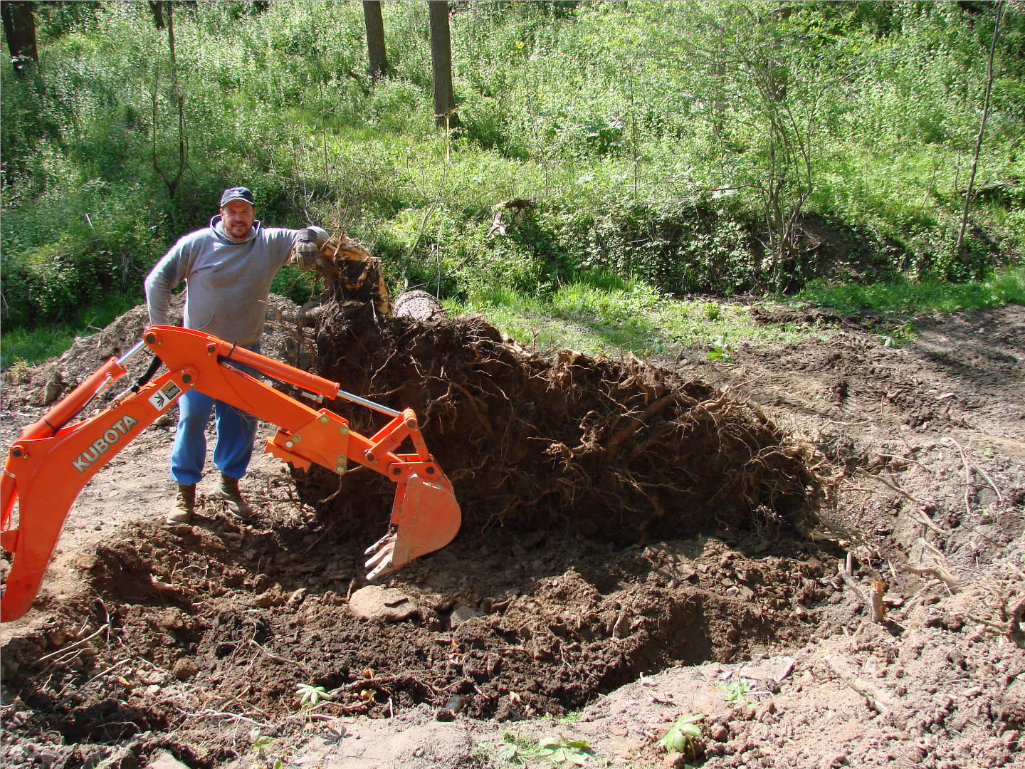

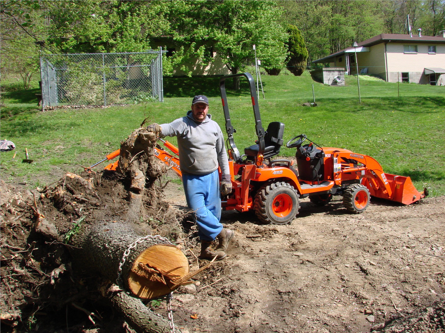

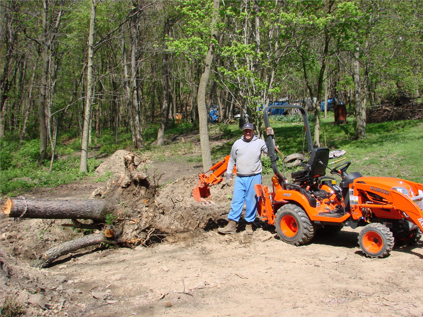

Here are some pics of the stumps I removed in May 2008. The clump of stumps were a large cherry tree and also a tree of heaven. I hate those tree of heavens, they are an invasive species and grow worse then a bad weed!
Took me a while and also even used a come a long to tug on the whole mess.....
