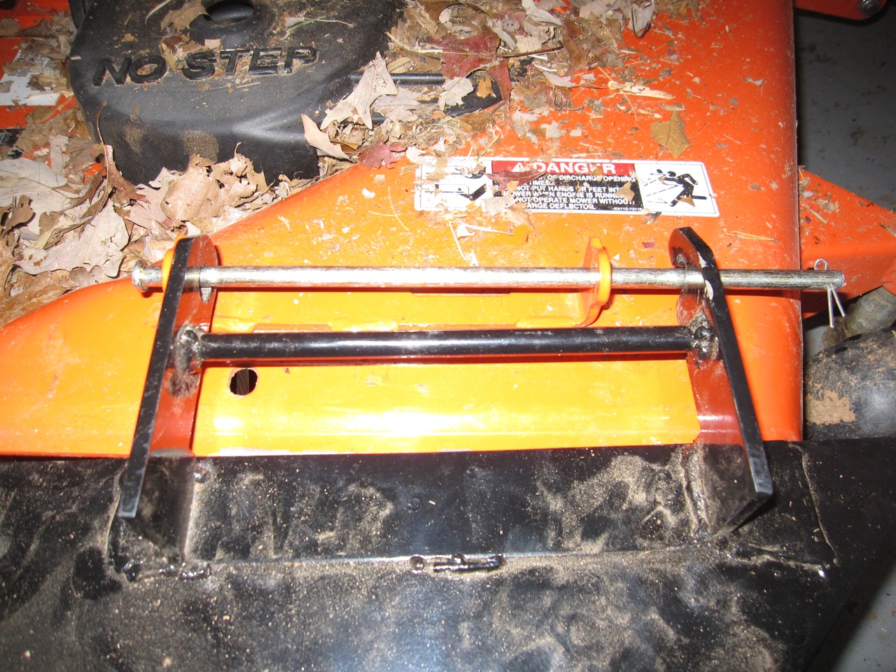

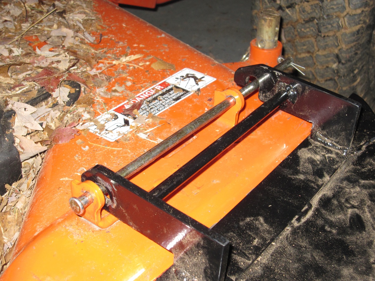

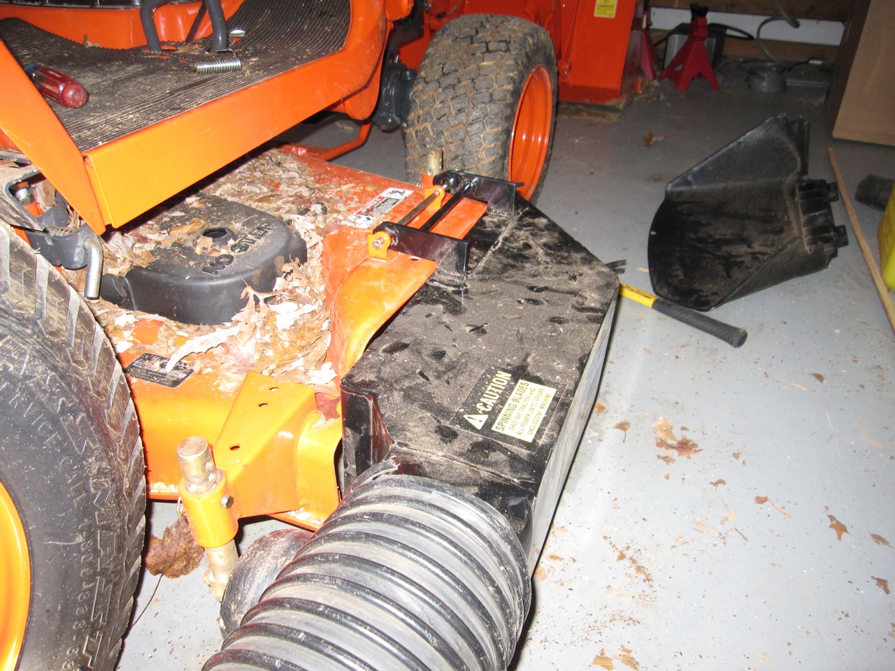

I just got in my deck adapter for the 580. Problem is... I can't seem to make it fit right.
Palmor says to leave the BX's chute deflector in place to provide downforce to help hold the Trac Vac adapter where it's supposed to be. I honestly don't see where there is enough clearance to do so.
The Kubota dealer says to take the BX's chute deflector off. The fit is very good but the Trac Vac adapter's front end keeps jumping off the pin.
Anyone have this setup who can give me further insight? Thanks! :thumbsup:

Maybe some sort of bracket or cord to hold it in place. Like a bungee cord from deck wheel to deck wheel around the boot to keep it in place. A steel bracket would be nicer but that would take some fabrication.
/ Bx2360 with Trac Vac 580
Yeah that might work. For $225.00 you would think it would mate securely though.
/ Bx2360 with Trac Vac 580 #4
I would just make a U shaped bracket that you could either bolt or weld to the under side of the Trac Vac adapter to make the current upside down U piece a full circle. Since the rod just slides through it should be no problem taking on/off.

Put the grass deflector back on. You have the wrong shaft to hold the deflector on. The correct shaft is headless and is held in place with a roll pin. The rear ear of the Trac Vac collector slips over the headless shaft while the front ear hooks over the top of the shaft, and the spring loaded grass deflector holds it down in place. I run this setup, works like a champ.
#9
Hey Ron,
Thanks. That shaft is what came with my 54" deck are you using a larger deck that came with a different shaft I wonder? Shaft length aside, I just don't seem to have enough clearance to fit the collector underneath the grass deflector.

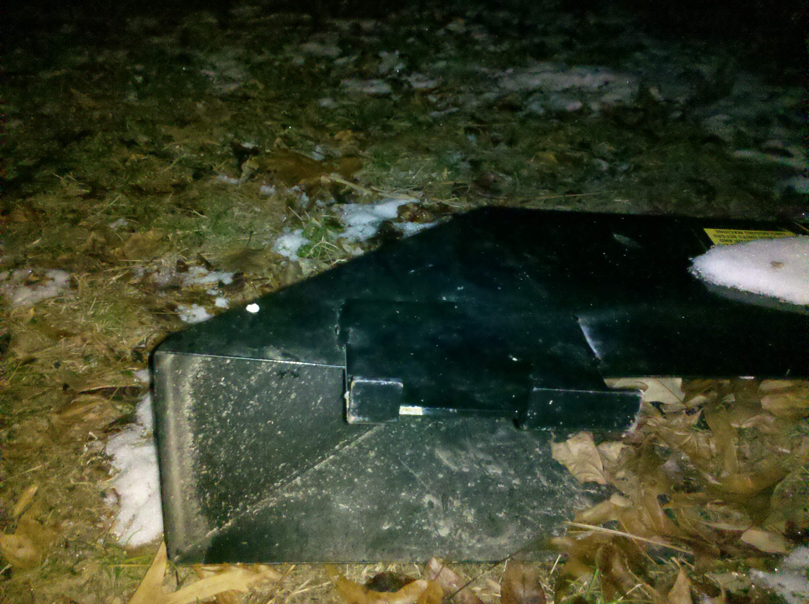

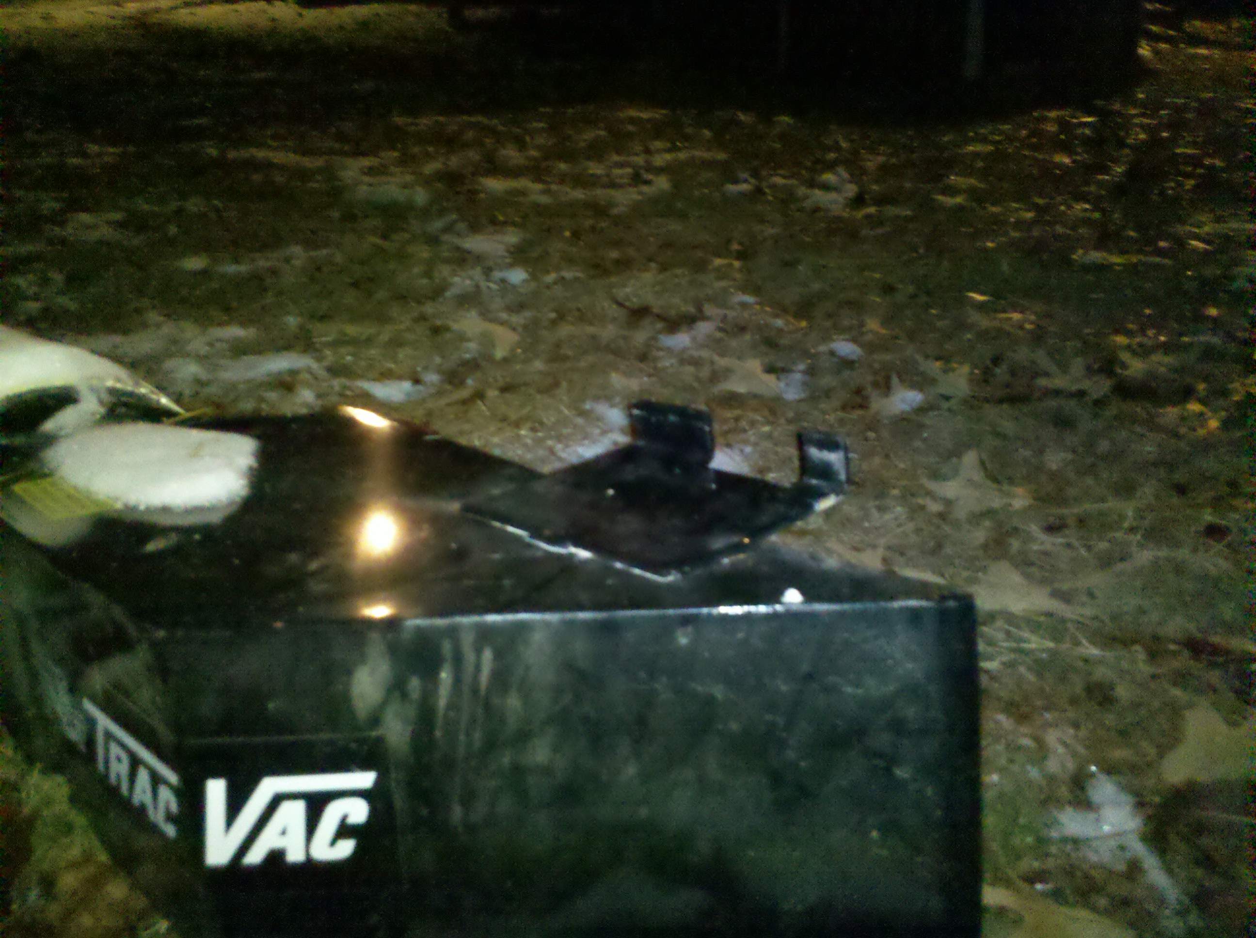

#11
Thanks for braving the cold for the pics. My JD X300 had a similar chute design to yours.
I'm just plain stumped - another 10 minutes working with the thing and I just don't see anyway to leave the grass deflector in place. Taking it off is a bit of a pain, with the spring and all, but if I have to that's what I'll do.

One other thing, I had to grind a little bit off of the front ear for it to fit under the grass deflector. I'll try to find the part number for the correct shaft for you.

I think I solved the problem, and will confirm it later this morning: the wrong adapter was ordered. Check out the attached image, and see if you concur. The part # that was ordered is at the first arrow, the part # I believe should have been ordered is by the second arrow. The difference being that the second # refers to BX series decks.
The right tool makes the job a lot easier!
And the dealer ordered the correct part # for me this morning...
