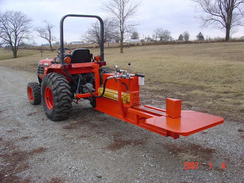

I use a PTO pump on my splitter hitched to my B2910. It's very congested around the PTO shaft area and the pump barely fits. Not sure if there's less room on the BX series?? I tried to find a closeup picture of the PTO pump area but this is the best I could find.
As for splitter speed I really like the PTO pump setup. I use a 21 gpm pump and only run the tractor at 1500 rpm to achieve a 4-5 second stroke speed.
As for weight, my splitter is a "tank". It's indestructable but very heavy. I use 240 pounds of front weights to offset that.
