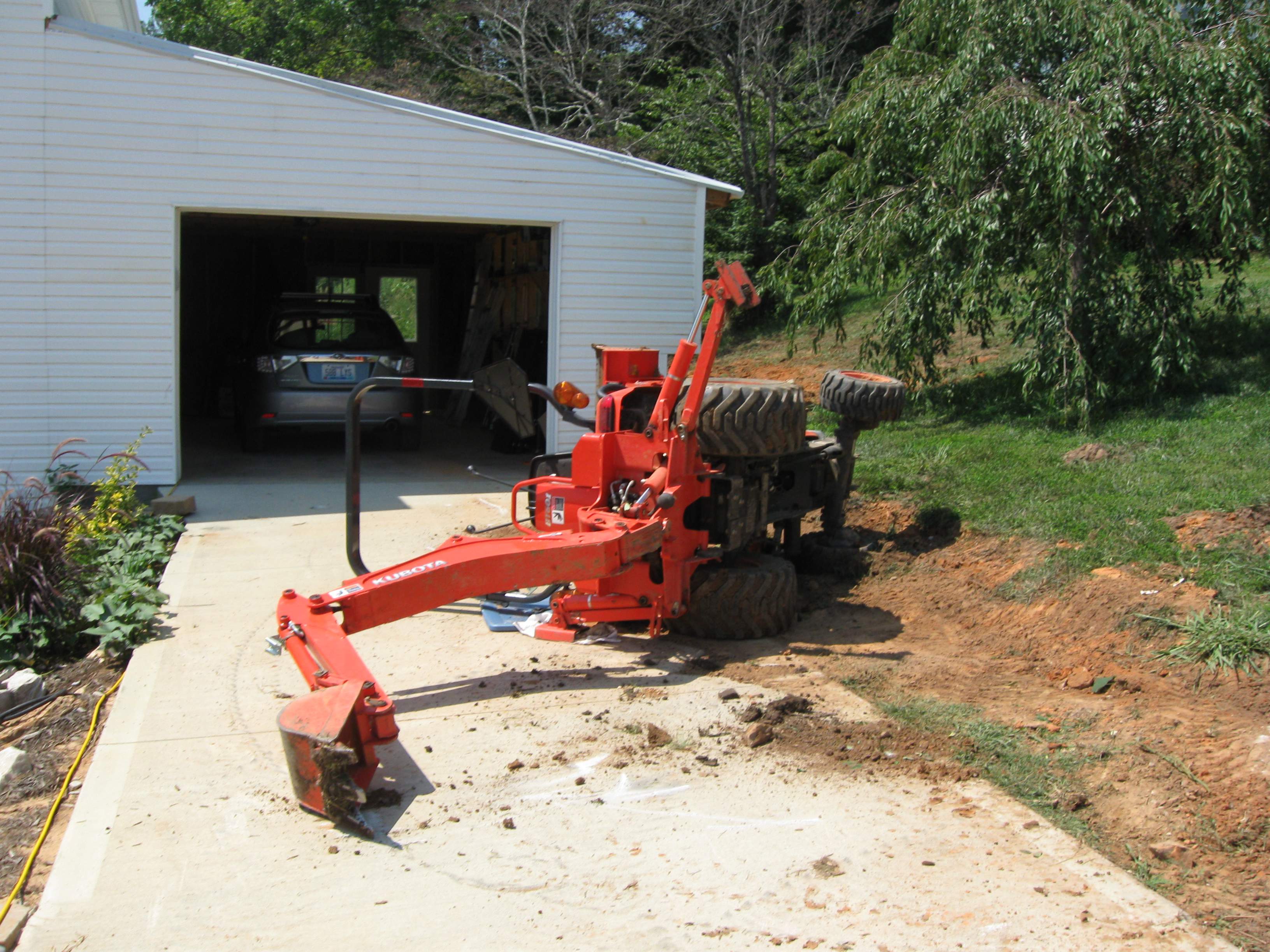

You DON"T HAVE TO CRAWL UNDER IT!!!!!!!!!! Easy to access this way, very little bending or stooping.:D
/ BX2350 HST FAN REPLACEMENT #12
Now John, your tractor even with spacers is still only about 4 feet wide. That means that the fan is only about 2 feet off the ground. I'm close to 6 feet, but not ape arms. That sounds like a fair amount of bending yet to me. :D
You've sure gotten your mileage from those pictures. :laughing:
/ BX2350 HST FAN REPLACEMENT #13
No foolin', I thought that originally he posted he just wanted to scratch the belly of the cute lil critter. :laughing:
