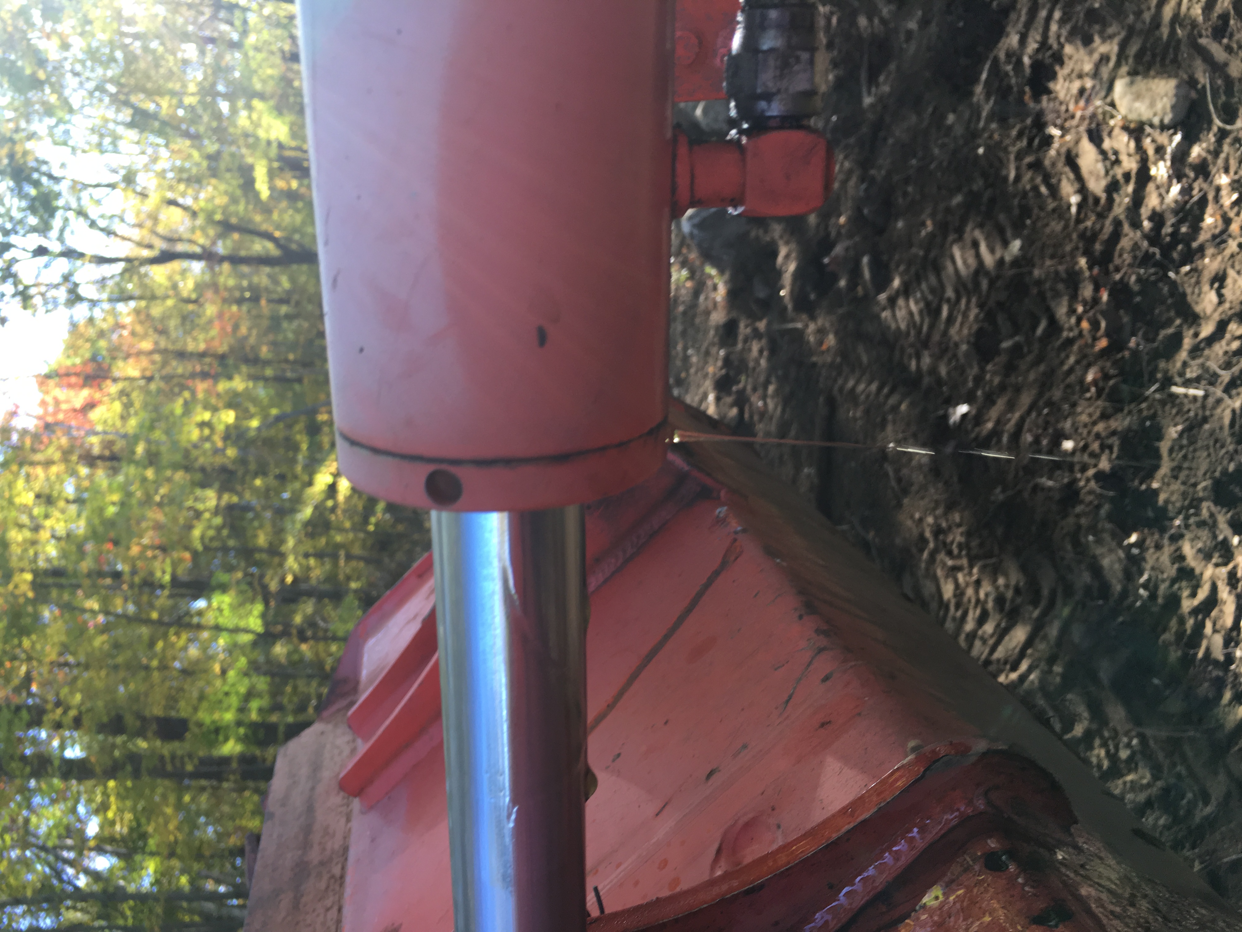

Hi Dave - I'm pretty certain it's coming from the circle area around the top of the push rod. It started a couple days ago as a very small spray that I could see hitting the top back of the bucket. The tractor was just fully serviced which disappoints me and I am wondering with new hydraulic fluid and filter the pressure increased as it did not do this before servicing. My BX23 has about 450 hours. The leak got worst through the day and poured out when I curled the bucket. If I raised or lowered the bucket leaving in a stationary position while using the BH, it would slow and to stop. The moment I moved the bucket it would pour a solid line of hydraulic fluid. I will try to post a picture. I've been working in a heavy rocky soil moving an old stone wall, but as I said the spray was immediate when I started working after taking delivery.
   / BX23 Cylinder leaking LA210 - rebuild or buy new?
Here is a picture - if you look carefully you can see the stream of fluid falling
   / BX23 Cylinder leaking LA210 - rebuild or buy new? #5
From what I see on messicks.com your bucket cylinder is a single cylinder not a pair which makes things much cheaper and easier.
This is the exploded parts illustration.
The cost of a seal kit is about $42 depending upon the serial number of your tractor as there was a production change in the manufacturing.
That circle area around the pushrod is actually the end cap of the cylinder #40. Note the round hole in the side of the end cap in your photo.
Dealers who do a lot of hydraulic work will have a special tool that inserts into the hole and unscrews the end cap.
Regular people use a pipe wrench to unscrew the end cap. I have done that many times. It scratches up the end cap but that was never a big issue for me and may not be for you.
The important part of taking the end cap off using a pipe wrench is to protect the chrome shaft. Wrap rags securely around the chrome shaft so you don't have the wrench slip and then the chrome is scratched which is bad news.
Unscrew the end cap a bit while still on the tractor as it will take some serious leverage to get it to start turning. The ends attached to the tractor will act as a vice to secure the upper end of the cylinder from turning.
The lower end of the cylinder with the chrome shaft will pull out when the end cap is unscrewed.

You might be overthinking this. It's easy. If you can perform your own oil changes you can remove a cylinder. Should take 5-15 minutes.
1. Lower loader to ground and shut off engine.
2. Move loader control valve in all directions to neutralize energy.
3. Remove hoses with crescent wrench or open end wrench. Use a backup if necessary.
4. Remove cotter pins or whatever keeps pin in hole.
5. Using a brass drift and hammer, drive pins out.
6. Remove cylinder from machine.
7. For extra credit - manually extend and retract the cylinder SLOWLY to let the fluid out and keep fluid off of your vehicle. The hydraulic shop will appreciate this.
8. Plug hydraulic ports to keep out dirt / debris.
Take the cylinder to the hydraulic shop. No need to order the parts from Kubota as they likely can get the proper seal kit for cheaper. Expect to pay between 65 and 120 dollars for the rebuild. Rebuild should be as good as a new cylinder.
You need to have a relationship with your local hydraulic shop, anyway. They will be your source for hoses and other fittings.
Installation of the cylinder is the reverse of removal. The air from the cylinder will self-bleed. Just install the cylinder and work the loader controls until things smooth out.
