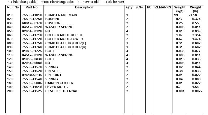

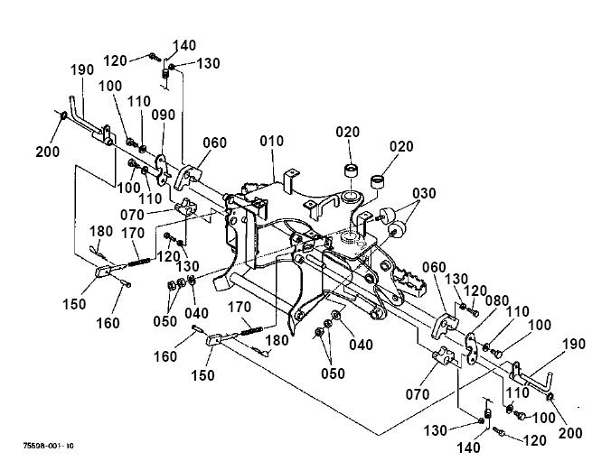

There must be dirt, rust or some other contaminate thats gotten down into the mount lever or holder mount (clamps). It's possible the lever may be bent but I'd suspect some sort of debris is jamming up the works.

It was over a year ago, so I don't remember exactly, but I believe I just took out the 2 bolts, removed the cover, and pulled the links off the big pivot pins. I was then able to clean the pivot pins, links, etc. I used some 220 grit sandpaper, along with WD40 to clean everything up good and smooth - the rust had really roughed up the pins. Once I put it all back together, cleaned and lubed, it was amazing how easy the backhoe was to put back on the tractor - the links actually sprung open and closed on their own.
My neighbor bought his machine used from a farmer off ebay who outgrew it, so it did need a little TLC - he did most everything else, but after we were comparing notes on how difficult the backhoe was to attach & detach, that's when I decided to pull the links apart. Before doing that, the tractor was up, down, hammer tapping, backhoe up, down, all sorts of stuff to get the backhoe on.
Just go ahead and pull the links apart - it's an easy job, and that way you can actually remove the rust & crud that's in there. Do one side at a time, if you're worried, so you have a properly assembled one to reference if you forget where all the parts go back on the one you've dissasembled, cleaned, and lubed.

Thanks for the help guys. If all goes according to plan (never does), I will hopefully complete the 200'+ field drain I am putting in this weekend and be able to disconnect the bh to take another look. I had it off last weekend, but opted to just get it back on, instead of trying to pry the one troublesome link off without knowing if that would be wise. It looks by the diagram and some first hand knowlegde that I should be able to take that link off without any harm being caused. If rust is the culprit, I will have to add spraying a lubricant to the links as part of the maintenance.
