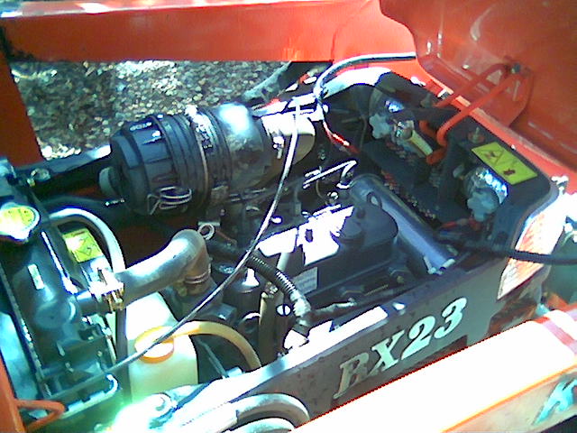

Not a big deal but wanted to chime in because ... who knows ...
Bought "baby" in Dec'04, new. Did regular service my self. No real probs otherwise.
In the attached pic, note a cord holding the air filter in position. It has been happy for some time now, so am I.
Just changed the motor oil. Have been using Delo 15-40w right along.
May change hydro oil tomorrow or, soon. Been running filter change at 200 hrs and oil chg at 400 hrs.
I only hose her off prior to doing servicing. Yep, never waxed, etc.
ALL lubing happens when I feel like it w/ Stalube moly extreme pressure grease ... try not to go more than 100 hrs though. For the record, no bucket-flop or other goofy stuff.
Everything just works like it did new. That's why I bought a Kubota.
All my junky attachments that I cobbled together, ie, pallet forks, brush forks, BH thumb, gauge wheels, etc, etc, are all alive and well and providing their intended service when called upon.
A man just has to know how to maximize a small machine :)
Life is good.
Cheers!

I got the hydro serviced today. Same as usual: oil looks just like new, a very small amount of small chips on the sump screen. I'll have to work it some to see if the hydro is a bunch quieter, as it usually is after a filter change. I may got to filt chg at 100 hrs and keep oil at 400.
Also checked the valve lash. All accepted a .006" feeler but not a .007" ... except one that took a .008" feeler easily. I tightened it to .006".
Notes:
The shank below the threads on the glow plugs is a very tight fit in the head and requires yanking.
The valve cover requires real yanking to remove once the nuts are off.
There are little copper washers under the valve cover nuts. I didn't realize that and got to make 2 (out of 3) new ones. They fell to somewhere ... and the diesel motor that can destroy and air filter bracket due to vibration, could not rattle the them free from whereever.
Now I'm considering actually changing BOTH fuel filters. I only changed the rear one at 400 hrs. But, after reading Escavader's probs doing same, I'm apprehensive ... ambivelent ... and now bordering on apathetic ;)
/ BX23 ~1000 hrs
I got both fuel filters changed. Have fingers crossed, but so far, it started and runs fine. The front one was only as bad as I had hoped but not as bad as I had planned for ... wish I had teeny tiny hands.
I drove it around a while: As I, and others, have mentioned in past threads, changing of the hydro filter is like night and day regarding the "whine" and general hydro noise. I will either move to every 100 hrs or maybe 150 for the filter.
Under carriage (all things under tractor) cleaning note: When I service, I spend a bit of time spraying the under carriage but, only via squatting and reaching under and spraying up underneith, blindly. During service today, I noticed a wad of dirt stuck to the frame, etc above the top of the hydro fan. While de-greasing the diesel from the filter change, I layed on the ground and specifically sprayed off that whole area. ... should have paid attention to that in days gone by. Danno, take a note.

I didn't change the gasket as it is an o-ring type recessed into the cover. I could definately feel it compress as I tightened the 3 nuts. Seems good to go and no leaks ... yet
