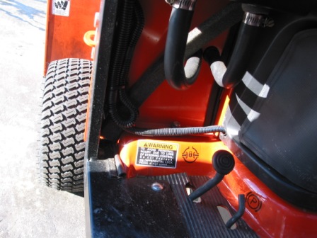

I installed the Tiny Tach on the joystick control. It is right below the throttle and I can see it well.

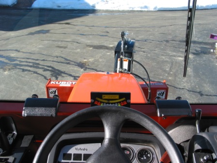

#42
I mounted the Tiny Tach with angle steel to an existing bolt on the tower. I tilted it slightly towards the driver.

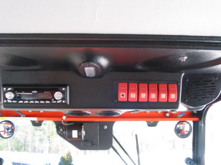

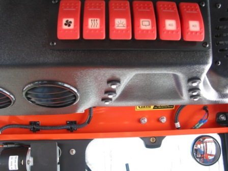

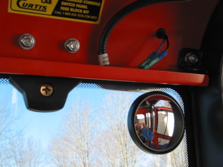

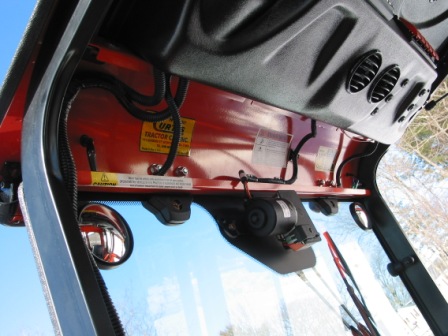

#43
The other wires you see here control my Electric chute rotator. They go to the switch box that contains a single pole double throw switch from Radio Shack.

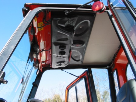

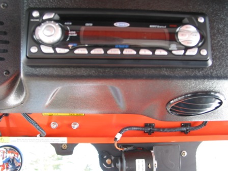

#44
Another look.

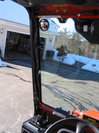

#45
And another.

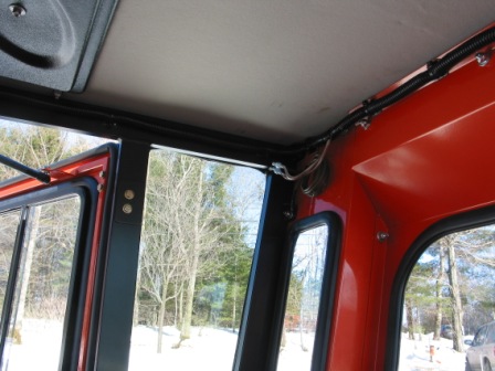

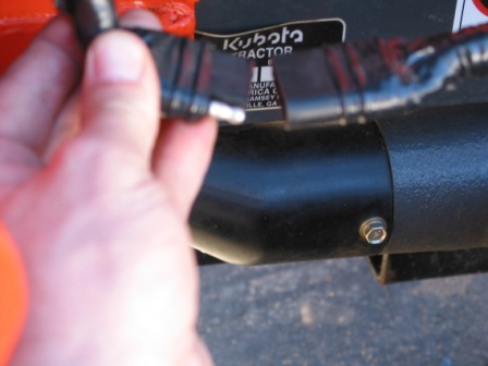

#46
The cabling routes out towards the blower. Below the hydraulic quick disconnects I put a trailer harness assembly.

#47
In the summer, I will simply unplug it and put a cap on it.
