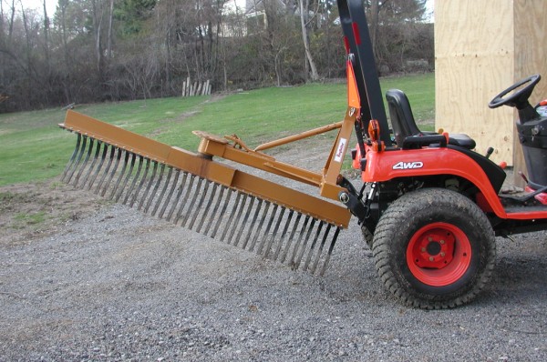

While the BX 3PH is on the small side, to say the least, it can work with full sized implements. One thing that makes this possible is to drill new holes in the lower clevis of the lift rods, so the lower arms will lift a bit more. There are threads in the archive about doing this. It is a simple modification.
I share some implements between my BX and B2910. I have no desire to use the smaller BX specific implements on the larger tractor, so it I use what I got or don't use them at all. Granted the 5' brush hog is not usable with the BX...
Attached is a picture of a 6' KK landscape rake on the back of my BX after I made the modification mentioned above. Before I made the modification, I could not swing the rake around as the tip hit the ground. Now I can swing it around without problem.
Standard implements CAN work with the bx 3PH as the picture proves to some degree. The real limitation is the trator, as it does not have the same ability to put the power to the ground as a larger tractor with the same HP does, or might, to take the middle road...:)
I'm searching, but not finding. I take it you just drill holes as far up in the clevis as possible?
