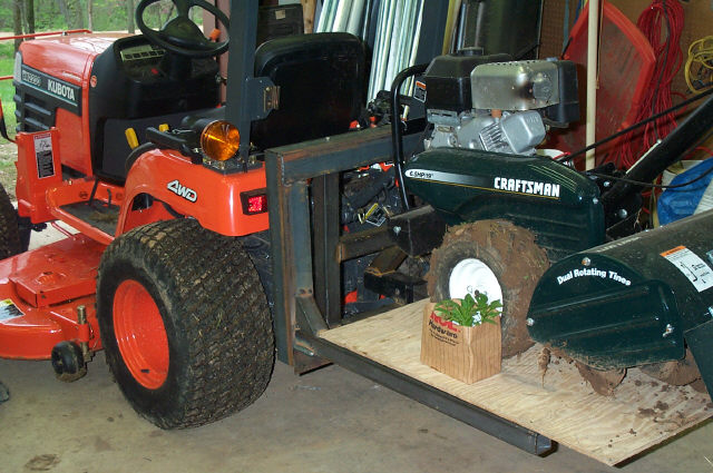

/ bx2200 tiller #4
This tiller does not seem to bog the BX down at all!/w3tcompact/icons/laugh.gif
See attachment.
