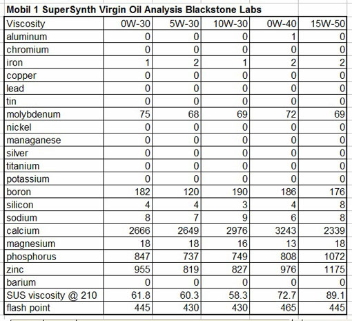

Brian --Mobil 1?? Say it is not soo. ZDDP is pooooooooor.
Since 5w-40 is not on the list (below): Looks ok since it has Moly in it and a good TBN. Again ZDDP protection is not really that good, to me. With these #'s Motorcraft 15W-40 is better. I do not know what you are paying for the M5w-40, but if over 8 - $10 for 1-gallon, it is too much.
From BlackStone, Virgin 5W-40 Mobil 1
Copper: 1
Iron: 2
Chrome: 0
Lead: 0
Aluminum: 1
Silicon: 7
Molybdenum: 0
Sodium: 1
Calcium: 2246
Tin: 1
Potassium: 0
Magnesium:446
Zinc: 1058
Water: 0
Phosphorus:958
TBN 12.9
Boron: 55
Viscosity:75.7
Flash:435
