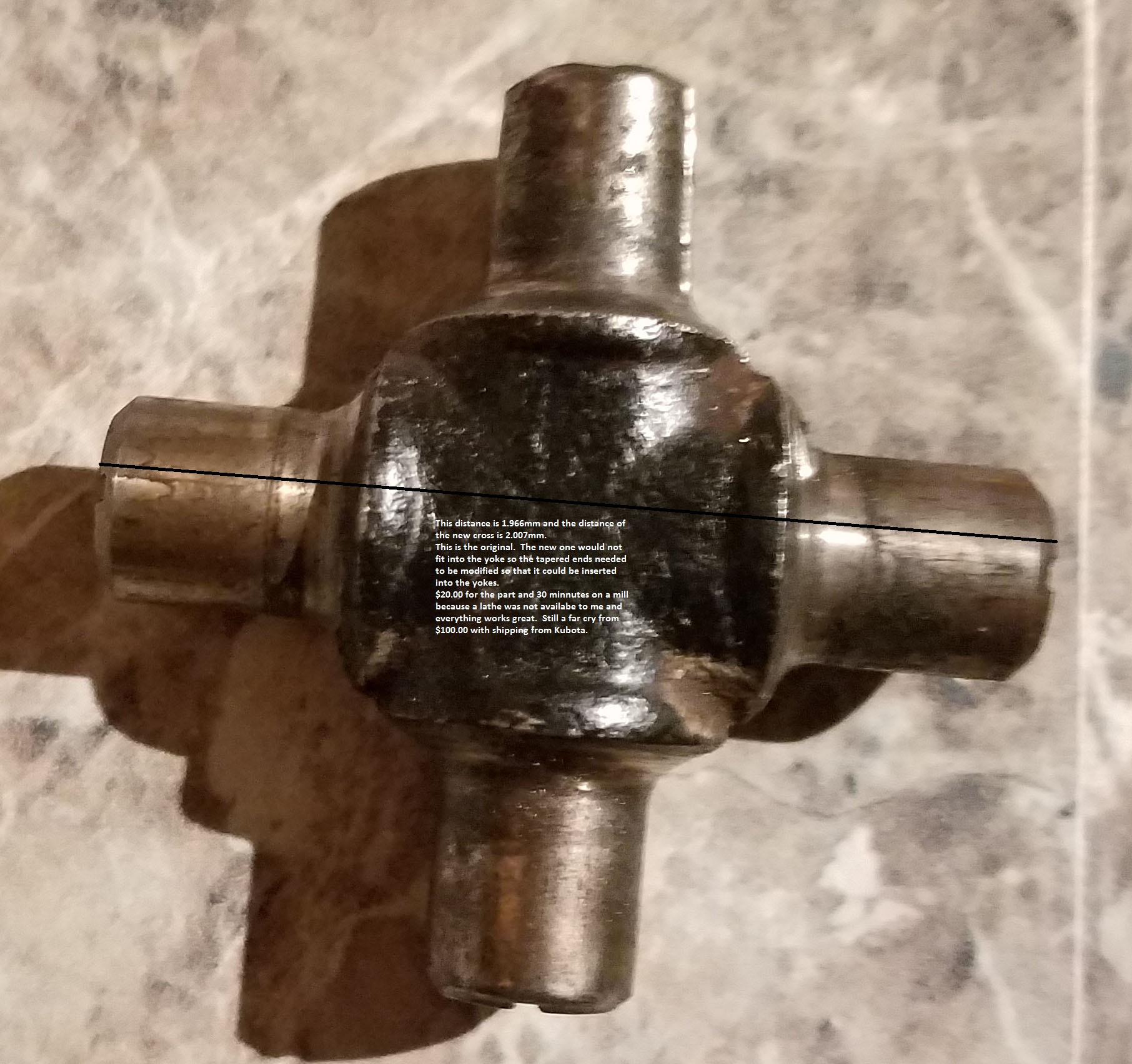

/ BX2200 Front U-Joints
The purchased u-joint cross was 2.007mm in length and the original u-joint cross was 1.966mm.
I could not fit the cross part of the new u-joint into the yoke as the ends were too long.
I used a Bridgeport Mill and shaved off 0.5mm on each of the ends of the u-joint cross.
The Caps had to be pushed a little farther into the yoke so that the C-clips could be inserted properly.
I've used the tractor several times since this operation and it works great!
CD
#13
No, Milling of the end caps would not change the fact that the cross would not fit into the yokes.
#14
Here is the original cross of the original u-joint.
What is shown is the measurement distance that needed to be modified on the new one to make it fit into the yoke properly.
Everything works great. Been out plowing snow several times since the install with no noises or issues at all. We'll see what happens during the summer with mowing on the hills.
/ BX2200 Front U-Joints #15
Thanks for posting the picture and agree the slight modification was worth the $80 delta.
Are those measurements off by a decimal point? 1.9mm is about an 1/8 of an inch. That would make them 1.966 centimeters instead.
