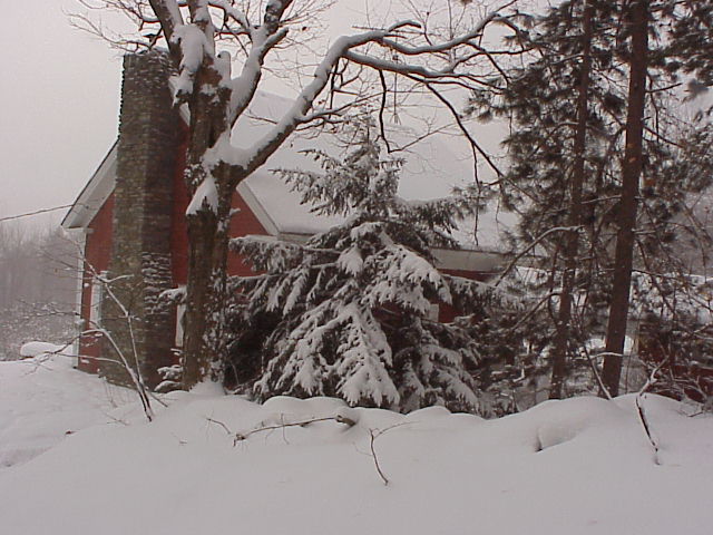

/ BX2200 and winter use #5
Kaz -- I'll echo the sentiment that a LOT depends on your conditions. Someone who gets the occasional dump of wet snow has far different needs than my homestead, which might see rain changing to four feet of snow, and temps from mid-30s to minus 20 in a week. Also, you mentioned a slope but didn't really give an indication of how steep it is.
I started off with a B1750 and unloaded turfs using the rear blade (facing forward or backward as conditions warranted) and FEL. I found it absolutely unable to keep up with the snow load, and the tires had zero traction going up the slightest incline. In fact, it reached the point where it could not even make it back into the garage from the driveway...a vertical rise of about six inches over a twenty foot approach! But we're talking frozen ground and snow packed down into tread-marked ice.
So, like the previous poster, I'd really like more info about your climate and conditions before giving a reasoned response. And, by the way, this is a great search topic as it has been covered in length over the years.

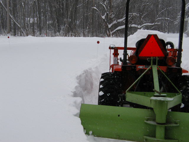

/ BX2200 and winter use #7
u don't mention what amt of snow u get. for a few in. rear blade is fine, but for any amt of snow u need something else. Fel, blower etc. don't think u want to try and move this snow with a rear blade
Frank,
With that much snow I think I just go back to bed and call in sick at work! This past winter our area of Ohio got close to 40 inches of snow in a matter of 3 days. The farmer behind my property brought over his John Deere (don't know what model, but it had 6 huge tires) and he plowed me out but with a lot of difficulty.
Mike (KAZ)
