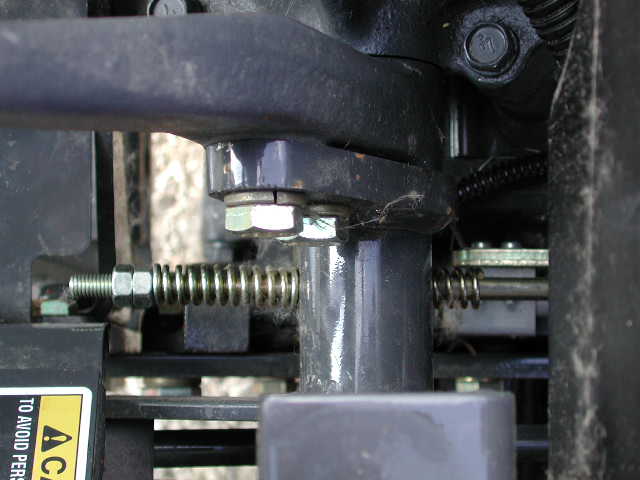

I just got a new Kubota BX2200.
Can you tell me how your 3-pt hitch operation lever functions.
The manual says when you set it to raise or lower it automatically returns to the neutral position.
When I raise it, once it gets to the top it releases and the lever returns past neutral and lowers the impletements again.
   / BX2200 3-PT raising lowering Problem #2
There is a spring on the rod with a lock collar and a set screw attached to the lever--it is likely that this collar is pushed in to far agaisnt the spring resulting in the bounce back you mention. It is a minor adjustment, loosen the set screw and allow the spring to relax, even some slop.
Stop--do not return your tractor because of this--it is a minor adjustment--if you do not see it in the manual have your dealer make the adjustment and you watch so next time you can do it. J
I see what you are talkiing about, but there already is slack in the spring.
I've had the dealer make this adjustment and still no luck.
He said he is contacting the distributor any other suggestions would be appreciated.

My new, on Wednesday, BX2200 has the same problem. It is a pain. I also looked at the spring tension and it seems to be fairly loose in the nutral position. I am calling the dealer today and will let you know how it turns out.

Both of you guys need to loosen that collar I told you about and then raise the three point and then set it. J
   / BX2200 3-PT raising lowering Problem #9
Quess what you were right.
It was so simple I am embarrassed for the dealer, who's ear I am going to bend about this.
I am Attaching a picture of the evil little spring.
