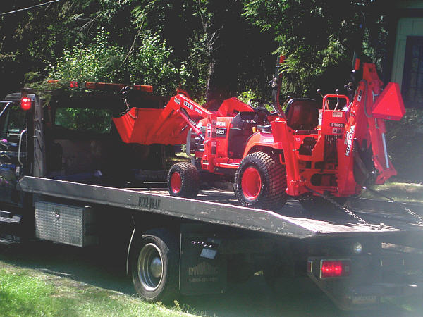

I have my BX22 a week now. Took the backhoe off yesterday and put on the Brush hog. Checked the transmission fluid and it was on the low line. when I raised the 3 pt hitch I saw fluid squirt out of the tractor's outlet hose that I hooked into the return pipe coupler. Will call the dealer on Monday. I am hoping it is only a bad hose. Anyone else have this problem. Have 20 hrs on the machine. rehooked the hydraulic lines to the backhoe. It's not the hose the connection on my tractor has the leak

Just had my BX22 serviced to replace the hydraulic connector on the right side of the machine under the seat for the backhoe. Same exact problem you mentioned. Takes 10 minutes to fix. O ring in the female connector was bad. The tech said if it happens again they'll upgrade the connectors to the stronger ones used on the front loader.

It is real easy to pinch the hose that goes to the backhoe while installing it on the tractor. It might be leaking from a break in the middle of the hose.

It was the female connector. The dealer replaced it in a few minutes. He said he has never seen this problem before on the BX22 must have just been some bad parts. Hopefully it won't happen again.
