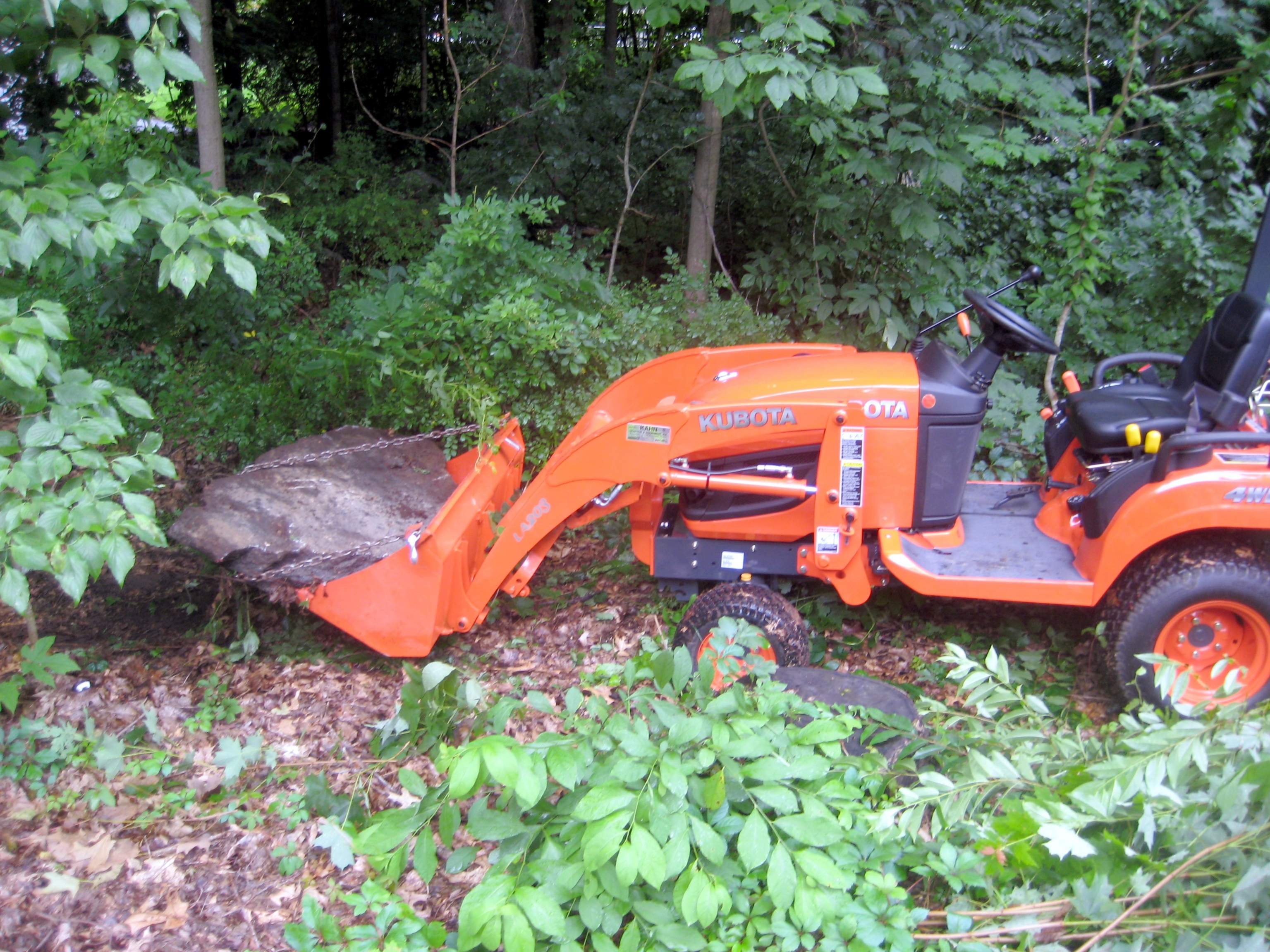

Yes, I had a BX1860 for 2.5 years before trading up to a BX25 to get the backhoe, not because I needed more hp. Moved plenty of stone, dirt and snow with the FEL, and built some stone walls with it.
BP basically nailed it on the deciding factor being heavy PTO demanding implements like a chipper, generator or brush hog, though I ran a DR PTO chipper on mine with good results. I had the 54" mower and it ran it fine. I would bet the 1860 could run the 60" mower too, but for marketing reasons and perhaps it not fitting between the slightly smaller wheel base of the 1860, Kubota doesn't offer it. So, basically, if you don't have plans for rear PTO implements that require a given hp beyond what the BX1860 puts out, it will work fine for you and be miles ahead of your cub 1046. Mind you the BX1860 will run a rototiller or brush hog, just a little smaller size. Kubota does offers Landpride versions of each for the BX1860, just a little smaller.
