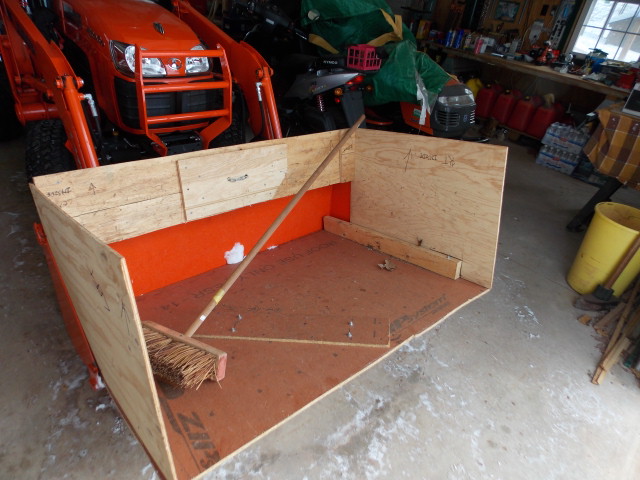

Looking for ideas here...
I've have a BX1860 for 3 years now and my only complaint is the volumetric capacity of the FEL. The sizing of the FEL is such that I can pick up and safely move a full load of 3/4" gravel, no problem (of course the little BX has to be appropriately ballasted at the rear...).
However, I am less often moving loose stone, and much more often moving fairly dry mulch and yard debris (sticks, leaves, etc). And for this reason, I would like some ideas on a bigger bucket for moving loose material such as mulch. Now, you are thinking, "what a PITA, changing the bucket to move one sort of material...". But, if you have ever moved 20 cubic yards of mulch with a BX (0.20 cubic yard capacity bucket) you would know what the problem is here.

I know that BXpanded makes a "bucket extender" but are there other options I should be looking at? I really need a fairly lightweight, 60" wide, deep, "loose material handling" bucket suitable for a few hundred pounds of mulch. I promise not to pick up 500 pounds of 3/4" stone with it.

Wrooster,
I built this thing out of some scrap plywood to expand the capacity of the bucket on my B3030. It's great for light duty stuff, like leaves and firewood.

   / BX1860: Increasing FEL capacity? (by volume, not weight) #5
Well- what do you want it made with ? steel or wood? With wood - you can built it and see if it works for you. If it doesnt, you always can hack it and rebuild it as needed. With steel - you are limited to with what cost and what you have on hand.
