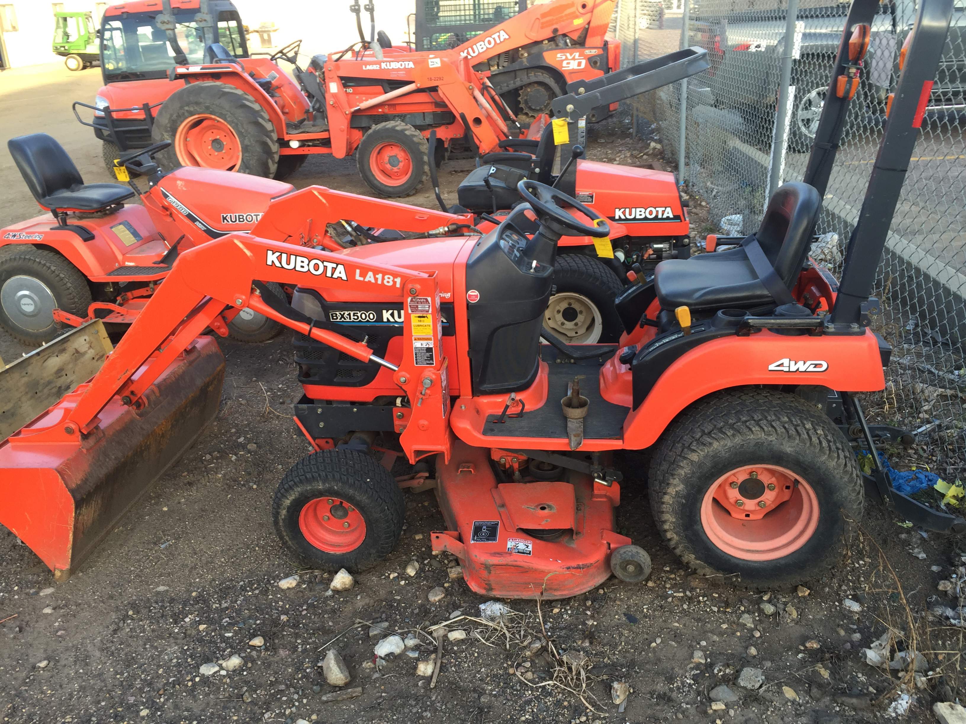

I finally bought a tractor! Just want some feedback. You know, re-assure me I bought a good tractor for a reasonable price. :))
Two weekends ago I saw it sitting in the back of the dealers lot with the trade-in tag on it. I got excited because I rarely see a used BX for sale even at the dealership. So Monday, I called them to find out about it. He said they hadn't even checked it out yet, but would likely be re-selling it. The only other BX I had seen was a 2360 that sat in their lot for 3-months priced at $10500. He told me that they'd likely be wanting about $7700. I told him I'd likely want to check it out even at that price. He said ok I'll get my mechanic to check it out.
Dealer got back to me a few days later. He said they thought it was mechanically good but needed some cosmetic/minor repairs. I asked if I did some of my own service, like fluid and filter changes, blade sharpen, if they would come down a bit. He checked with mechanic or someone and called me back a day later saying I could have it for $6800. I told him I'd come look at it. I started it up. Drove around the parking lot, played with the loader and engaged the mower. Other than the obvious cosmetic issues I could plainly see, it seemed good for a used machine. Actually the only Kubota I'd ever driven. It looked like it was definitely used, not babied, probably not stored indoors.
I decided to go for it. Add $400 tax, I wrote him a check for $7208. I talked him into including fuel filters, air filter, and oil filter.
Some issues I've noticed so far after having it for a couple days, are:
1) Some dings and scratches in the paint
2) Appears to have normal wear on the deck, although they had a spindle out when I first saw it.
3) Bucket wear on the front lip, is about 1/2"
4) There is sun fading and weathering on the dash and seat, small tear in seat
5) The blades look like someone has been trying to mow rocks, very dull, lots of dings
6) Sure rattles and even has a bit of a knock when running
7) Doesn't shutoff when I get off the seat -- assume the previous owner defeated the safety switch -- How bad is this?
8) Also the second time I shut-off the tractor, it did not quit. It did not stop with the ignition switch! -- This scared me a bit. I didn't know what to do. Thankfully we had the screen off, and when my BIL wiggled the fuse box it cut out momentarily, he pushed it down and it then stopped.
9) 2-missing deck guide wheels with one bracket bent quite a bit.
10) There is a 3-position toggle previous owner put on the dash, not sure what that does
11) I don't know if my lights work. -- How do I turn them on? :)
12) Battery looks old and has corrosion gunk on it.
13) Front left wheel has a thick coating of grease on the downward shaft. -- Front axle seal leak? Just zirk grease?
14) It couldn't climb my lawn hill without mower running, in high range, throttled up, it just stopped moving. -- HST bad?
15) The knob height adjustment for deck/3 pt hitch will not turn -- Need to be able to adjust!
16) The knob speed adjustment for 3 pt hitch does not turn. -- Is this a big issue?
The ones that have me most concerned are
1) Not shutting off with the switch. I have a toddler and is a scary safety issue to me. With a diesel, I understand that you have to cut the fuel not the spark. I didn't know what to do short of letting it run out of fuel! Would be bad in an emergency situation!
2) Not being able to climb my hill. I bought a heavy-duty tractor with 4wd because of the steep hills I have to mow and the water way that I have to cross and maintain. I don't want to deal with a bad HST. I imagine that would be very expensive.
3) The possible hydraulic leak on front-end? I really don't want to tear into an axle. Is it mechanical or hydrostatic?
4) The deck height adjustment knob. It is set quite low. I'd need to be able to adjust.
I'm happy to share pictures of the issues, maybe will start a new thread for each item in the owner/operating forum.
Should I return it and get my money back? How serious are these issues? Any thoughts will be appreciated!

Well, congratulations! You either got a good deal on a tough little tractor with lots of life left, or you have signed up for some interesting fixit projects for the next several months. Maybe both. I've owned a BX for ten years now and it has been very reliable and low maintenance. I've added some comments to your narrative:
Check for wear in the spindles. The deck has grease fittings on its mechanism and is meant to be lubed every 10 hours or operation or so. Many inexperienced owners neglect this and wear out the bearings.
Is it bent? If the wear suggests heavy use, check how much play exists in the lift and curl linkages, which also should be lubed regularly to prevent excessive wear. Mine has been properly lubed but has still developed a bit of play. Excess play means it's time to replace the pin-on sleeves, not a big deal.
Invest in a set of new blades!
Diesels are like that,of course, within limits. Keep in mind the BX engine is made to operate at 1/2 or wide-open throttle. Putt-putting around at near idle is hard on a diesel engine and the BX also needs to be revved for the hydraulics to generate enough flow for things to work. All that having been said, has the thing been serviced recently? Oil, hydraulic fluid, all filters, lube, etc. Neglect may be more than on the surface.
Pretty common, not the worst thing to ever happen, IMHO. Depends on who will be using it and where it will operate.
Sounds like the fuel shutoff circuit has an issue. Should be a straightforward fix.
Got a nearby welding shop?
Should be a rocker switch left of the steering wheel, I think.
Front axle assembly is filled with gear oil or Kubota hydraulic fluid. Couple of filler holes with threaded bolt on the top of the axle, left and right. Check fluid level.
Climb hills in low range. Depending on the hill, there's little power in high range. HST should be able to spin the tires in the dirt in low range if you try to pull/push an immovable object. If it can't do this there may be a problem. Previous comments about changing fluid and filters also apply to HST. If never done in 550 hours of use, it's long overdue.
Find where it goes beneath the floor and begin lubing with your favorite penetrating oil. Odds are it's just frozen in place from lack of use.
See 15)
With any luck, you've picked up a tractor that has just been worked hard and not maintained, but can be made healthy with a little TLC. Let us know how you're doing with it, and questions are always welcome. Good luck!

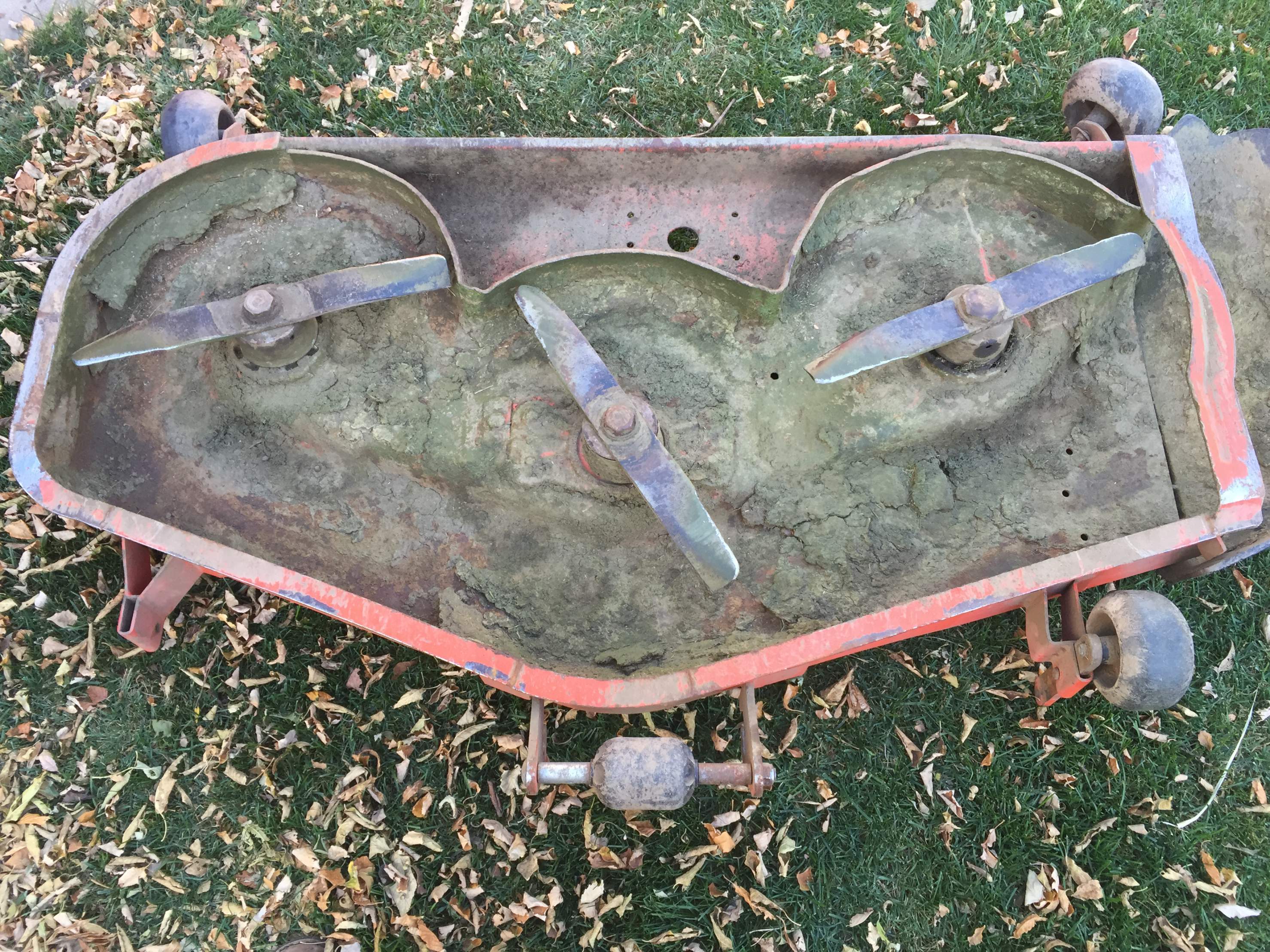

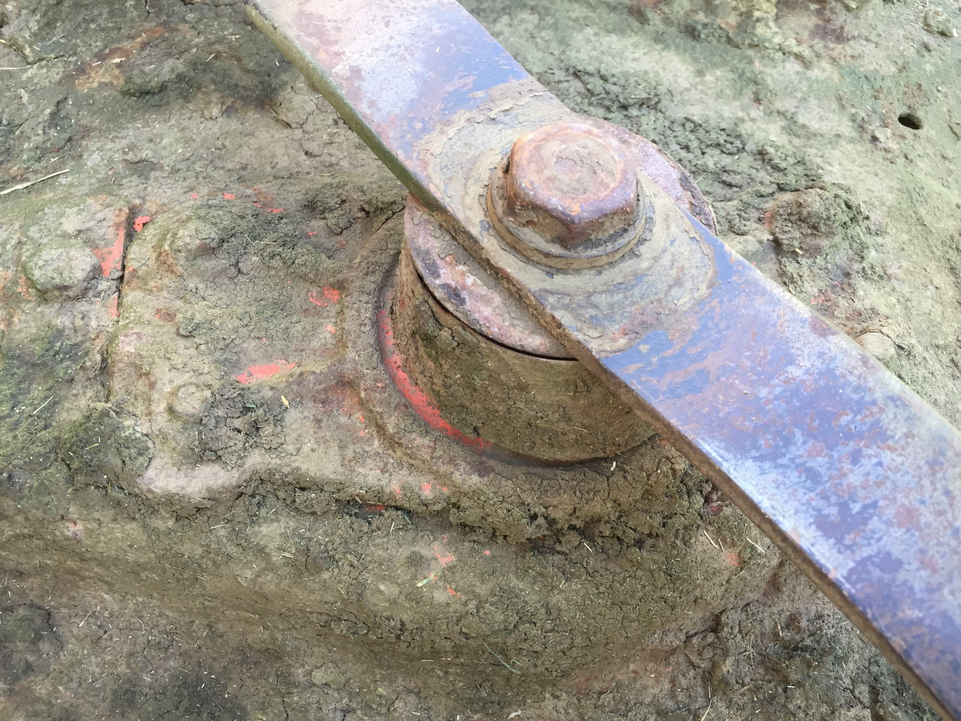

6) The mower deck is kind of a mess. It hadn't been cleaned in a long time. I noticed mismatched bolts on the blades and the cups don't look solid on all of them. One cup is definitely split, is this serious?
Speaking of blades I could not break 2 of the bolts free. They are also soaking in penetrating oil overnight. Other than an air-wrench, any tips on how to break blade bolts free? (deck pic attached).

A 1/2" air impact driver would be the best/safest way to remove them. If you don't have one then take a torch and apply heat to the head of the bolt. That should break the rust. Take a breaker bar and a hammer to it.
Once you get it off use a little "antisieze" on the bolt before putting the blades back on.
Blade bolts are hard to get loose. May need heat. Be careful about just using a breaker bar and muscling them loose as you can snap the head off the bolt and then you'll have all kinds of fun getting the rest of the bolt out. Don't ask me how I know this. :mur: In hindsight, replacing the blade bolts and re-tapping the threads when installing new blades is probably worth doing. Also replacing the cup at the same time so it doesn't fly apart someday while you're mowing.

If you don't have access to an air wrench and have a breaker bar, place a piece of wood between the blade tip and the deck wall to hold the blade while you loosen or tighten the spindle bolt.

On that mower deck and blades...ugh!
I did have a 2x4 wedged in to stop blade from turning. Upgraded to a 4x4 this afternoon. Its more stable.
I tried a big pipe wrench. I know, I know, not the proper tool. I do have a 1/2 breaker bar, but my sockets stop at 27mm and 1.25". The 1.25 was close but too loose to really hammer on the bar. I went out this afternoon and bought a 30mm socket.
I've had it upside down, sideways, nearly standing on the bar, beating it with a hammer, kicking, small impact wrench. Didn't move a bit. The blade looked like it was bending instead of loosening the bolt. I've held the deck with my hands while sitting on the ground and pushing the breaker bar with my foot. The breaker bar looked like it could snap at the knuckle.
Tomorrow I'm going to get out the propane torch and make that bolt glow! Well within reason. I'm worried I could heat the bolt too much and cause damage to a spindle bearing?
Then I'm going to go buy an air compressor. I do have an air wrench. My air compressor was stolen a couple years ago and I didn't have a need. Now that we have a property and things to work on, it is aggravating not to have those tools I grew up with.
If I still had a pickup and I'd haul this dang deck back to the dealer to have them loosen the stupid bolts!

I did give it another soak with PB blaster(?). Then this morning I put the torch to them. There was no chance of glowing red with my little propane torch. I don't have a MAP. I rarely use a torch. I guess things may change with a tractor?
I wonder if using a hotter flame is better and safer for surrounding parts as you can heat just that bolt much quicker where it the little propane torch I had to sit there for 5-10 minutes each before I felt it was good and hot.
Gave each bolt a couple good whacks with my biggest ball peen hammer. Since I'm out of that computer cleaner freeze spray, I sprayed some carb cleaner on the bolt as a quick chiller. Not sure how well it worked but made me feel like it was something. hahaha. Then whacked them a couple more times.
I stood the deck up near vertical, leaning the basketball hoop pole, wedged a couple 2x4's to keep from sliding away. Then put the socked and breaker bar on the bolt parallel to he ground, grabbed the pole and stood on the breaker bar and bounced a couple times and finally it broke free. Same technique for the second one, it also broke free. All the blades are finally off and at the shop for sharpening. Hallelujah! :dance1:
Good tip on re-greasing! Will do that. Now have to find that grease gun. We moved not that long ago and unpacking as I need things for the most part.
