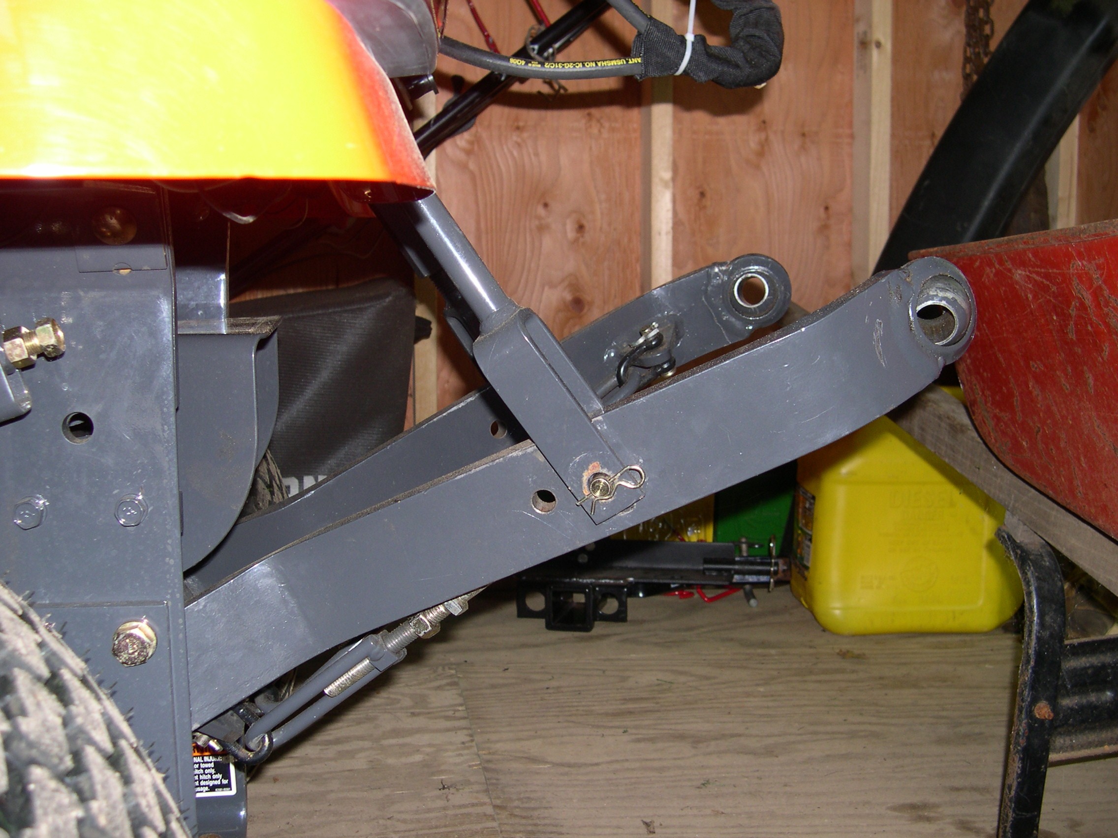

This conversation made me look, first thing, yesterday at the lower 3 pt arms. Yup, two sets of holes.
   / BX Sold, Time For B2320 #52
Sorry for the confusion. The smaller JD's, etc. have the extra holes in the vertical links, but the Kubota has the extra hole in the lower lift arm. Same result, different way of doing things. I don't think the BX has the extra holes.
   / BX Sold, Time For B2320 #53
Mind does :D $15 in machine shop time bought me a second set of holes about 1.5" closer in. Thinking about it, the JD solution might be better since it doesn't move the lift point closer in thus lowering the amount of weight the 3PH will pick up.
