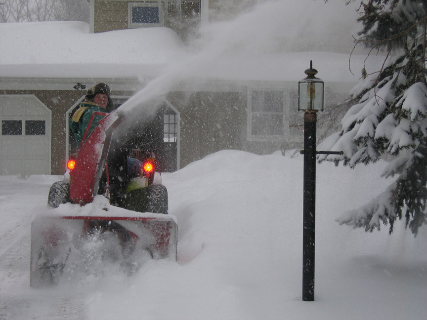

IMHO there's no torque difference between the rear and the mid PTO at the end (I mean after the gearbox mounted on the snowblower). The gearbox for a front snowblower reduce the speed. The point is, they both turn at the same speed (if not, a front one would throw a light snow 200' away but would bug down with heavy wet snow).
About the width, I have a 64" mounted on my B3030. It was mounted on my BX23 before I swapped tractors. It was ok mainly because the BX23 had an hydrostatic transmission (meaning: you go slower, that's all). If you plan to break the fastest snow removal world record I'd recommend something smaller though. But it was very fonctionnal and if I had to do it again I would do it without any hesitation. The situation is the same with my B3030, when there's a 18" snowfall I don't back up as fast as if there was only 6" (dry or wet snow is the same logic).
Two pics: B3030 and BX23... same snowblower.
