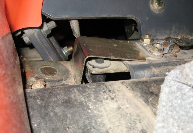

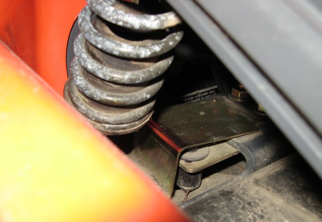

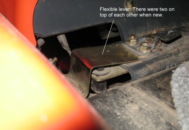

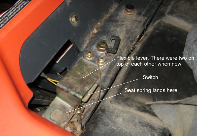

Pictures this time...
Again, the lever was doubled-up - one right on top of the other, and only connected by the two mounting bolts.
I wonder if the Kubota folk used multiple lever/springs as a means of calibration? Though that doesn't make sense either, as that would imply that only one lever, with a heavy operator, would result in a different problem. Otherwise, they'd only use one lever for everyone(?)
Jesse

I removed mine about a year ago. Haven't had any problems except on really uneven ground. Removing one of the plates is a easy fix.
/ BX Seat Safety Switch #9
I did the same mod to my 2350 a couple of years ago. The engine now runs and kills when I think it should.

I have a BX2350, I'll have to try it. I'm a big guy and I still have problems with it killing now and then. Thanks for the pics, that really helped.
