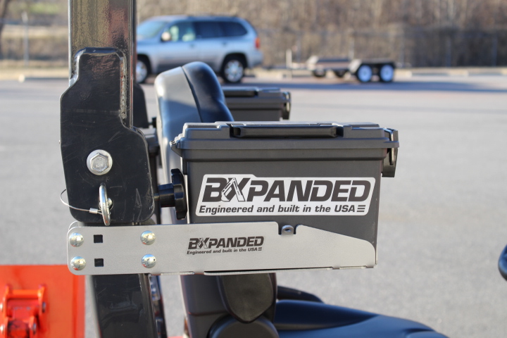

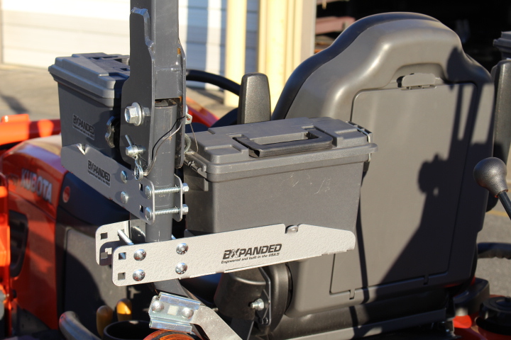

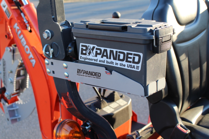

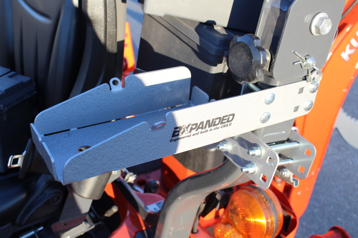

How about this one? Fits almost any size ROPS. Mounts inside, outside, cross tractor. Left side version, right side version available. Water resistant "ammo can" pops out and lets you interchange another box with tools you need for a different task.
Available now. Email us contact@bxpanded.com for specifics and details.
Looks like a decent solution at a decent price. I'm already locked in on a Kubota one though.

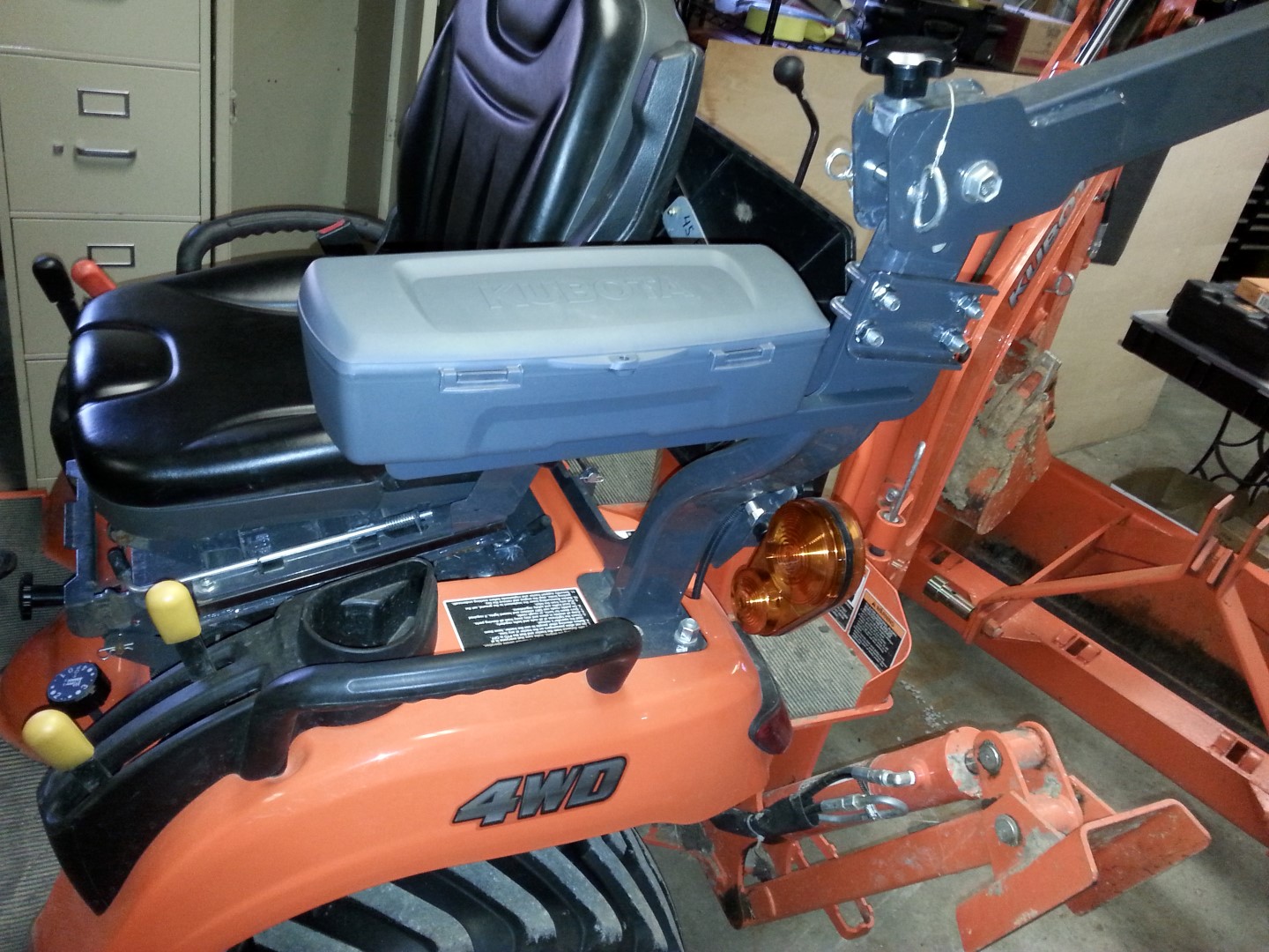

Here is the tool box I made.
/ BX Optional Toolbox? Anyone have one? #31
I like it! Unfortunately my BX has the brake on the left side so that won't fit so well. I'm looking at fabbing a simple box to mount on the FEL tower.
