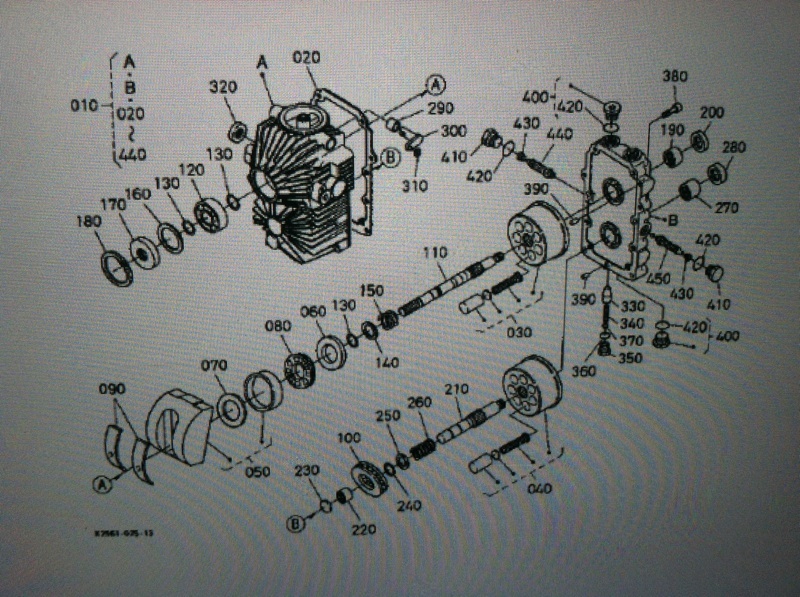

Its a good leak not just seeping , its a steady stream . it has almost 1600 hours on it. All it ever did was mow before i got it . i put the 3 point hitch and front end loader on it. i have the tractor tore down in the back and its not what i installed for the loader its coming down the pass side of the hydro pump area in front of the rear trans axle .Thanks jason
   / BX Hydrostatic seal leak #6
seems to be leaking around 320 or 20 area in the pic .
   / BX Hydrostatic seal leak #7
My BX24 was leaking around the shaft where 120 130 are. Hydrostatic input shaft. $960 with driveshaft boots replaced at the same time.
