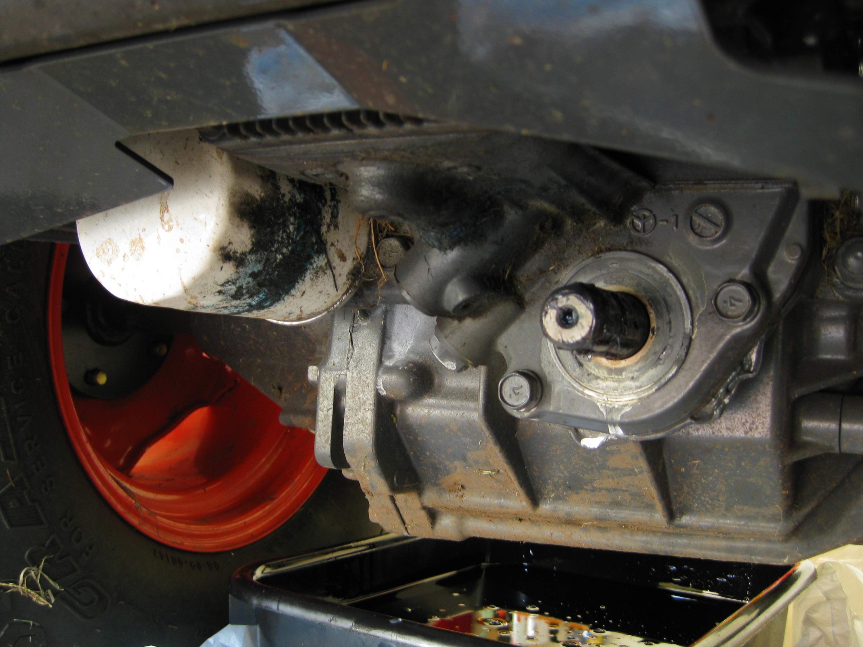

Kubota Oz don't even have 'em in the country . Waited 10 weeks
for mine to show up via the Melbourne shipping container . Then
before leaving the Dealer , I thought I'd open its box ; no bolts/nuts
included !
