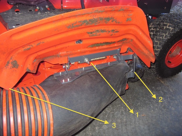

I bought a used grass catcher for my BX22 with 54" MMM and I am not sure if I have the boot attached properly (see pic). It has a mounting bracket that is completely different than what is shown in the manual. Although the boot itself fits my mower deck, I'm not sure if it's mounted properly? 3 issues of concern...
1. There is a bolt at the top which does not align with a hole on the deflector flange.
2. The brack has an extension on the front end which appears to have no purpose.
3. The mower deflector is digging into the shoot.

What model grass catcher do you have gck60-bx or gck60-23bx The later is the newer verions. The bracket looks like the one I have. I believe it fit a rck54-23bx I think you have a rck54-22bx that may be why it looks different.

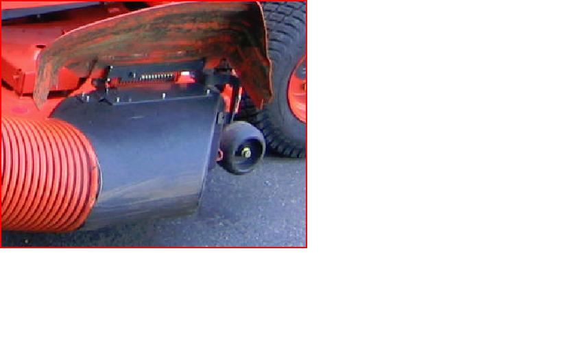

I have the 60" BX mower deck. My boot shape is slightly different than yours. You have more of a taper from the leading edge back to the shoot. The deflector width near the hinge point is about 13 1/2" on mine, the hole is about 9" from the leading edge. Holes on the deflector plate and mounting bracket align on my deck. This keeps the boot located properly to fit over the deck chute exit. Your bolt #1 passes through the top of the deflector and screws into the welded nut below when you mount the slotted adapter to the deflector plate. Your item 2 keeps the front of the boot aligned in place when in the down position. The boot fits over the end of the mower exit chute when properly aligned. The end of the deflector does not touch the shoot on my machine. See the attached photo. Your hardware looks very similar to mine (about 2003 vintage). I can't remember if there was a "heavy duty" version of the boots which is perhaps what I have.

I have the same set-up, works fine, just doesn't match the book.
1. I believe mine will align the thumbscrew into the orange chute hole.
2. Looks almost useful, as hole in metal and hole in plastic align - but why?
3. I keep a rag there now...
It all looks wrong, works fine!
I think some of the extra details will allow it all to work without the orange metal chute - but I didn't want to take it all apart.

I discovered that the boot bracket was assembled incorrectly. It now resides between the two tabs coming off the portion of the bracket that is fixed to the plastic boot. Before, one ear was inside and the other on the outside. Anyway the thumbscrew holes now line up, so I am able to use the thumbscrew to secure the assembly in place. However the deflector still rests on the shoot. I guess it's as good as its going to get at this point.

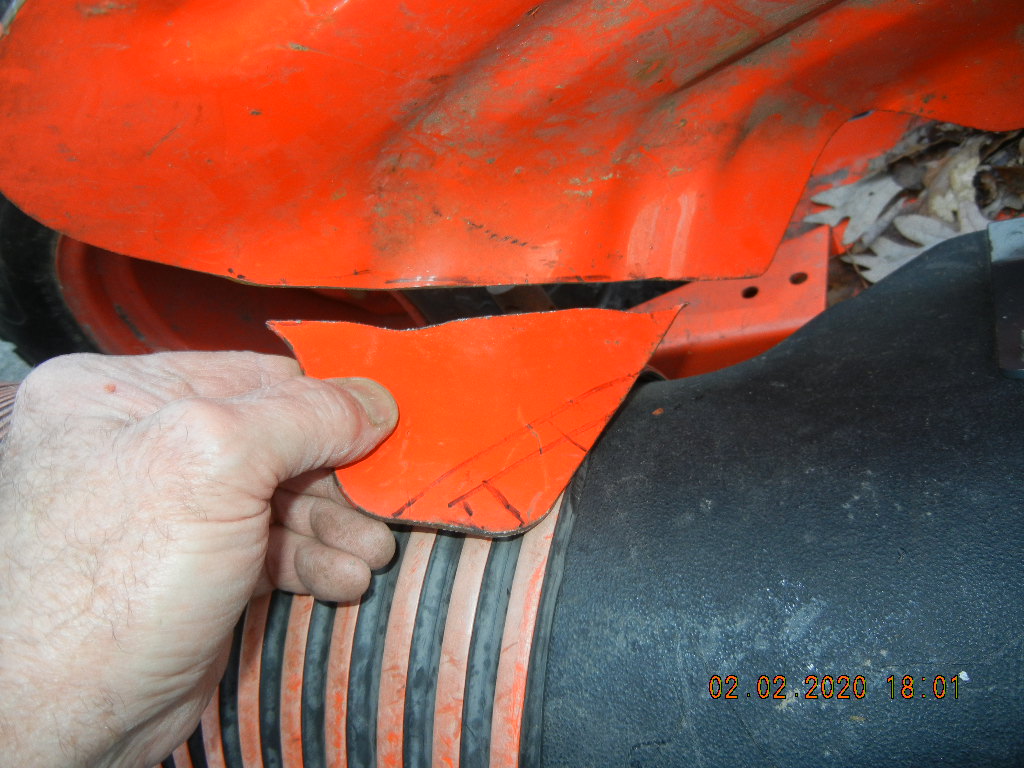

Turns out the flat bar goes in the front - exactly where grass escapes!
Odd bit does bolt to and support the plastic - without it closing becomes a 2 step process, not a bit cleaner than when attached.
With it - I can raise deflector (and boot) with my foot, release it and it goes right back to attached!
I did cut about 3 inches off deflector end, from resting on hose. Looked at various bends, etc and that last 3 inches was cleanest when just gone.
