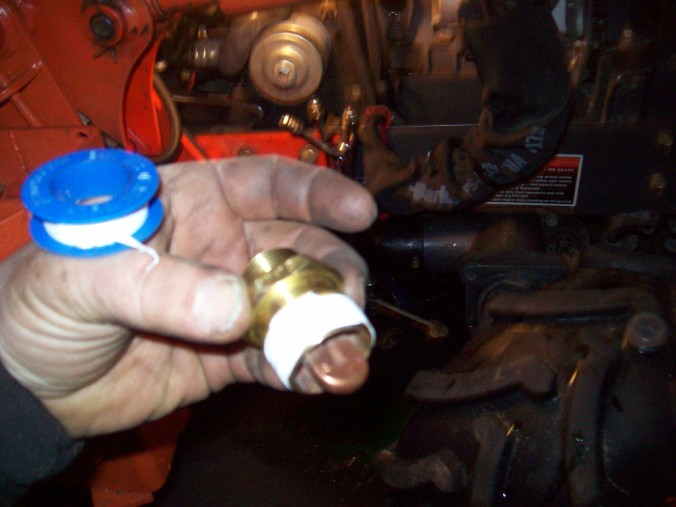

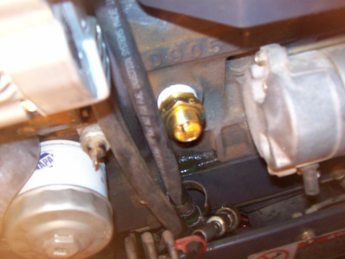

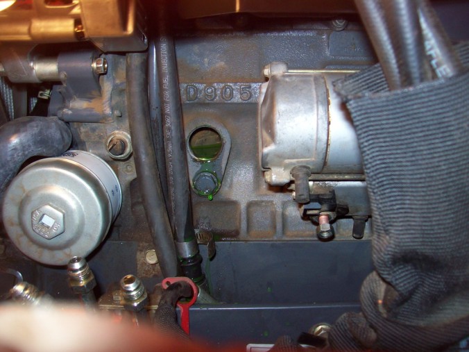

Ithought it was a freeze plug type,nope simply unscrew an allen screw.install block heater.Took me longer to get the camera and take pics then to do it:)You need a large socket [1 3/8 ]and large allen wrench[brain cramp cant remember size]
Ihad the tractor apart replacing the lower water hose,[because i had unsuccessfully tried to fit a hose heater in aplace it wouldnt fit:rolleyes:]so while i had it drained i installed this proper kit.7000073274.Takes about 5 minutes after you got your tools out.Kind of glad i didnt have to knock out a freeze plug.

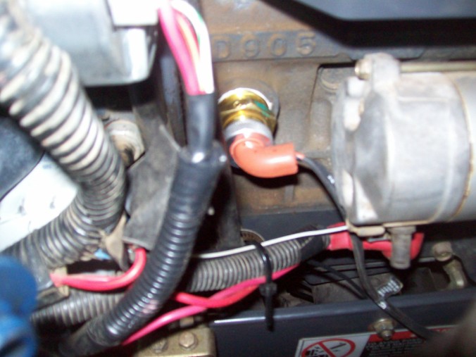

oops didnt get a pic of the plug in hanging from it --will do tommorow
Just push it on and tighten nut with fingers your done.
It's a 17 mm. I know this because I just bought an allen wrench to fit this plug tonight, at Sears. 10 bucks.

Certinaly sounds easier and quicker than the freeze plug type I just installed a few weeks ago in my BX. Doesn't help that when I tried to knock the freeze plug out it didn't twist and fell into the block. That took a good 30 minutes to get out dang nabbit. I think my parents should've called me Murphys-law...
/ bx engine[905e]block heater install #6
Isn't that fun when the freeze plug falls inside the block? :mad: Having learned that lesson the hard way, whenever I have to remove a freeze plug I punch a hole in it first, thread in a self-tapping screw and twist a wire around it. Maybe I'm paranoid ;), but I haven't lost one since. I was happy to find my B7800 has the threaded plug, like Alan's.

HERES THAT PIC I PROMISED. The plug end hangs just below the side panel

Icant remember it having instuctions,but it might have:rolleyes:Just take out the plug and install the new one with tape on it.
AS far as draining it,i had my hose off any way.Ithink all you would lose is the antifreeze in the block,and the bulk of it is in the radiator.Myself id just have a pan under that plug ,and have the heater all taped and ready to sCrew right back in,.
