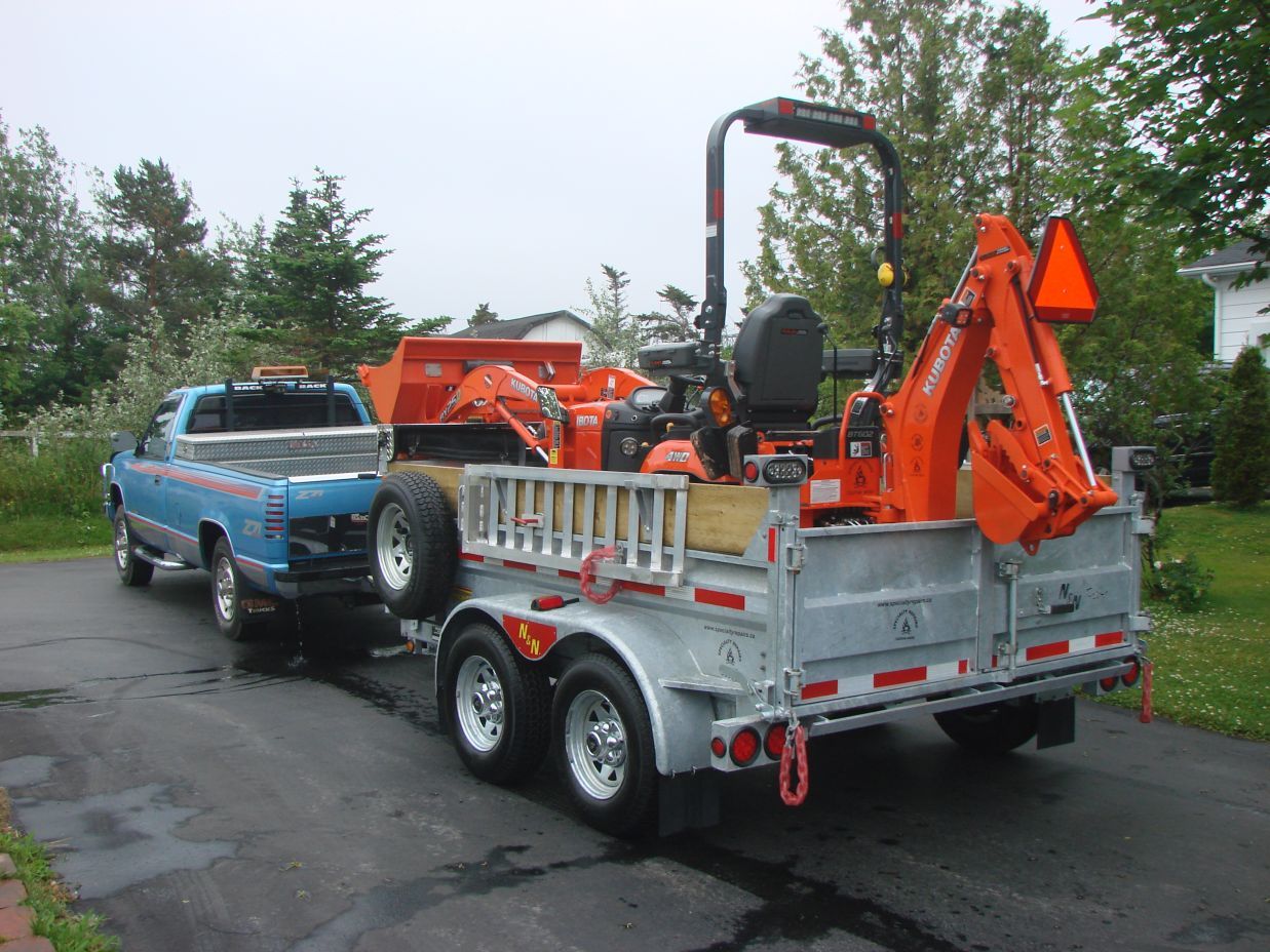

Ive had no issues with a 10' dump trailer and the BX. The truck is only a 1/2 ton so I didn't want to go with a larger trailer.
4Shorts, I,ve seen your BX in that trailer on one of your videos....which I watch regularly. I've been meaning to drop by one day to say hello. Anyway thanks for all the info you share, I've learned a lot about my BX from your channel. Also, I installed a set of ATV tracks on my quad a few days ago and also picked up a few tips from your video on that as well. By the way, the customer you installed those tracks for is a very good friend of mine, in fact we were both for a ride a few days ago.
Anyway back on topic. In your picture, what to you rest the FEL on when travelling.....anything or just locked in place with hydraulic pressure. I am a little concerned about the FEL damaging the tarp kit with it stored like that. What are your thoughts, I would say its ok if you are using it like that. I was thinking maybe getting some sort of resting cradle made up that is welded to the from A arm of the trailer and lowering the FEL in it. Do you think this would be necessary.

Cool. Glad your enjoying our videos and that you get something out of them. I wasn't sure who you were but when I seen your user name I wanted to help out. In the photo there's nothing only hydraulics keeping the FEL up but I plan on making a mod in the next few weeks that I think you'll really like to solve that issue and ease your concerns.

I pull my BX with a 10' SA. Its heavily built (by myself) with 3500lb axles and 4" channel. And in practice its too light to do any serious long distance hauling. Its basically maxed out in the weight department. Id be more comfortable with dual axles and 7000lb.
Length wise, its ok, the BX will fit, barely, but there is no room for moving to adjust cog. 14' would be better. And with a 14' there would be enough room to load the tractor with the loader and a bush hog installed.

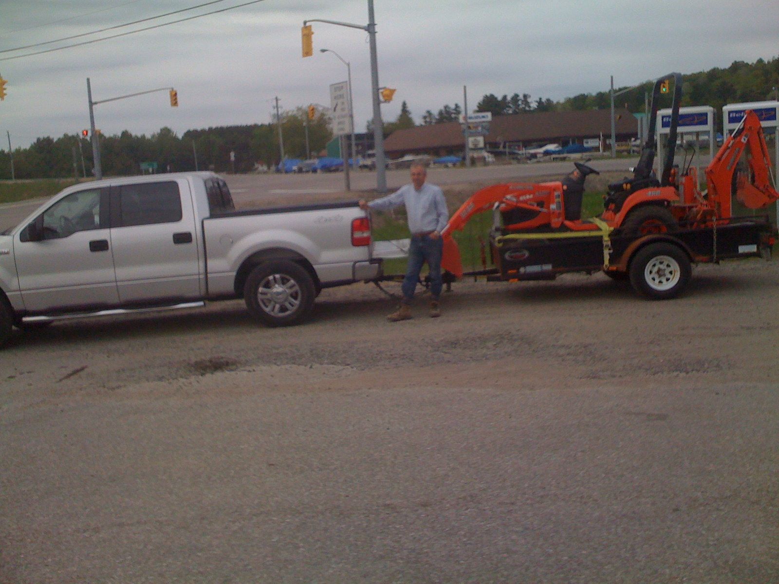

Around here, having the backhoe hanging out of the trailer is a recipe for a State Police stop..Even the bucket sitting on top is pushing it around here. People have been pulled over for far less.
I like having my equipment fully contained within the trailer ergo my 16' tandem. I've put my BX and my RTV on a 14' tandem and wasn't happy with the fit at all.'
That picture of the single axle was beyond belief..I hope that was a "See I Can" but hopefully didn't actually pull.
I have an HD 5x10 and my BX would only ever go on there naked but it never has..My guess is it will never see it. Tractor is too expensive to play those kinds of games and other peoples lives are even more valuable.

Heck, I put my BX 25 on a 5 x 10 trailer, and I upgraded the axle to 3500 pound axle, with electric brakes. The front end loader stuck out over the the front and was held down just behind the front jack, while the backhoe stuck out over the back. Only used it in emergencies, maybe two or three times. Then I got a great deal on a 7000 pound flat deck trailer with a beavertail and lovely ramps. It was an 18 footer, so now I have lots of room for everything. And, with brakes on both axles, it is a lot safer, too.
Even so, if I really had to, I could always take the front end loader off and the backhoe off and put the tractor in the old 5 x 10 if, for example, I wanted to take it in for some service on the main part of the tractor. The tractor itself only weighs about 1500 pounds, so the 5 X 10 would be more than adequate.
I have GOT to stop using that voice recognition software on my iPhone, or edit my posts better. (Edited post above.) Meanwhile, here is a scary photo. Tractor on 5 X 10.jpg (That's not me standing next to it.)
   / BX 25 in 10ft dump trailer?? #36
I have GOT to stop using that voice recognition software on my iPhone, or edit my posts better. (Edited post above.) Meanwhile, here is a scary photo.View attachment 406698 (That's not me standing next to it.)
Why is the ball hitch sooo loooong in that picture??
