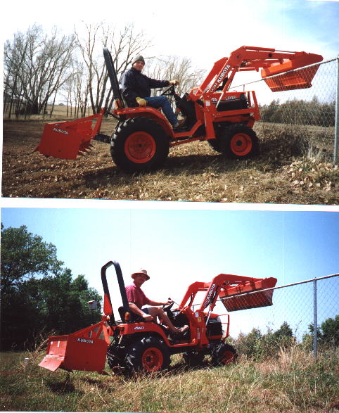

I recommend you get the BX with 60 MMM, FEL and perhaps a rear blade. JD has some new lawn tractors called the X series, X, I imagine because of the X in BX. It is simply my opinion but a better choice if you want a JD would be their new 4010 compact utility, slightly larger than the BX. Despite what some will tell you the BX is a very capable and rugged tractor--I should know--I have both a BX and a B2410 and in some things the little BX is superior or equal to the larger B, especially mowing and manuvering. It is a little slugger for sure. The thing with you is I hate to see you keep trading and loosing money so this time try to get what YOU want and not what I or someone else wants you to get. I suggest also you go and ride them around, kick the tires and light them up. Good luck. J

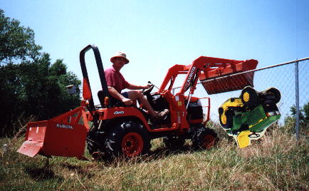

This would have been a good place to show the pic of the Green Machine being dumped over the fence.
I got a real kick out of that./w3tcompact/icons/laugh.gif

Just for you RM, hey everyone--that is not really a JD being tossed over the fence so don't get excited. J
