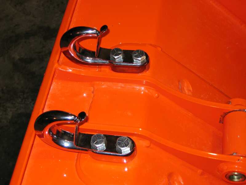

/ BX 22 Bucket Hooks #35
Here is how I did mine. I sometimes use straps rather than chain and these hooks lend themselves better for that. I put on two just to distribute the load a little.
/ BX 22 Bucket Hooks #37
JC Whitney: Item 81SB3477R Chrome Tow Hook Set
Quantity of 1 Total Price:$14.99.
I took a cut off wheel on my die grinder and cut off the excess bolt length, but that still leaves the ny-lock nuts on the inside of the bucket. I don't expect this to be a problem but if it is I will replace them with carriage bolts from the inside.
Hmmm, do carriage bolts come in grade 5 or better?
BTW, the hooks do not touch the front lip by about 1/8".
